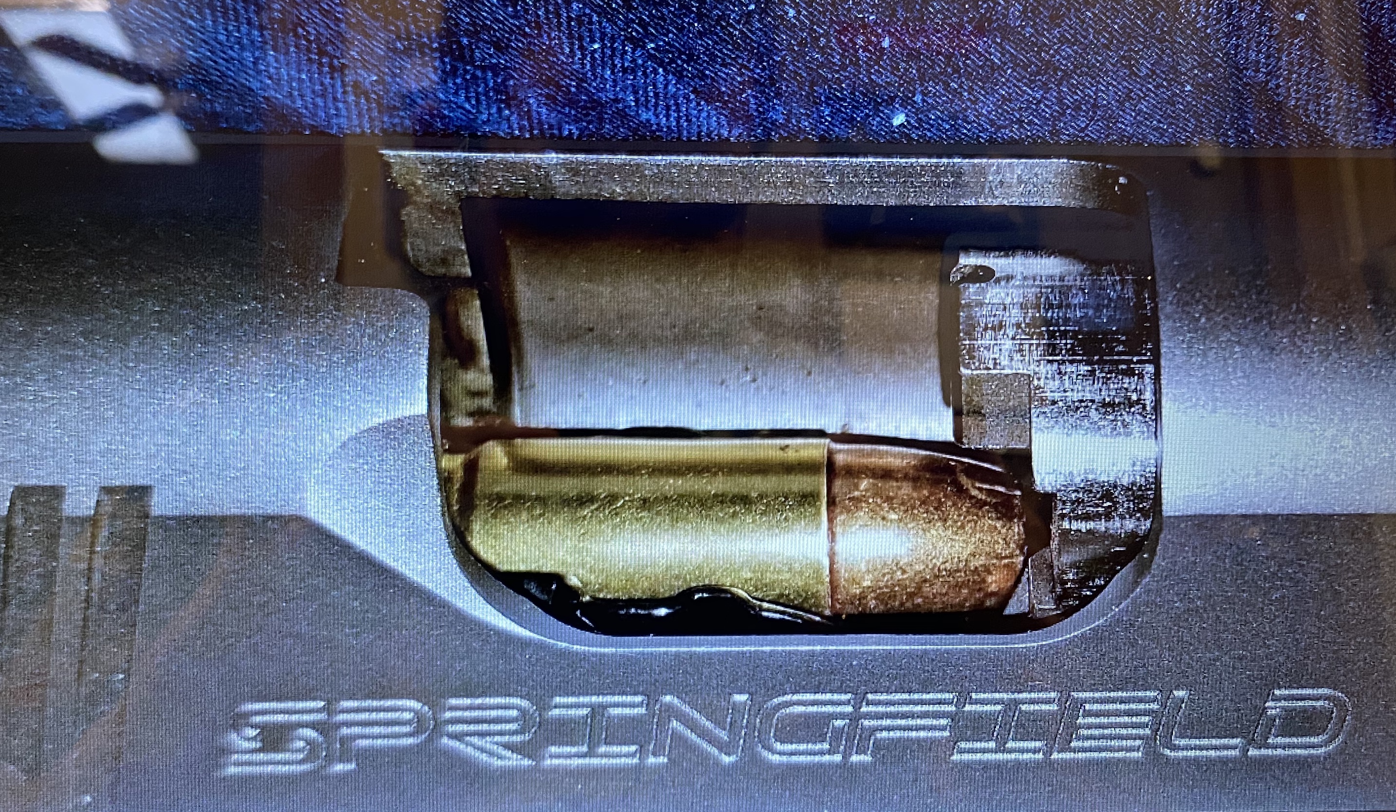

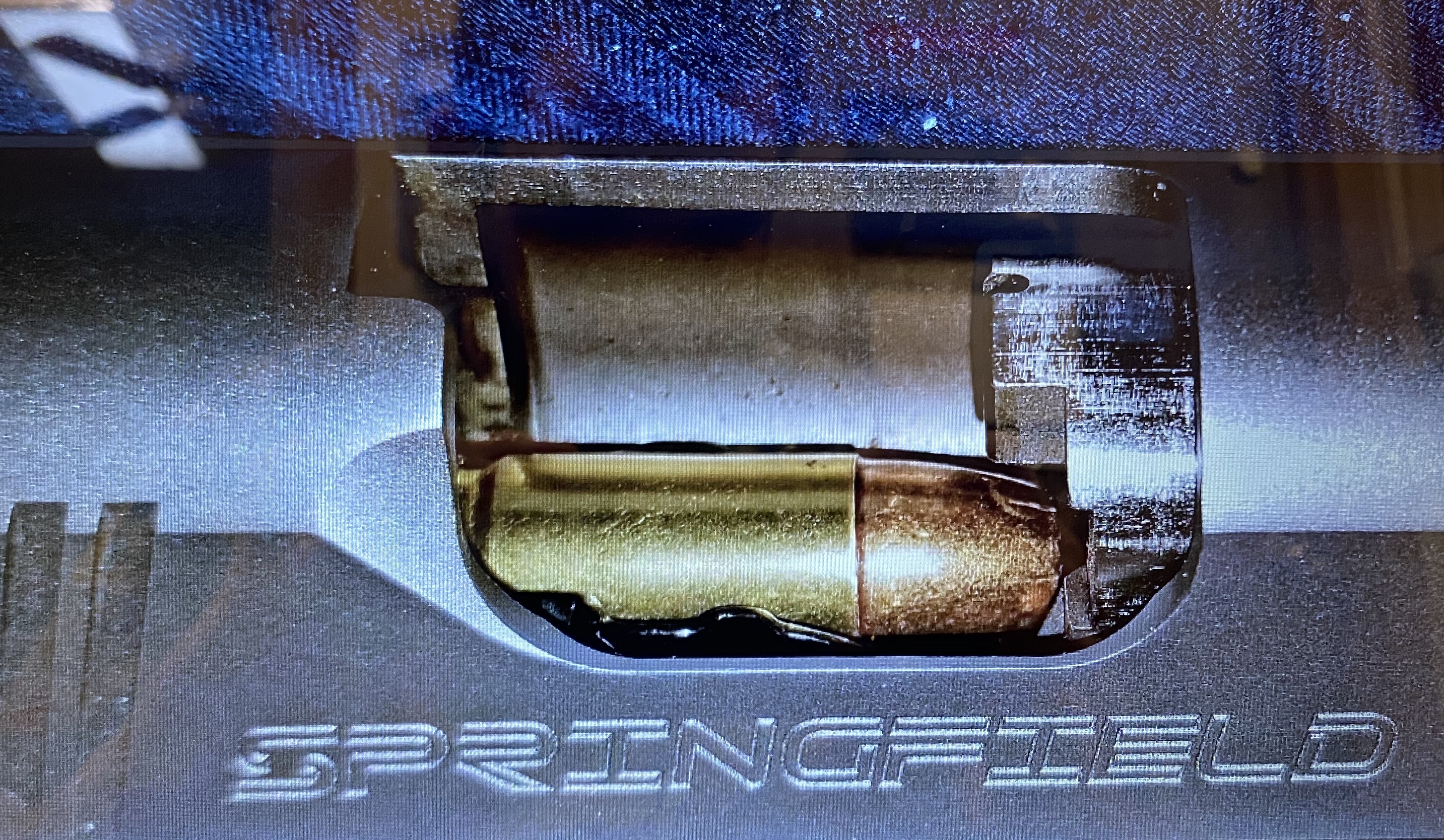

A few month's ago I bought a 1911 EMP® CHAMPION™ CONCEALED CARRY CONTOUR 9MM and because of scheduling issues wasn't able to shoot it until a few month's after. In doing so I had a slide/feed issue after every shot. Took it to the vendor I bought it from, they oiled it up and using their ammo it performed as it should. Now, with the pandemic going on I haven't had a chance to take it to the range again, but I have been cycling the gun as it's my personal protection, in doing so I'm getting very inconsistent feeding with certain ammunition, in some cases even double feeding of the ammo. The ammo that seems to have the issue is 9mm Luger hollow points. Just trying to find out if this an issue with this model?
Links to photos-

From the images provided to me it looks like the mag may not be fully inserted. The round when loaded into the chamber should have a upward canter to it. The flat angle this round has is almost certain to cause a jam. I’ve had this happen to me in the past and was caused by the mag not being fully inserted. Also could be caused by the ammo itself. If the ammo has to blunt of an angle it may cause this issue as well.
The issue is hand cycling.
I’m willing to bet that if you take it to the range and shoot it, it’ll function fine.
When you hand cycle, you are moving it a lot slower and with a lot less force than it does when fired.
The first time at the range I had the slide failing to go forward all the way after each shot. I'm assuming it may be the ammunition being its hollow point. This isn't cheap ammunition, so
From the images provided to me it looks like the mag may not be fully inserted. The round when loaded into the chamber should have a upward canter to it. The flat angle this round has is almost certain to cause a jam. I’ve had this happen to me in the past and was caused by the mag not being fully inserted. Also could be caused by the ammo itself. If the ammo has to blunt of an angle it may cause this issue as well. View attachment 7965
Mag is definitely inserted all the way.

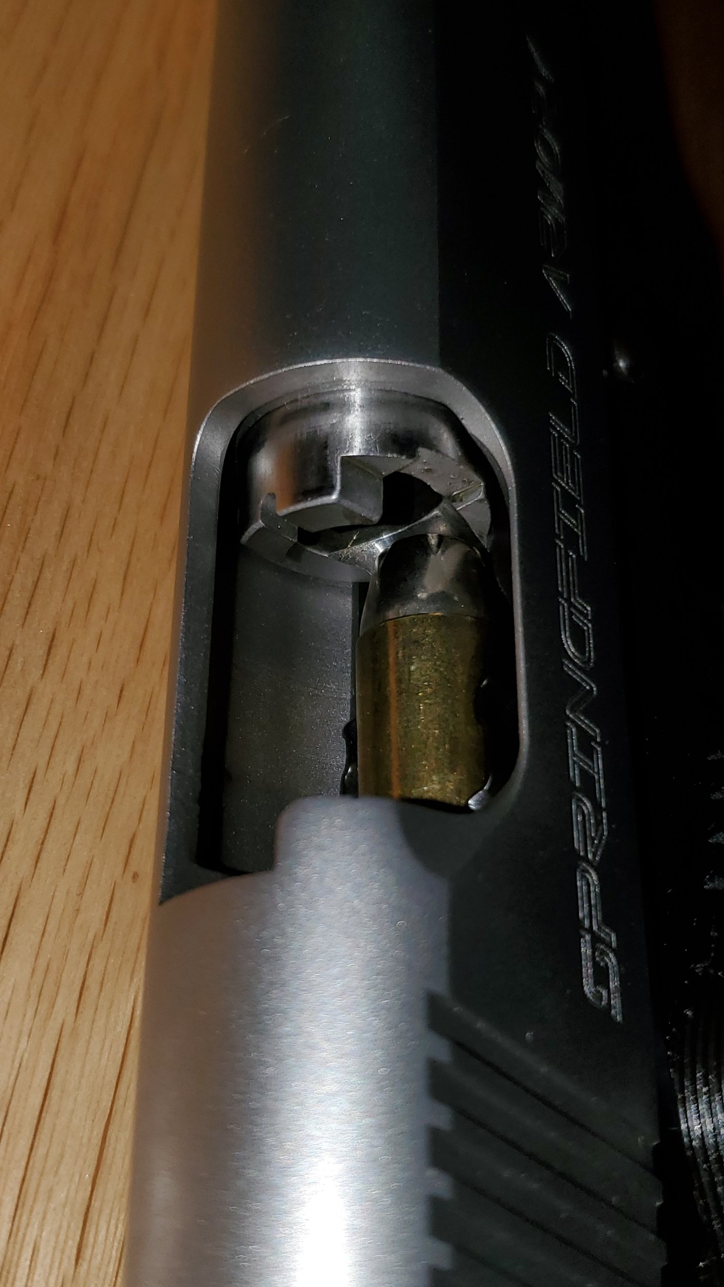

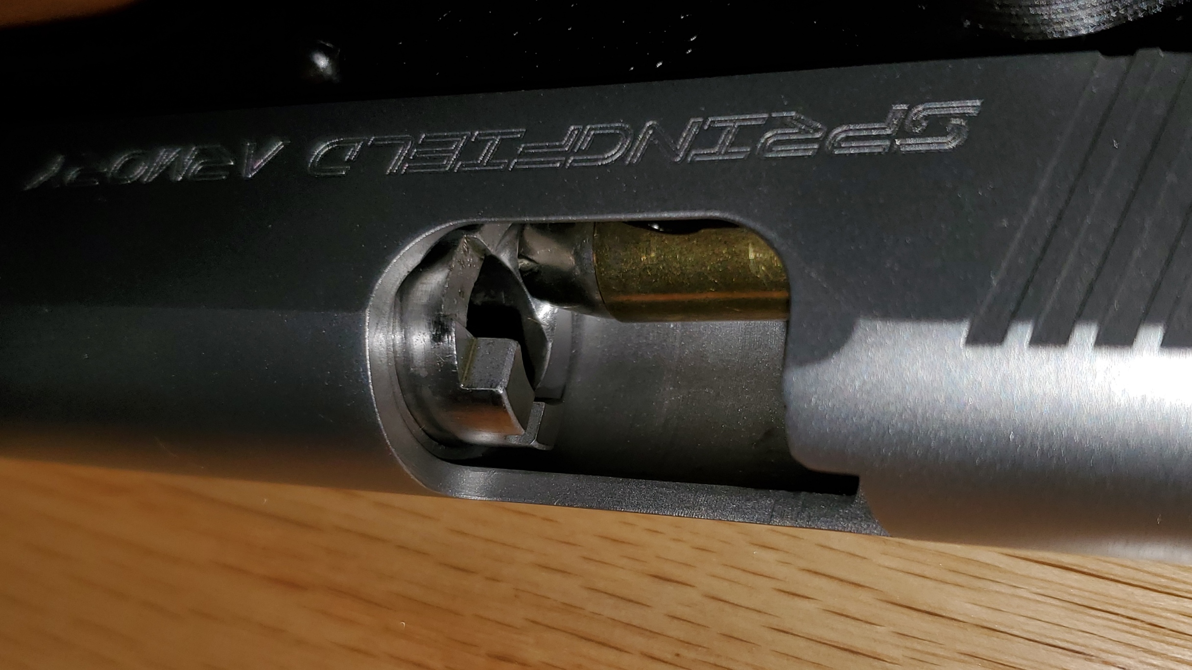

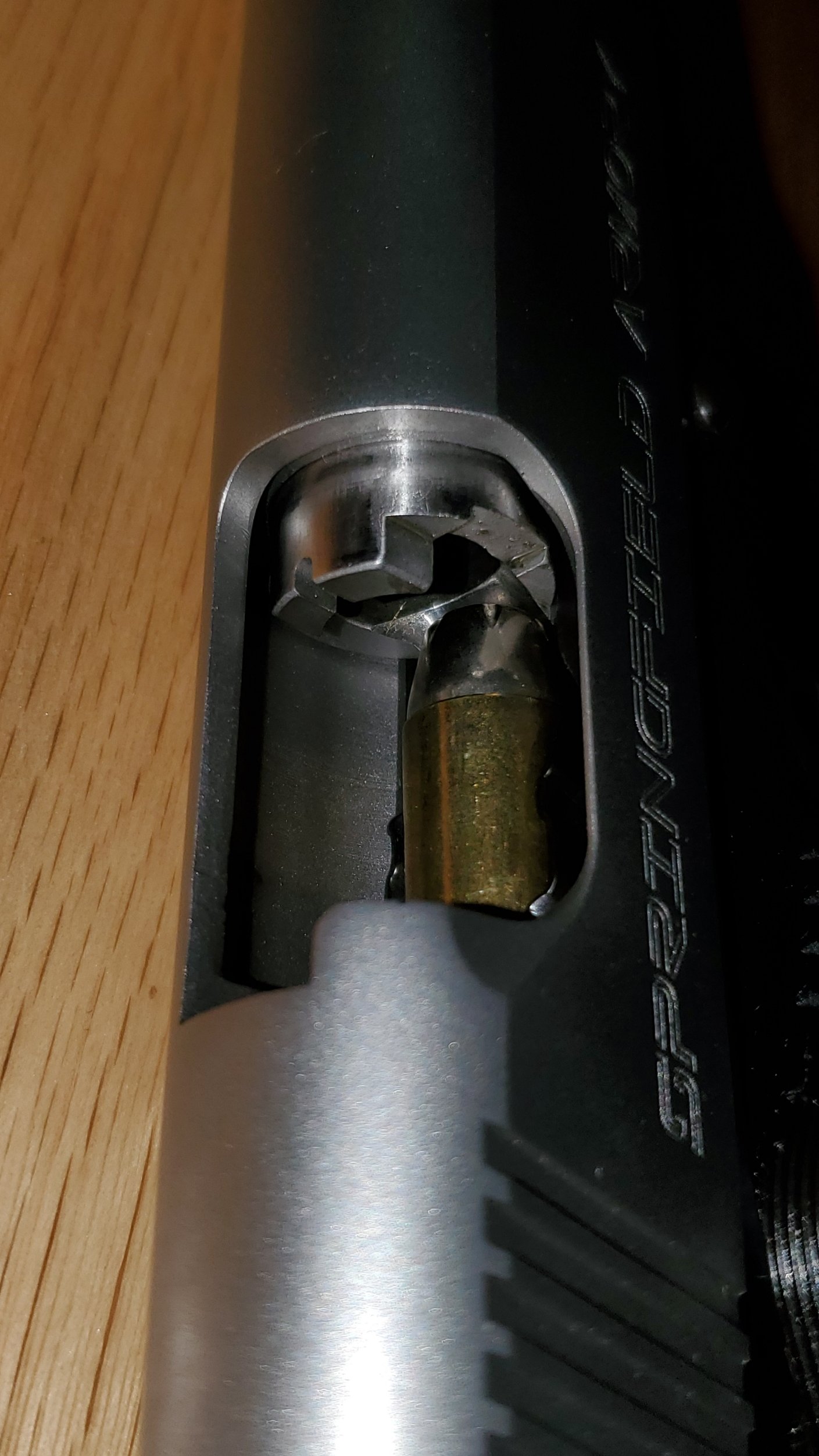

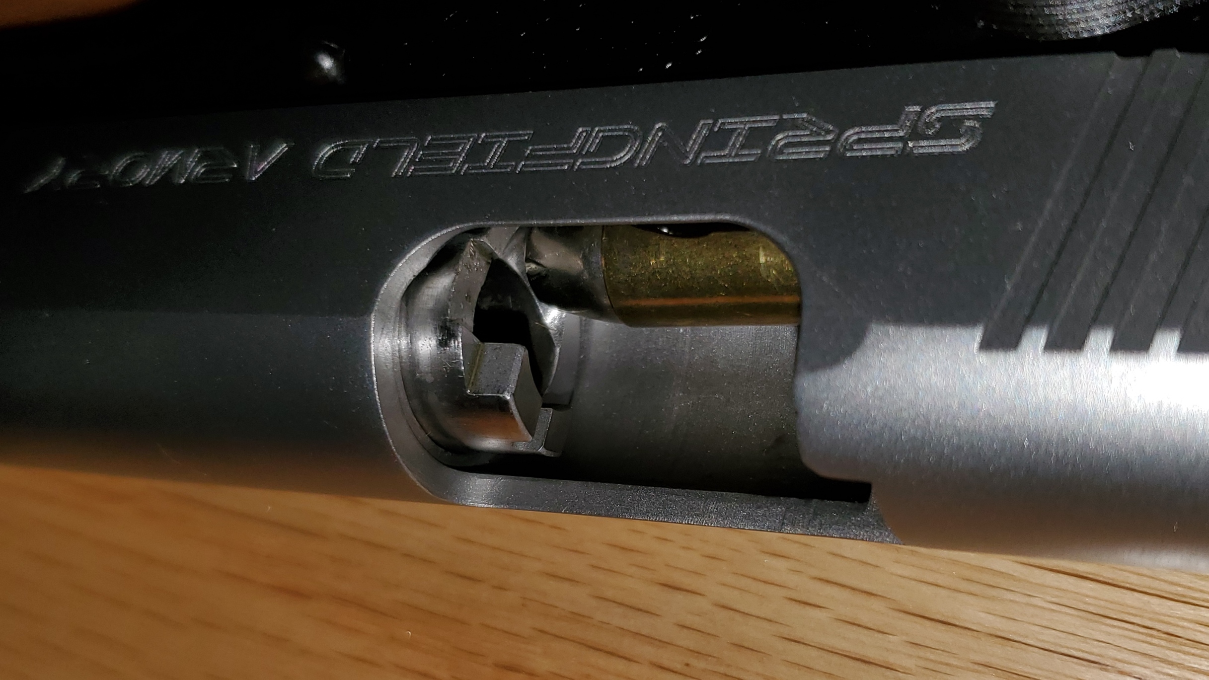

My problem became so bad it would not load any hollow point ammo.View attachment 8031View attachment 8032
That is exactly the same problem I'm having, while it may be the ammunition, I'm not sure if I'm too thrilled having this as my everyday carry at this point.
Updating, I'm sending the firearm into Springfield so they can look at it, but I really don't think this is defect, more maybe a design problem, so I'm not really sure they're going to find anything wrong with it. It's a waiting game at this point.
