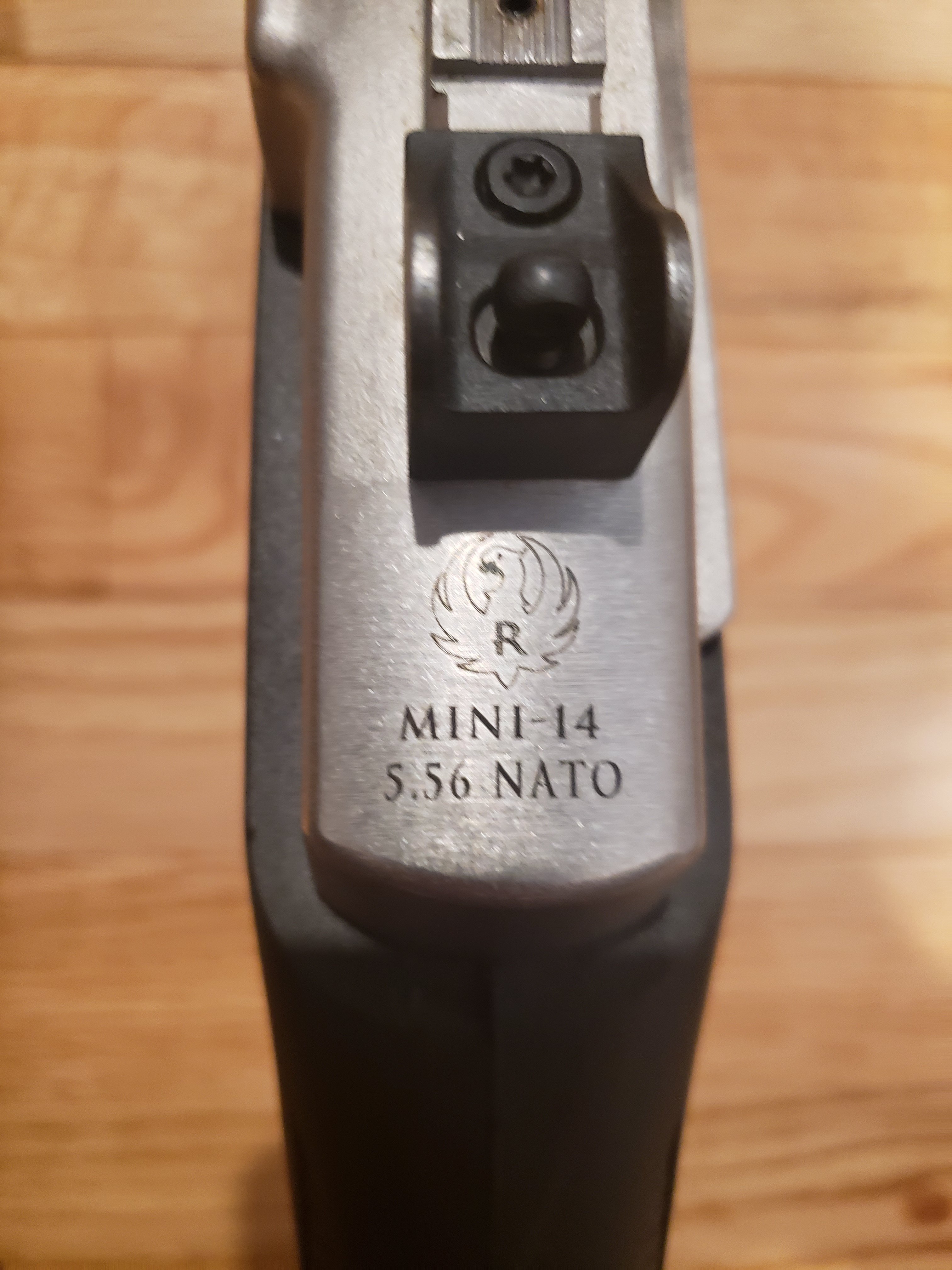

I have a Mini-14 which I love dearly,I wonder why Ruger didn't make it where you can shoot 5.56?Money I guess.also my Ar-15 has a 1-7 twist ,does that mean I need lighter grain ammo?
The newer Mini-14s come stamped 5.56 and I've heard that older Mini's are able to safely shoot 5.56 unless it's the .223 target model. Disclaimer: I would highly recommend calling Ruger to verify if this is true before attempting.
