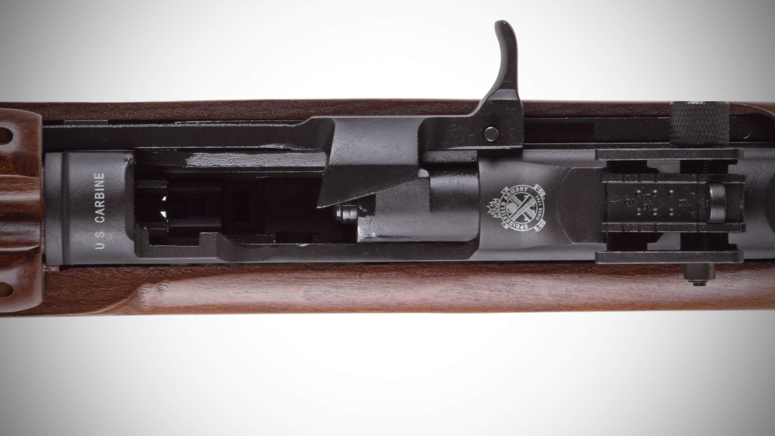

OMG!!! How could you NOT mention Springfield’s M1 Carbine?
One of the most manufactured firearms of WW2.
Springfield never manufactured the M1 Carbine.
M1 Carbine Production

According to Springfield’s magazine, they did and wrote an article about it including photos. So, either they are wrong or you are? Check their recent publications.
Link to the article?
And are you sure you aren’t confusing it with the M1 Garand?
Because I know for certain, I have NEVER seen a Springfield M1 Carbine.

The guns mentioned in the article were produced at the Springfield Armory and Arsenal. The Springfield Armory, more formally known as the United States Armory and Arsenal at Springfield located in the city of Springfield, Massachusetts, was the primary center for the manufacture of United States military firearms from 1777 until its closing in 1968. It was the first federal armory and one of the first factories in the United States dedicated to the manufacture of weapons. Today's Springfield Armory, founded in 1974, is an Illinois-based firearms importer and manufacturer that took its name from the nation’s first armory. Years ago, there were several companies that produced WWII era rifles with cast receivers and GI parts. Most of these products had issues related the cast receivers. The machining wasn't 100% to spec due to the dies and tooling used for production were basically worn out. These products fell out of favor with shooters and eventually vanished from the market.
Ronin
As per HGs point, the original Springfield Armory never manufactured a receiver, nor a M1/M2 carbine in WW2 or the Korean War.
The commercial company Springfield Armory, had boat loads of surplus parts and then had receivers made in order to assemble and sell a non-mil M1 carbine, just like others did.
