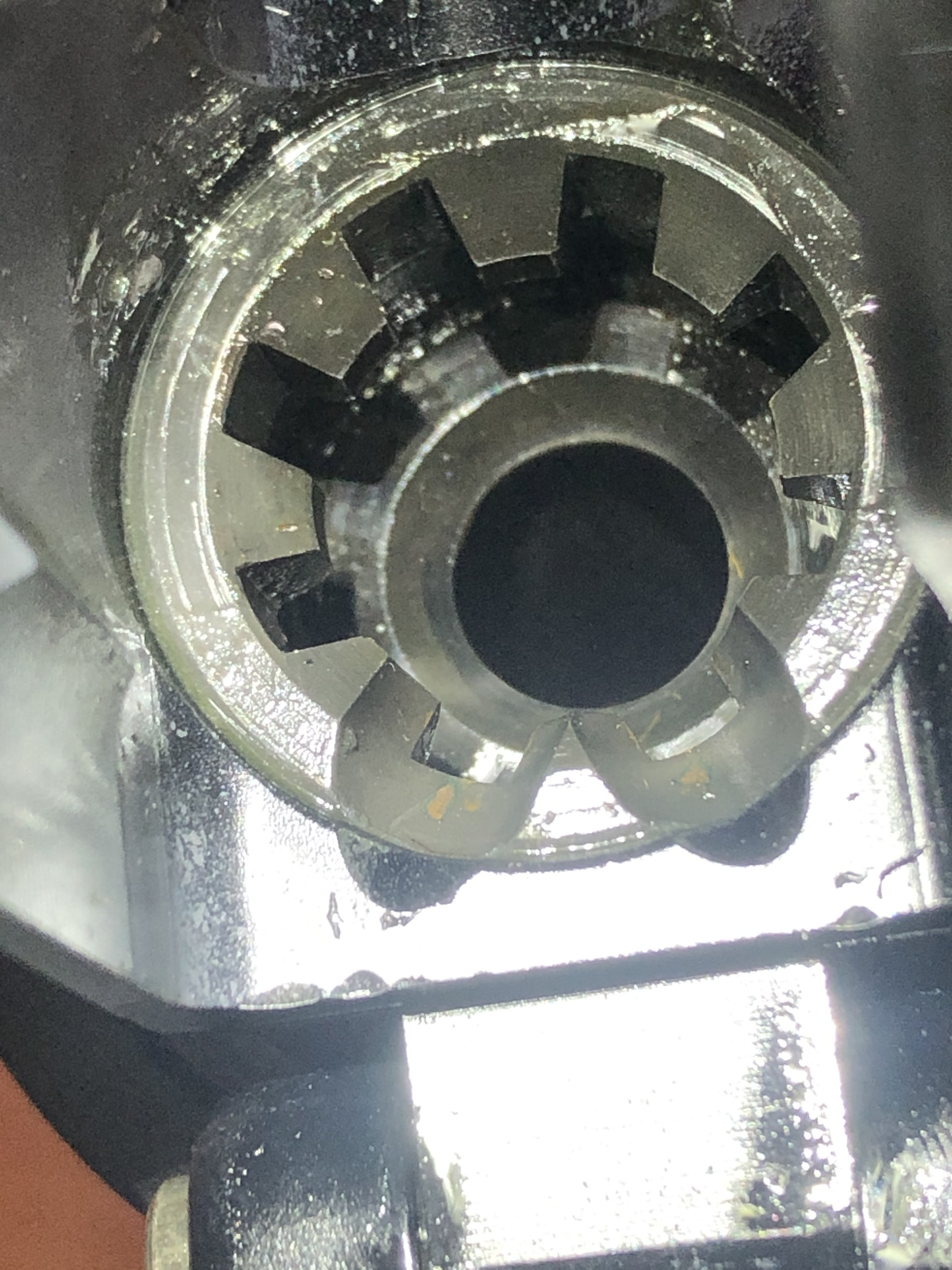

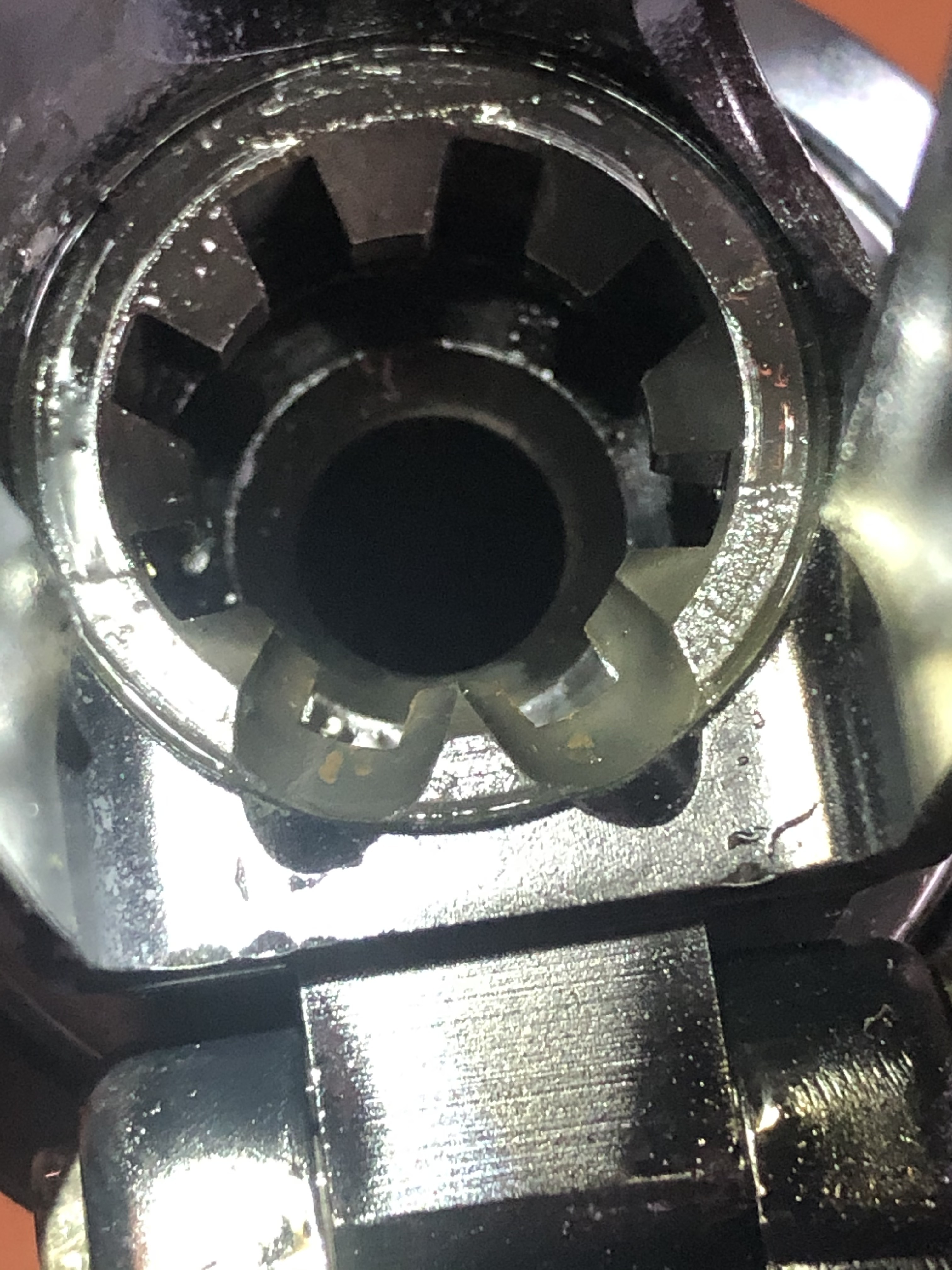

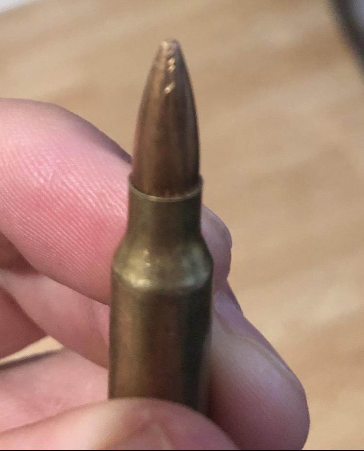

I am running into the same issue. I have never been able to fire the weapon. I have tried to rack a round 3 times and each time I have to mortar the round out. It sucks. I have never fired the weapon, however, it seems to have been fired at the factory. I cleaned and oiled the weapon before I went to the range and got a bit of blackness in the CLP when cleaning it. I do not know the manufacturer of the ammo I am trying but it is .223. I am going to try 5.56 and other .223 brands on Thursday. There are some markings on the feeder ramps. Maybe some brass from the factory rounds? Markings from feeding wrong? I have attached the photos. There is also a bit of scarring on the tip of the rounds, photo attached.
Does anyone have any ideas? Could it really just be a certain type of ammo? Does tolerance stacking play that big of a problem? A friend also bought the SAINT when I did last month and has had no issues. I do not know what ammo he is shooting.
It looks as it could be chambering a bit off maybe? Would a specific type of ammo cause this? Buffer spring not feeding it enough force? It seems to be jammed in there pretty good for that when it gets stuck. Any ideas?

It looks like the marks on the bullet could be from the feed ramps. I’d be curious if your bolt is unlocking. Your saying you are having to mortar the rifle but are you able to see or tell if the bolt is unlocking? I would definitely try some different ammo and check that off my list. I would also invest in a chamber brush as they are cheap and you would be surprised at how cleaning your chamber could fix simple issues.
It could also be your gas block causing issues. I’m not saying it’s it but starting with the easiest and most common, being the ammo I’d start there and check that off.
He says he hasn’t fired it, so I doubt it's the gas block...but the rest is solid advice.
