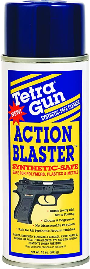

i use the Tetra brand of spray cleaner on my polymer and metal guns, from time to time, it says on the label, it is safe for polymer guns.
but it is a cleaner only. i fall into the category of 1 item for cleaning, 1 item for lubing, not a mix of both in the same bottle or spray can.
it's what gunblue490? says as well.
and as i spray in into the magwell's of my 1911's that have wood grips, it does not seem to be an issue. then too, grips are cheap, if i have to replace them.
