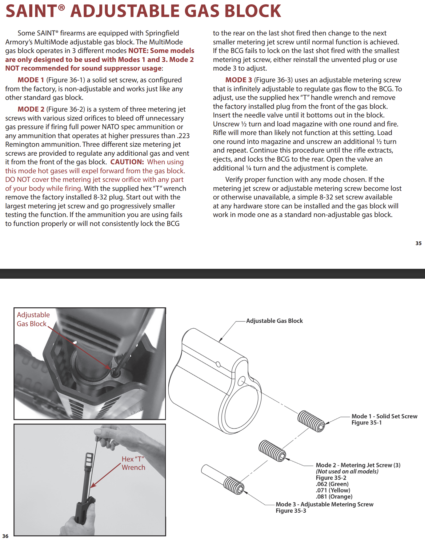

I just received my Banish 30 suppressor for my .308 AR-10 and took it for a drive today. I noticed a problem immediately: The rifle will only fire a couple of rounds through it before it gets a feed jam. Researching this a bit today seems to point to too much back pressure due to that suppressor being onboard.
I know that the SAINT VICTOR .308 AR-10 rifle has an adjustable gas block which can have various set screws to adjust that back pressure, but wondering if anyone has gone through this process before and can offer some guidance.
Picture from the manual included here.
Thanks a ton.
