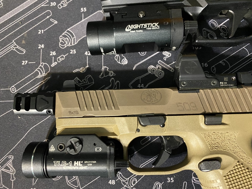

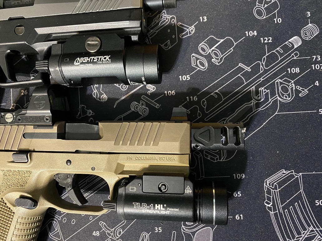

Does it look cool: It looks good, like 5 feet or more away and you probably can't tell the difference. Up close there are a lot more things to notice. The anodizing on the Bayco is not as nice as the SL, it does not have the shiny metal band on the bezel and the plastics on the switch gear are a slightly different shade of black. So I give it a solid B on the looks.

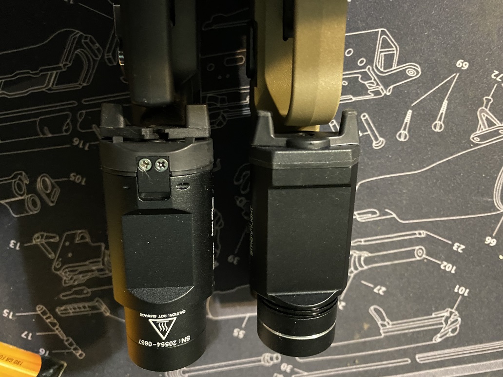

Mounting: The Bayco has the mounting system reversed from the SL, and the tensioning screw is slick and does not have the little tabs that the SL does that allow you to get it reasonably tight with finger pressure. I also think the screw is zinc, which I am not a fan of as using carbon steel is not that much more expensive, but a lot more durable. It also does not have all the little mounting adapter bits for specific guns brands like the SL. It comes with three metal (cast zinc I believe) plates that get "close enough" for all the guns I tried. It does not have the exact fit and tight lock up that the SL does. But once it was mounted up, it is tight to the gun, secure and is not going anywhere.
Batteries: This is the main failing of the Bayco compared to the SL. The Byco has a screw head that you have to undo to swap batteries. You have to have a tool to perform the battery swap. The SL does not, so a win for the SL. Battery life seems about the same.
