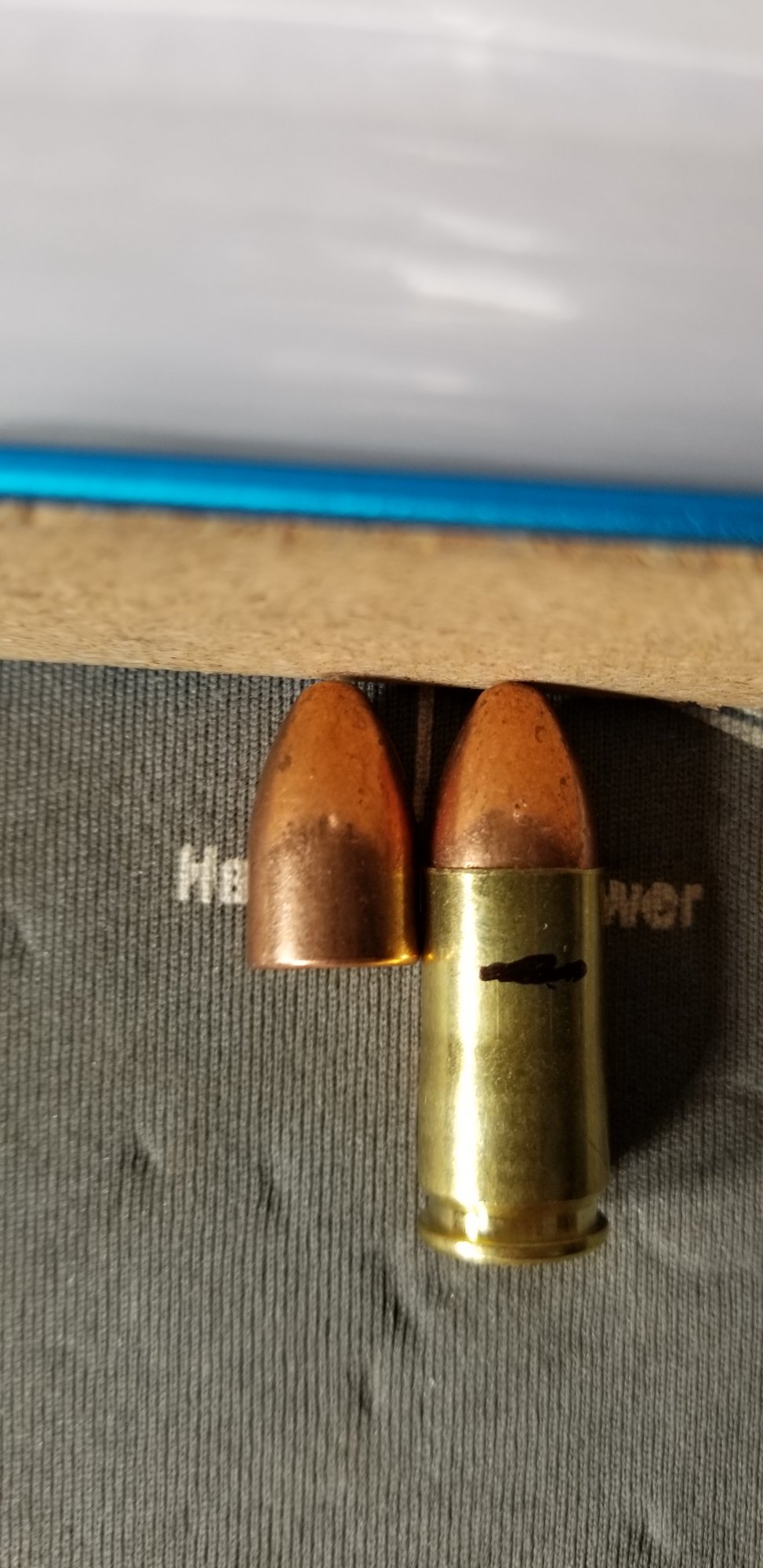

Case capacity?
Do you know your capacity? Some manuals show a %age for the powder charge per grain and coal. Have you ever checked or even wanting too find out? If so here is 1 way to check. With a used primer installed seat a bullet to the coal, then remove the bullet and fill too the line. See example. Or with bullet removed fill too the bulge.
