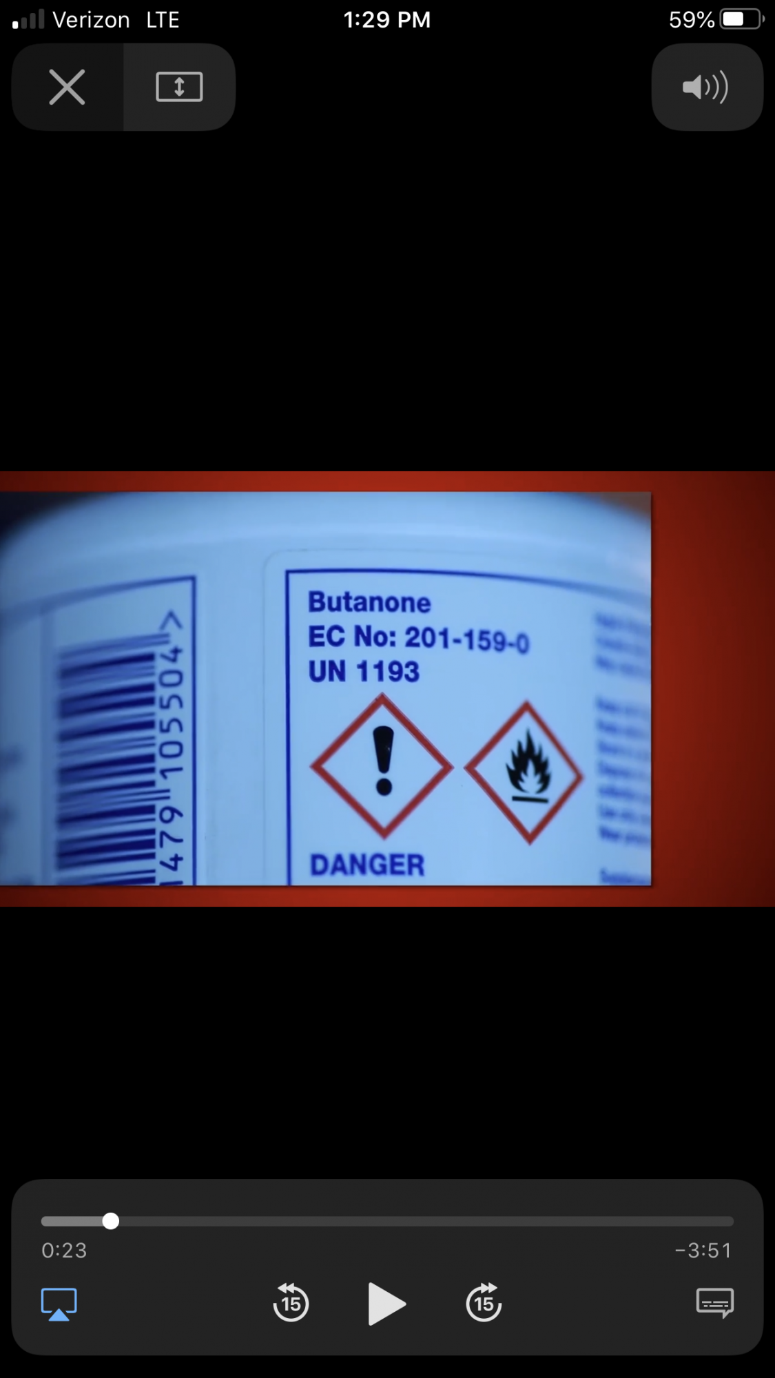

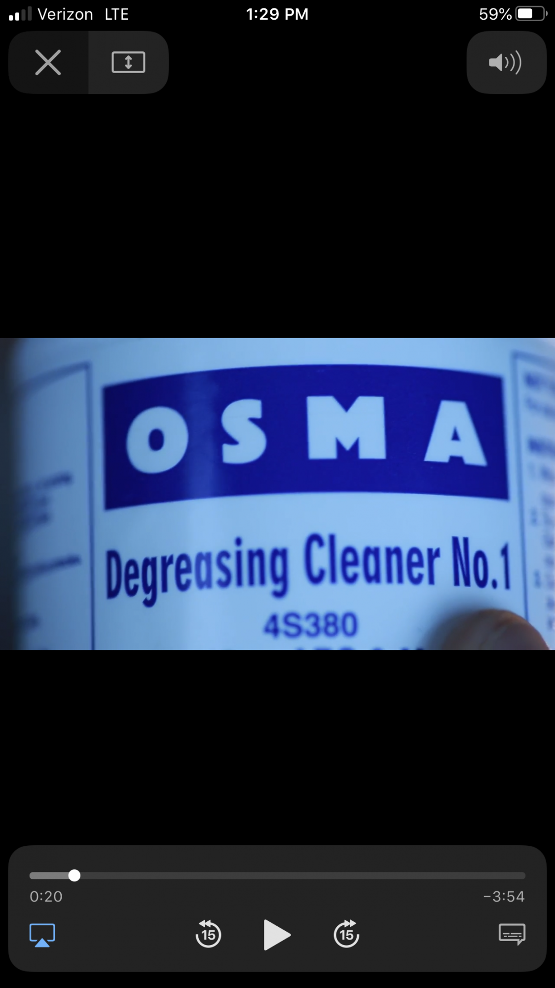

Haven’t had a chance to look yet put I took a screen shot
