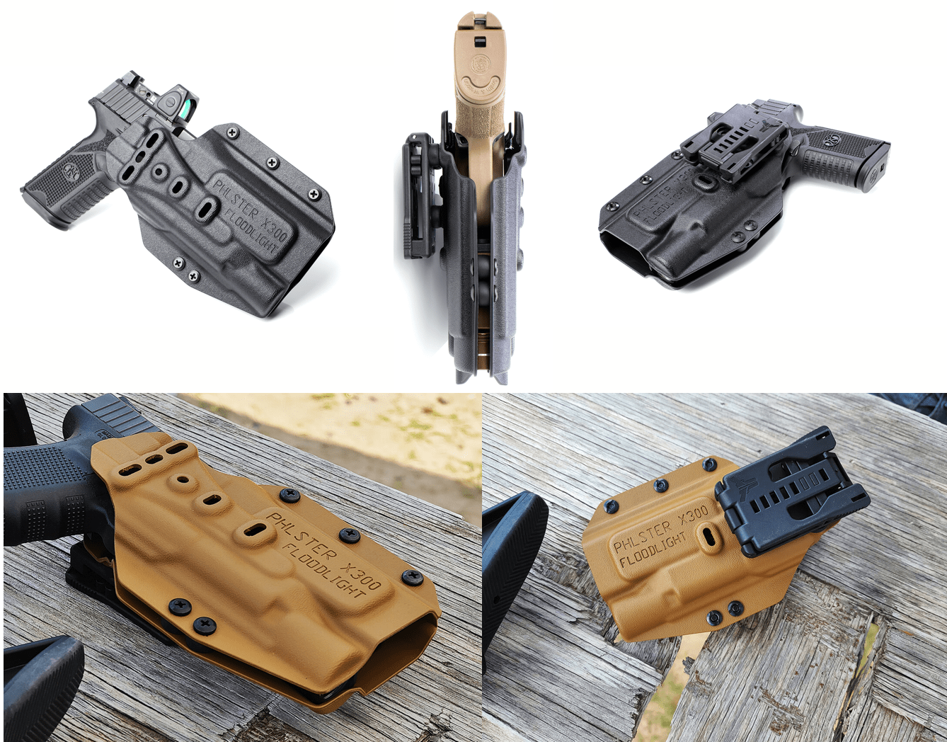

In many cases, the use of today's most popular handgun-WMLs means a holster design that's somewhat compromised where it comes to the potential of something - be it an object or a finger - being able to interact with the trigger while the gun is still secured in the holster.
And these holsters are actually all of "modern," full-trigger-coverage design.
This is not a new or unknown issue...at least not for well over a decade ;) ....
For those of you who are in the Primary & Secondary and PHLster FB groups, you can use the FB search function to also bring up past discussions there, with respect to this concern.
And this is not with "crappy" gear. I've seen this with both what can be considered the de-facto "standard" where it comes to duty/service retention-holsters (like the Safariland holsters in the referenced thread above), as well as what are/were considered standard-bearers in the civilian (and professional as well) concealed-carry side of the equation, too (i.e. Raven Concealment Systems, PHLster, Dark Star Gear etc.).
The problem is what the holster can -and cannot- do when it has to also accept the underslung WML.
Is this an excuse?
No.
But it does point out, indeed as @iklwa noted, that further consideration should be given to even duty/service weapon carry, and powerfully echoes the Chief's sentiment that further training of the officers need to be addressed as well.

^ Yup. Again, in many cases, the use of today's most popular handgun-WMLs means a holster design that's somewhat compromised where it comes to the potential of something - be it an object or a finger - being able to interact with the trigger while the gun is still secured in the holster. With the light physically being wider than the frame of the gun, there's some geometric issues.....
^ The above is from Reddit member FlyingDog14, and left-to-right are as-quoted verbatim "Glock 20/Safariland 6285, Sig M17/Safariland 7390, Glock 19/old school Bravo Concealment." I could show the same, with my XDms with either the old Insight M6/M3(x) or Surefire X300, with my old Safariland 5188 bucket, RCS Phantom Light Bearing, or my Glock 32/X300, with my Dark Star Gear. My current EDC IWB from KT Mech? Not so much, but that's because the gun is paired with a small and slim Surefire XC1, a holster and light combo which would be unsuitable for open-carry in a duty/service context.....
Also one has to keep in-mind that the interaction does not have to be intentional/purposeful. That someone's finger, be it a child's or a slim adult's (or even the pinky of a rather larger adult that was forced into that opening due to the two individuals' physical, entangled fight) many just slip/pop in there (in the OP's cited case, because the suspect was literally attempting a gun-grab...who knows what the physical forces involved in trying to keep that grab from being successful may have inadvertently produced?) and literally be dislocated, fractured, or even de-ring'ed on the way out has little to do with the simple fact that said appendage caused the unintentional discharge.
These aren't fly-by-night, third-job-to-support-a-case-a-day-of-beer-plus-child-support kydex benders. :)
Is it dangerous? I don't know: maybe the designs can be further refined (and they have: and if it is the case that the Department failed to keep pace with modernizing equipment, a case can definitely be made, there) to reduce this risk, but a not-insignificant portion of this also has to do with the light's design. Sadly, in several cases, the lights with the better form-factor falls behind in other areas that are arguably just as important (output, reliability, and durability).
Regardless, as @KASHIRA-3 noted above, the weapons-retention techniques -as well as simple administrative procedures- which allowed this incident to happen are really what is at the crux of this issue, and needs to be addressed in addition to reviewing the holster/gun/light combo for possible excessive vulnerabilities, on a technical basis.

^ So then the question follows - with your needs and preferences that "the juice is not worth the squeeze," where it comes to the compromise between having a pistol-mounted WML and the relative "open-ness" of the mouth of the holster around the trigger-guard area....
...but at what point does that equation flip the other way?
For many LE agencies, their UoF continuum treats a gun-grab as a potential lethal-force response - in this context, is the fact that a suspect is able to, through vigorous physical force literally force his/her way into the holster and cause an unintentional (to the officer) discharge an actual problem with the holster (which may continue to otherwise retain the weapon and prevent a successful gun-grab), or does this failure signal deeper considerations? Further, does this concern effectively negate the ability for officers to be able to employ WML-enabled handguns?
And lets also look again at the civilian side of the question, too. Currently, the de-facto Gold Standard for multi-gun/multi-light (the Modlite PL350 model will be released simultaneously with the light) capability IWB/OWB passive-retention-only WML-enabled is the PHLster Floodlight:
^Picture take from OPTactical.
Geared towards conceal-carry, it's gained a large following even among the "gear snob" crowd on the likes of P&S and similar. Yet, there's still an undeniable gap in that area....
