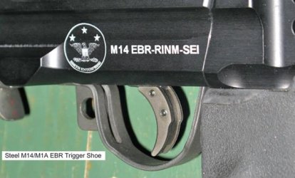

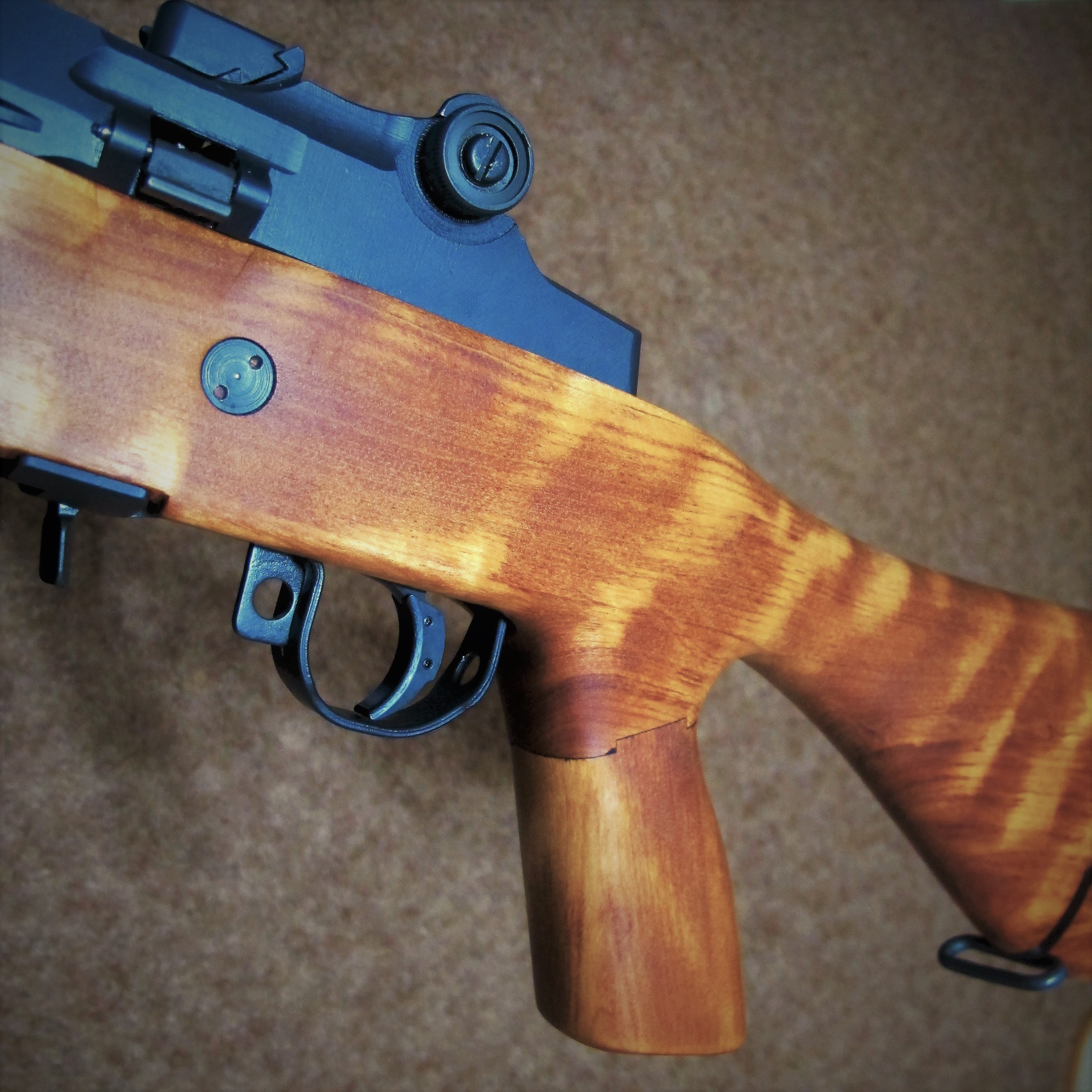

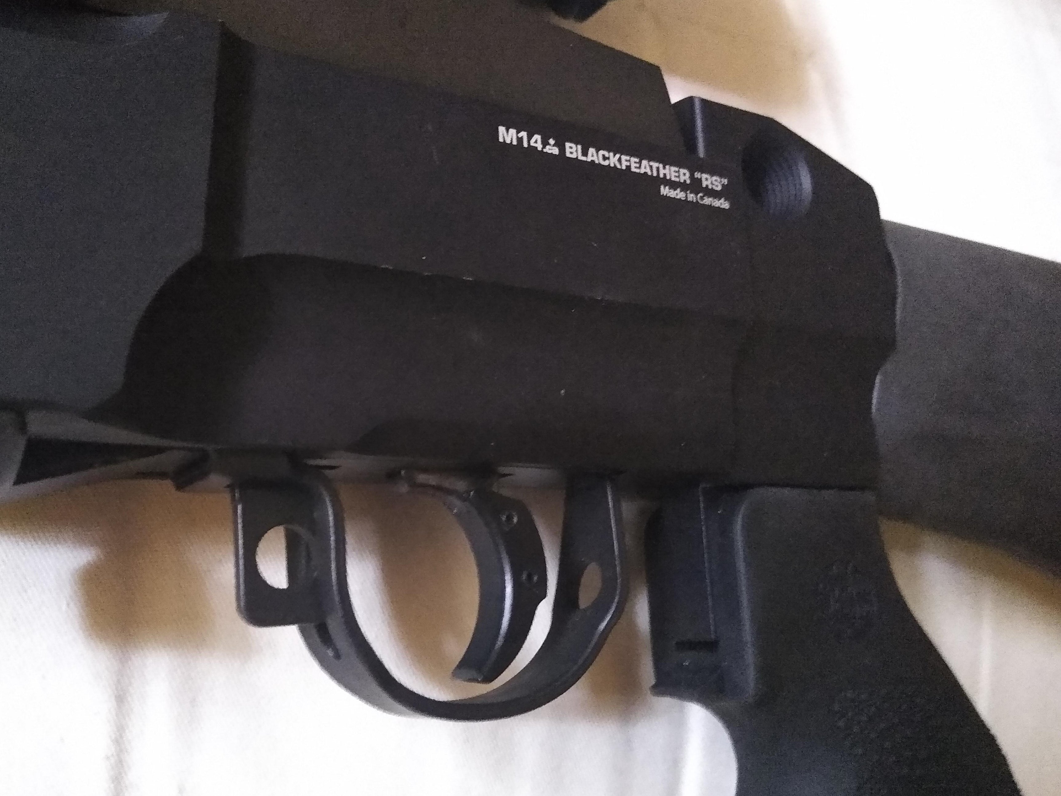

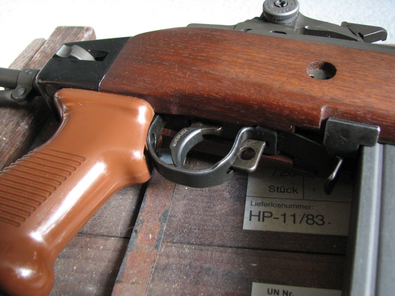

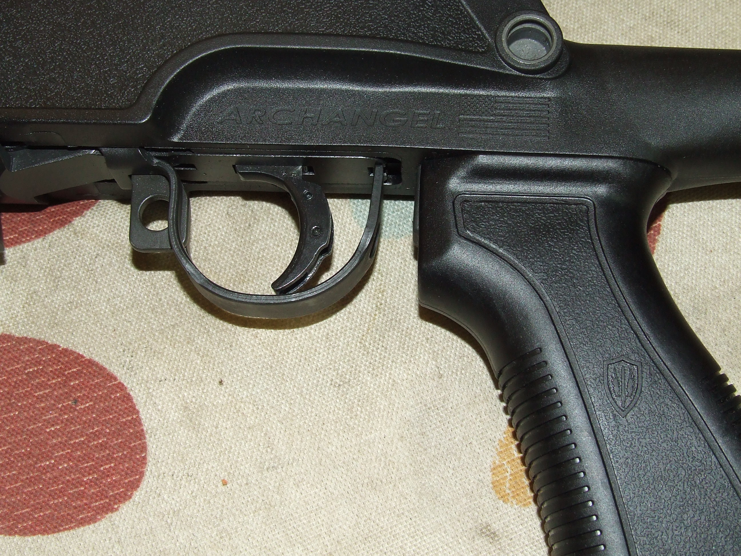

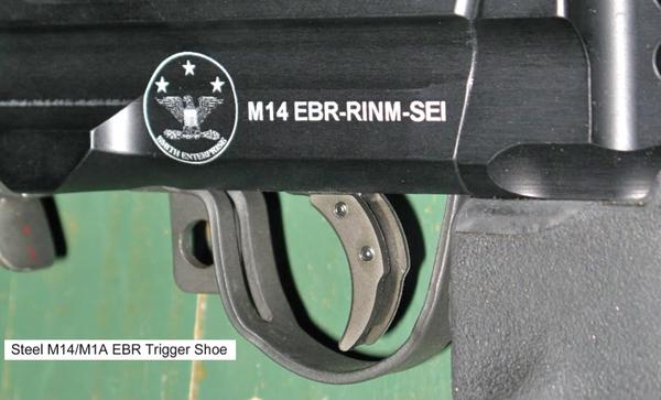

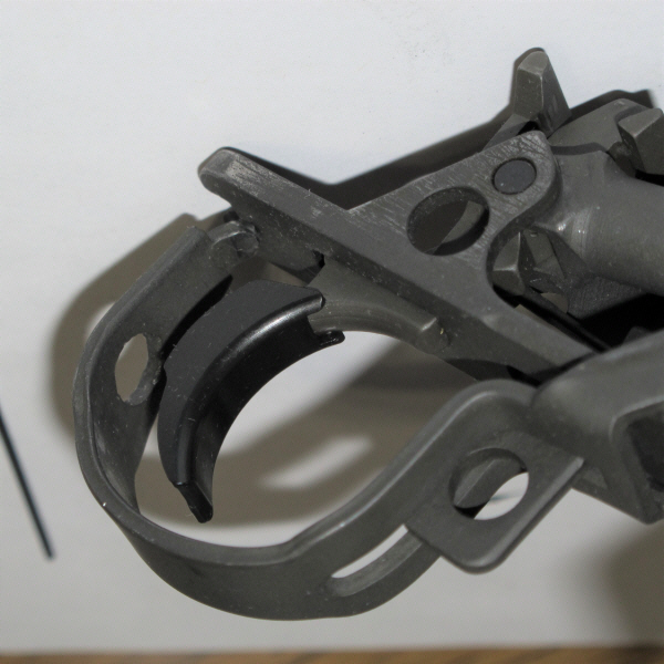

It depends on the firearm and in this case, it depends on the stock. The M14/M1A trigger is designed to be pulled in more of an upward direction. The original trigger design is not user friendly when a pistol grip is used. The M14 EBR trigger shoe is wider & longer, with more surface area. The steel M14 EBR trigger shoe is designed with the correct angle required to direct the trigger pull more to the back than up. With the shoe installed the tip of the trigger can no longer stab the tip of your trigger finger. The trigger pull feels natural & lighter with the USGI M14 EBR shoe installed.

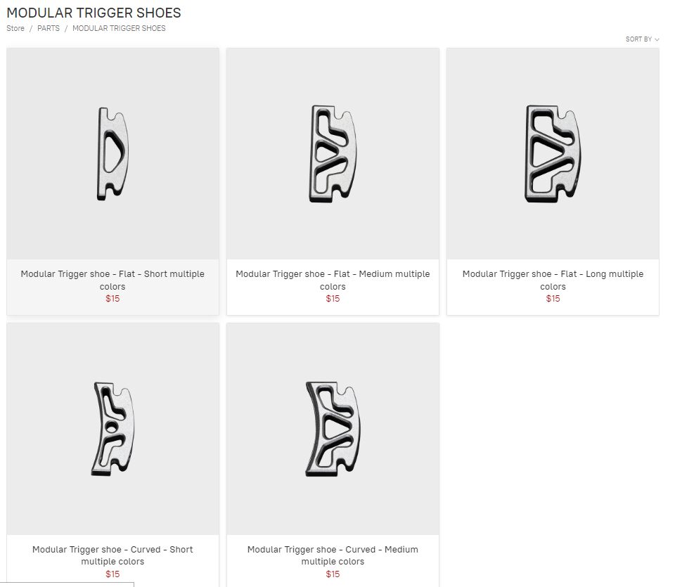

On the 2011 platform one manufacturer that I know of has come out with a novel solution, a modular trigger shoe. Bul Armory has a modular trigger shoe on some of their products that allow you to simply switch out the shoe of the trigger to either a flat or a curved face. With this system the trigger has a removable shoe held in place by a simple hex screw. The face of the trigger can be changed out to whichever choice is best for you.
You can also opt for a thicker shoe that adjusts the trigger's position so that you can effectively adjust the placement of the trigger to make it fit where you like to place your trigger finger. By adjusting the trigger placement, you can adjust the length of pull to better obtain a position where you can place your finger exactly where you need to in order to allow for the length of your finger so that you can obtain a straight back pull of the trigger and reduce or eliminate pulling back at an angle and pulling the gun off target.
It's available in short, medium, and long, as well as several colors. It would be nice if other manufacturers would adopt this system.
