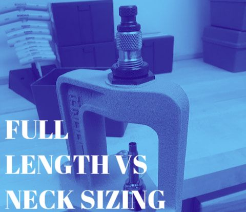

First the differences; with neck sizing dies (whether bushing or conventional) you are only resizing the case neck, and with most setups, not the complete length of the neck. When full length sizing with a properly setup die, you are pushing the shoulder back .002” to .003” ideally (some reloaders shoot for only .001”). Also, you are sizing the case neck and the body of the case.

My personal position is that I will full length size my fired brass every time I shoot. I setup my die to push the case shoulder back approximately .002”. I use a bushing style threaded die most of the time. On rifles where I have fully turned necks, I’ll use a specific bushing to obtain the desired bullet grip. On non-neck turned brass or brass where I have turned just enough to clean up thick spots, I’ll use a bushing that sizes all of my brass just enough so that the inside neck dimension is slightly smaller than the diameter of my expander ball. By doing it in this manner, when I pull the brass out of the die and over the expander ball, all of my brass will have approximately the same inside dimension (i.e. bullet grip/tension).
