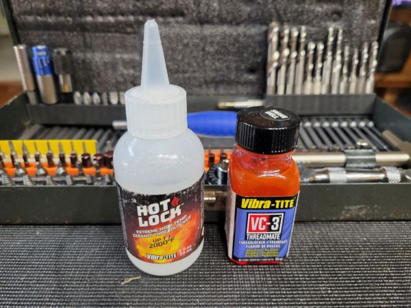

I use Vibra-Tite. It is re-usable, in other words you can loosen the screws and re-torque them without cleaning and redressing the screw, up to 4 times. No heating etc.
VC-3 for screws and Hot Lock for brakes etc.
I find it best to order the small single use packs, The small bottle of VC-3 above has to go ground with a haz-mat fee and while it will prolly do a 1000 guns it has a shelf life.
With that being said i would always try o-rings 1st.

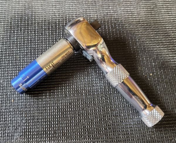

Ten "INCH" lbs, 12 max. depending on what grips are made of.

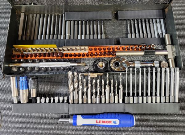

I use this for torquing on guns. Its small, much easier to control then a fat wrench, especially if you are working with a slotted screw. This one goes up to 25 in lbs. I have em up to 65 inch lbs.
A good kit is a must, not the pre put together "gunsmith" kits either. Ever notice how you dont ever use half the bits in the kit?
I pieced this one together over the years and its served me well.
Thats all I got.
Thats all I got.
Nice kit you have assembled.
Thats all I got.
