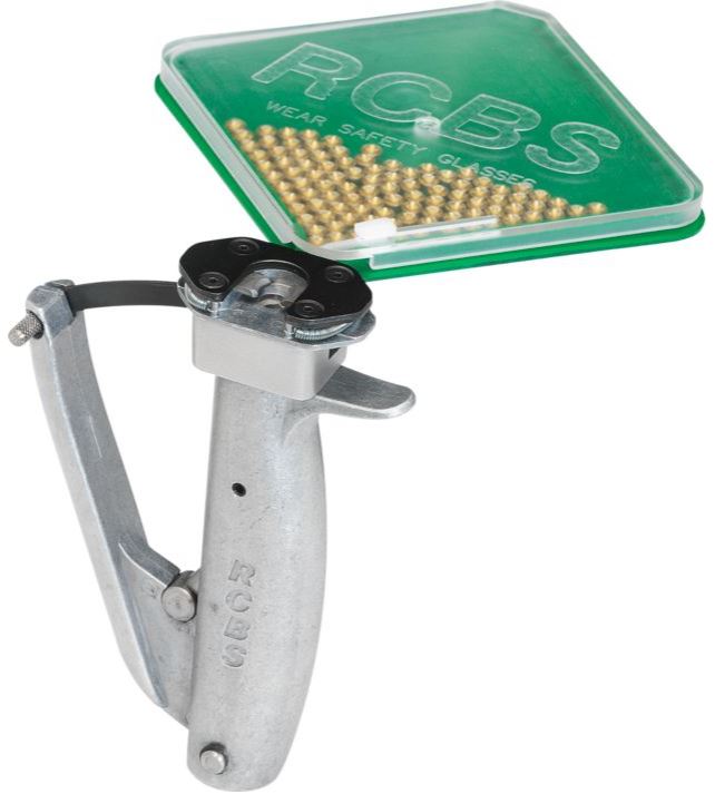

The first one that I acquired is listed as a Hand Primer.
Pros: Works as advertised.
Cons: For each caliber you want to load you must have that shell holder installed.
Primer tray will hold 100 primers and is grooved to easily flip primers to proper orientation.
Cost is about $50..... Sometimes on sale with $10 off.

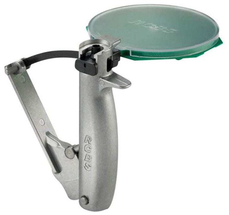

Second is the Universal Hand Primer.
Pros: Needs no shell holder for 32ACP to 45-70 Calibers.
Cons: Doesn't handle my 45LC/454 Casull cases.... they pop out.
Cost is about $70.... Can sometimes be found on sale with varying savings.

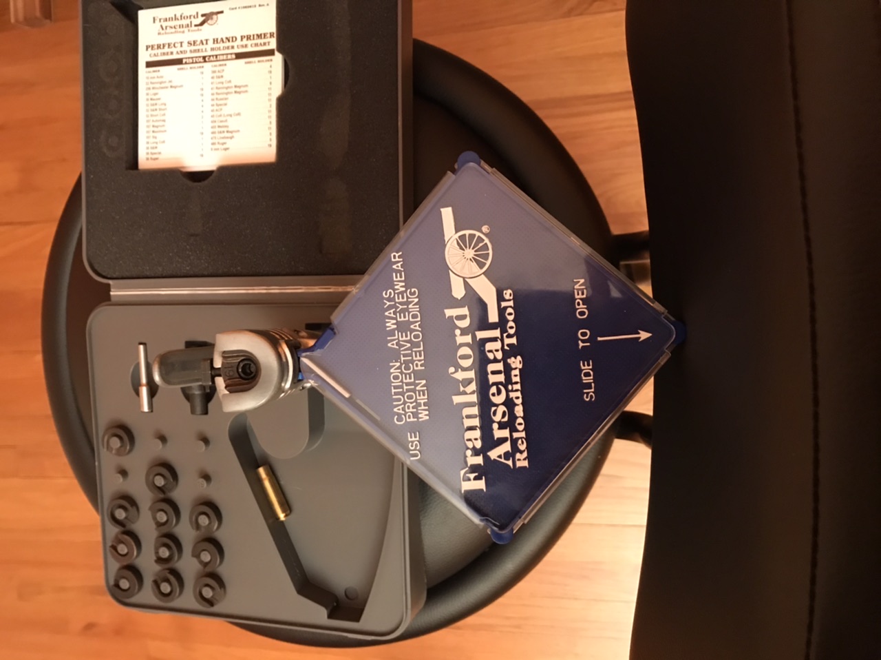

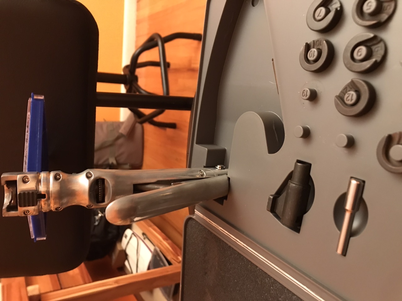

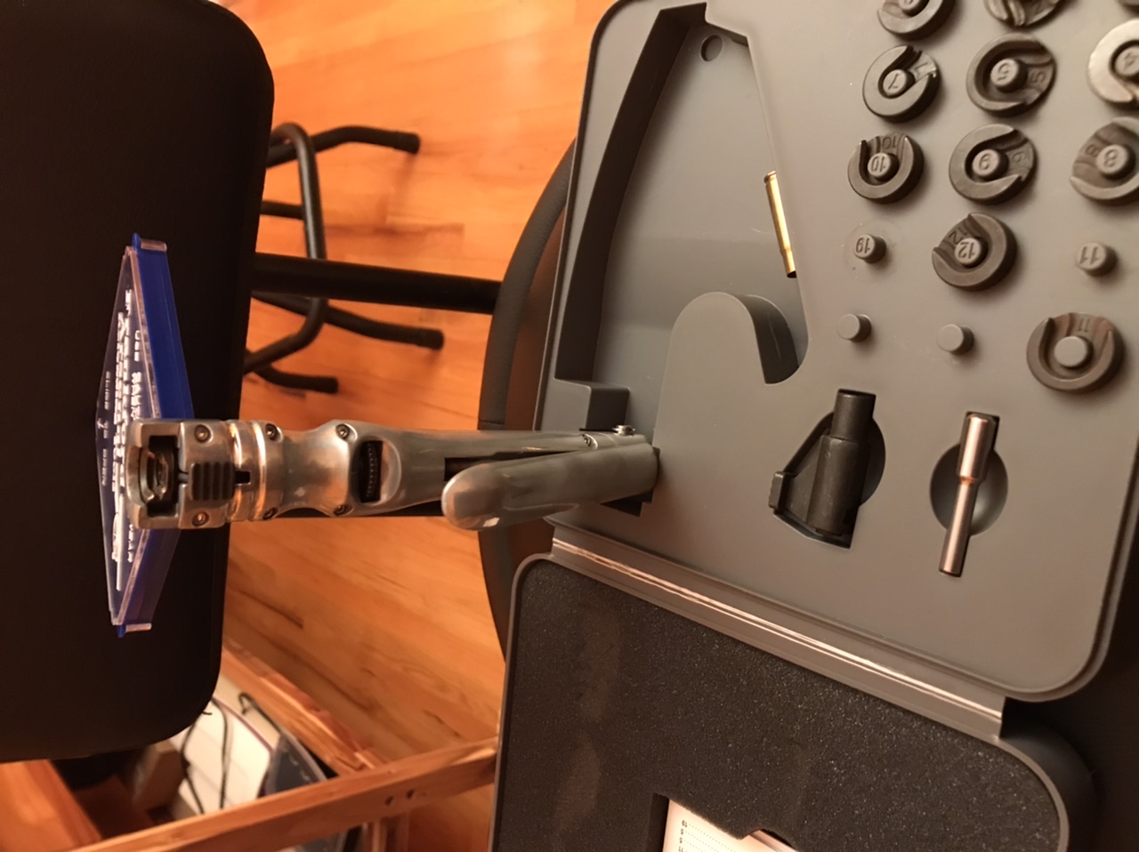

I’m partial to the Frankford Arsenal Perfect Seat Hand Primer. It runs around $60 when you can get it on sale. It has proprietary case holders included as well as rams for small and large primers. The tray, also a flipper, holds plenty of primers, though I stick to a sleeve of 100 at a time. what I like best is the ratcheting dial that allows you to set the primers where you want. Each click represents .001”. Starting out I produced many high-primer rounds....with the resulting click (insert profanity) click bang vs the desired click bang.
