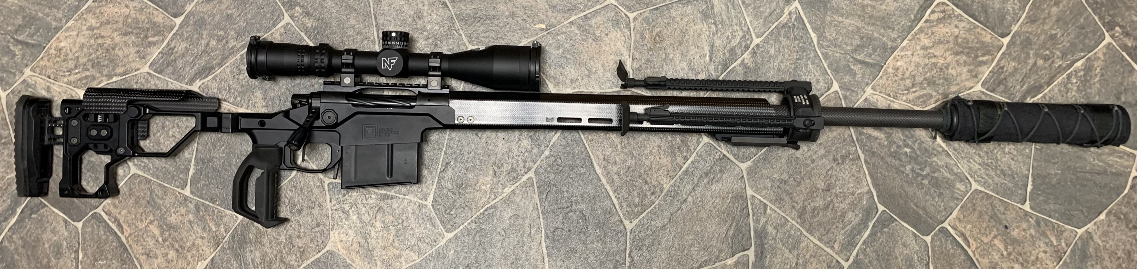

Great enjoy. I went with the NightForce SHV 5-20x56 Scope with an Atlas Bi-pod. The NF scope was a lower price alternative than their NXS and ATACR models I looked at, but was about as expensive (even on sale at Optics Planet) versues the rifle. I quickly found out just how expense PRS can be, and I'm at the cheaper end ;)

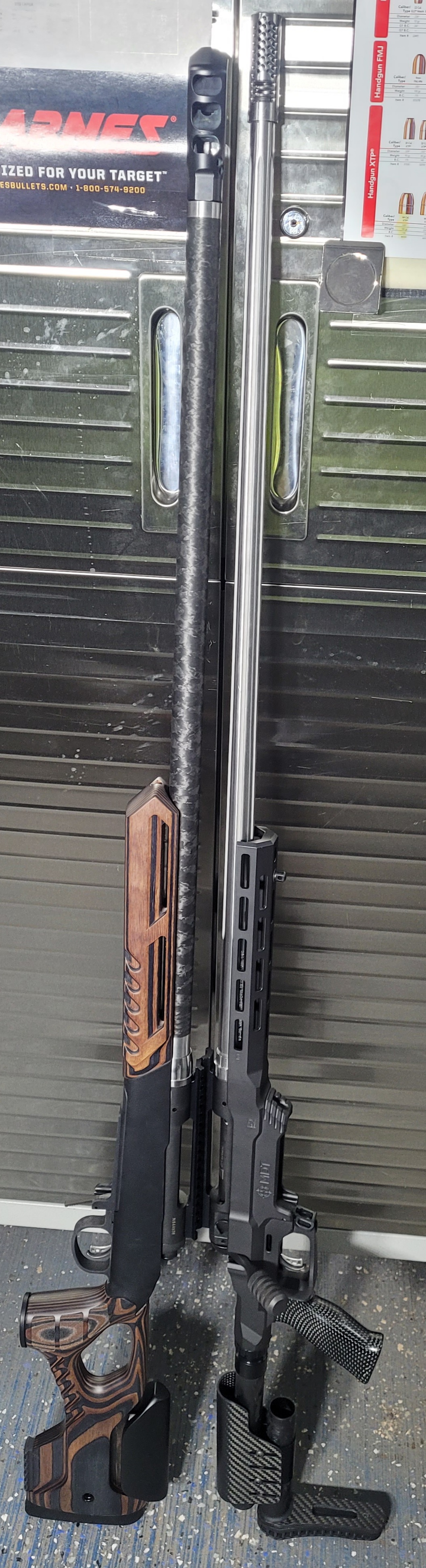

Most 33cal bullets will stabilize with 10 twist, but some of the 300+ needs a 9. The Savage 338lm stealth (24") has the 9.25, but some (I think) had the 10. 1 reason I didn't buy the 300wm precision was due too the 30" barrel had a 10 twist. To spend $1,600+ and then replace the barrel for a faster twist I decided not to buy. Here's what happened. I buy parts then build what exactly I want. 2 Savage 110 lam receivers for a 30" cf 9 twist and a 32" 264wm 7.5twist. Problem solved!
