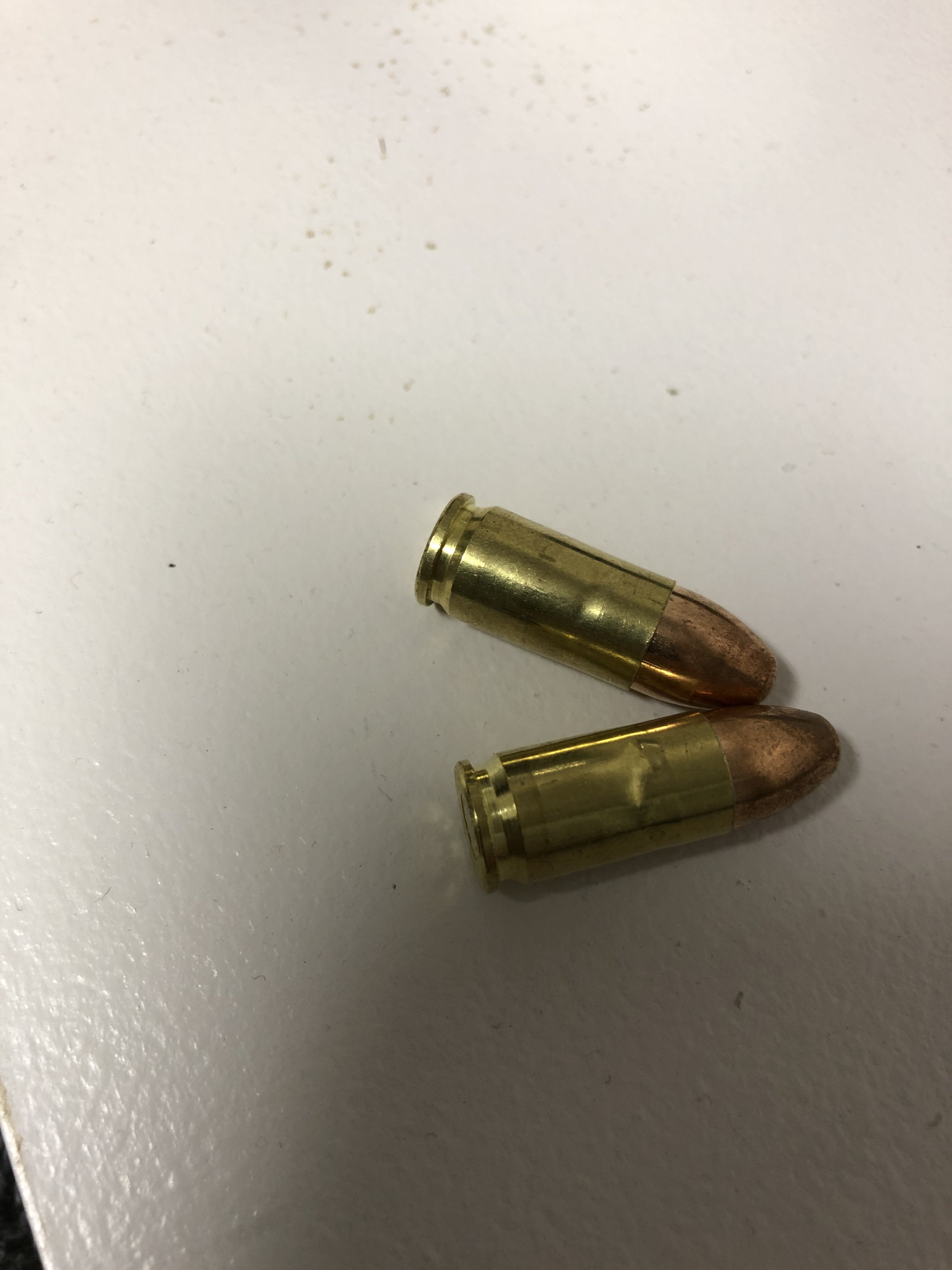

Anyone having trouble with hellcat magazines? I took out a fully loaded 11 round mag today and 6 rounds fell out of it. I seems the spring got hung up somehow. Also I noticed all the ammunition was bent and disfigured on the casings where they were pressing into the wall of the magazine. Pretty disappointing.

Sure does. I checked the 13 round mag and it looked the same. It is pretty hard to get the last few in there but I’d think if it had enough pressure to damage ammunition they change the design. It sucks as I just bought this for an EDC and it’s shown me I can’t trust it with my life.

I've got about 500 rounds through my hellcat so far, and both my 11 and 13 round mags are HARD to load. I use an Uplula every time, and have never seen dents like that. I can't even think of what, in a mag, could DO that to a round. Those don't line up with any part of a mag, moving or otherwise. Does the mag in question, have a crease or a dent down one or both sides? If it does, that could potentially explain both the dented rounds and the sticking spring plate.

Mike, I realize you haven't answered my post yet about whether those are factory or reloads, so let me add this before you do. In the pic it appears there is little to no crimp to those two cartridges. In fact they almost appear to have been expanded to accept the projectile and neglected to do a crimp after the bullet was seated. If that's the case, the bullet pull would be pretty insignificant and maybe allowing the bullets in some of them to move slightly forward with either the slam of the slide closing or the shot itself.
I know that's kind of a stretch to consider, but your problem is really interesting in that nothing obvious is working here as far as we can tell. Maybe worth a quick consideration. (y)(y)
