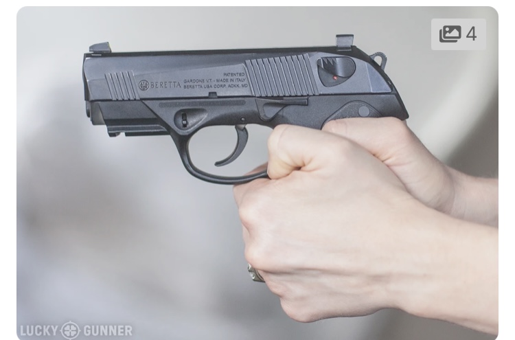

Ok, it might be your limp wristing the gun with the heavier loads and inadvertently hitting the slide lock during recoil…..if you noticed you had the issues with the heavier bullet weight and also the NATO rounds which are a tad warmer loads. This is just a thought, limp wristing is common with the smaller pistols, but not always with the smaller ones, some do it with full size pistols and 1911’s, it’s just easier to do with the smaller ones.
when you “slingshot it” are you doing it overhand or just punching it by your thumb and finger?
Or what happens a lot of folks shooting high thumbs/thumbs forward in Most cases your thumb is striking the slide stop/slide release under recoil. I had a similar issue with an Sig 228 I was issued except I hit it where the slide would not lock back after the last round.
The general issued handgun was a Beretta 92D and with that diving board of a slide stop/slide release lots of folks had your issue of kicking the slide back with BB’s still in the mag
So the easiest trouble shoot is do a revolver or crushed grip with thumbs locked down os your thumbs and everything else is away from the slide stop and see it that rectified it. If it does them it is your grip, you can also have an experienced friend run a mag of suspect rounds and see if that is it.
That’s the easiest thing to start and if it doesn’t elementary it move on to the sling shot as try different methods to see it that cleared it so on and so forth.
Just for reference what a revolver/crush grip is pic below
Good luck

I thought about that could be his issue and it still could be but the Hellcat's slide stop is so diminutive I'm having a hard time seeing it get inadvertently activated. It has never happened to me with mine but I guess it's possible.
If that was the case, I would think there would be issues firing the Federal HST as well. Not saying you're wrong; it's just a curious phenomenon.

"when you “slingshot it” are you doing it overhand or just punching it by your thumb and finger?"
I'm right-handed, so I grasp the grip with my right hand (finger off the trigger and outside the trigger guard), grasp the rear of the slide with the thumb and forefinger of my left hand, pull the slide to the rear until it hits the stop, then release.
Thanks for the suggestions. I'll give them a try on my next range trip.
