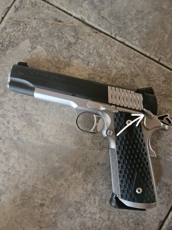

Would you be able to snap a photo of the part. Just to confirm if I understand the part you’re talking about.

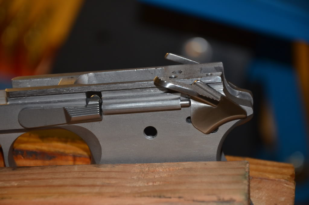

in the future, when you go to lube your gun after a cleaning.?
put a drop of oil at both ends of the "plunger tube".
i usually always use a small pocket screwdriver to push in the plunger (the piece sticking out against the safety), so that the oil gets deeper into that tube.
picture of a 1911 plunger tube...
