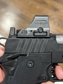

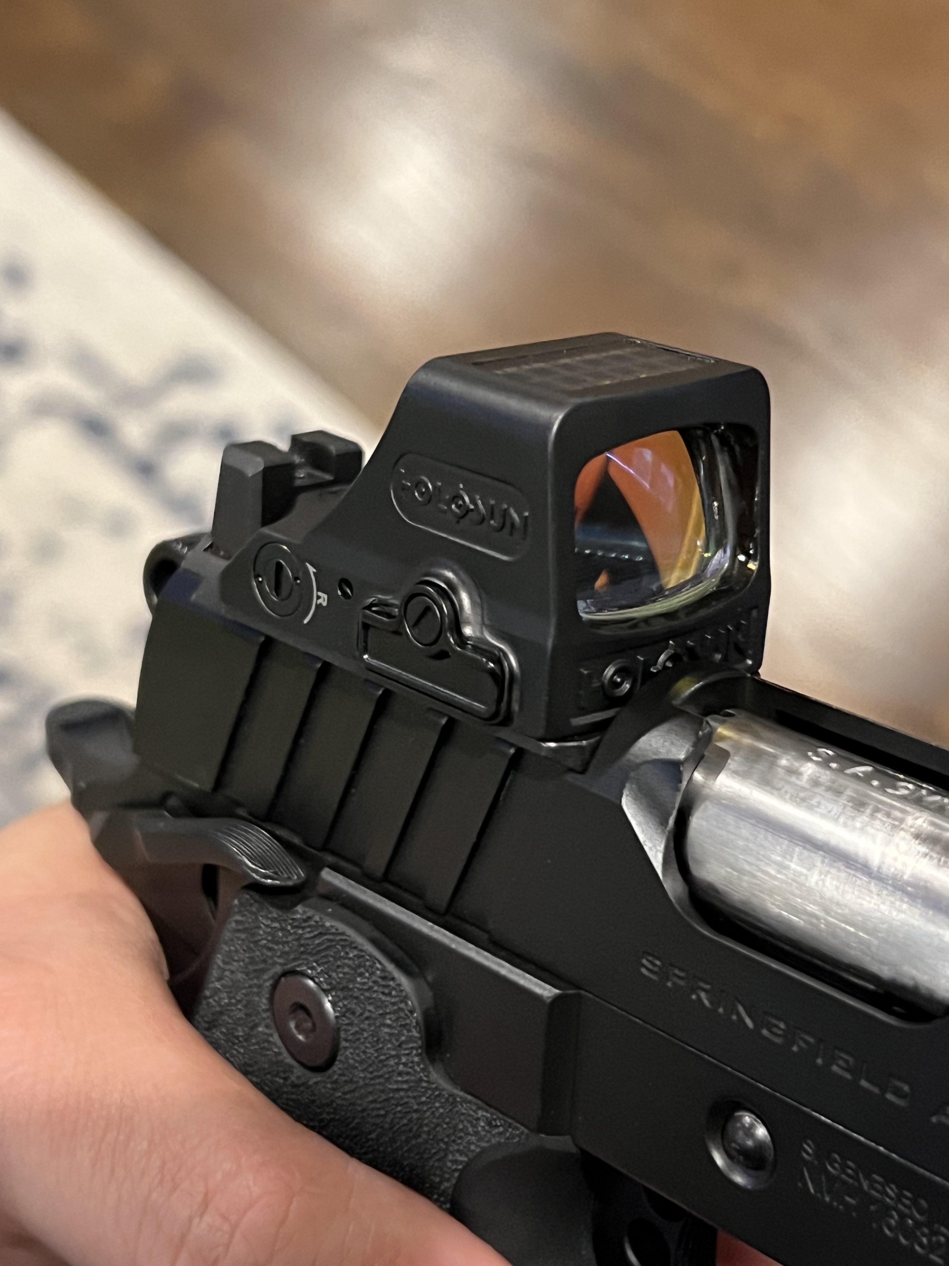

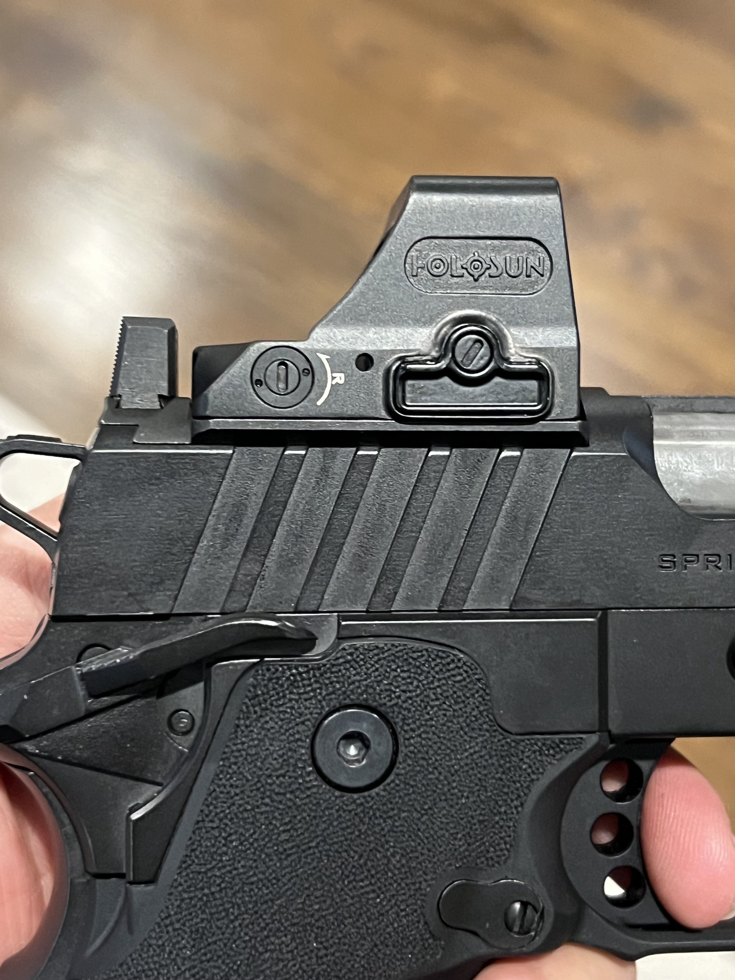

I received my mounting plate and installed a Holosun 5O7 C on my Prodigy. I used the smaller screws, the larger screws did not seat; too long. It says on the store website on the mounting plate section that the screws may need modification. Am I good with the smaller Holosun supplied screws?
I would imagine they should be fine, as long as they tightened down and nothing is loose, just don’t over tighten them, read here they can strip out or break
I put on a 508t and test fit it off the gun and the short screws were like a half tun from being flush when snugged, not torqued. So I would assume the when you torque them the spec, they are the perfect length. I torqued them to 18 inch pounds and everything looks and feels good.
