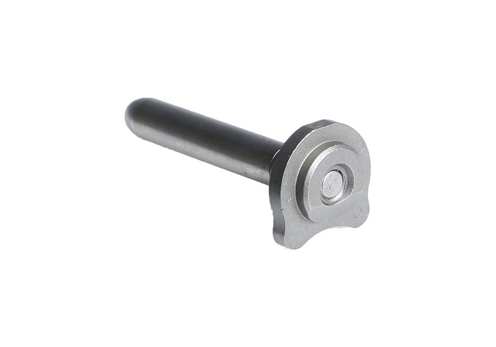

The only 1911 I own with a captive recoil spring is an old SA Ultra-Compact. It requires a small plastic piece that fits on the guide rod to field strip. Thankfully, when I asked, SA was kind enough to send me two of them free of charge. (y)
However, the gun is still such a PITA to field strip that a very rarely shoot it. :rolleyes:

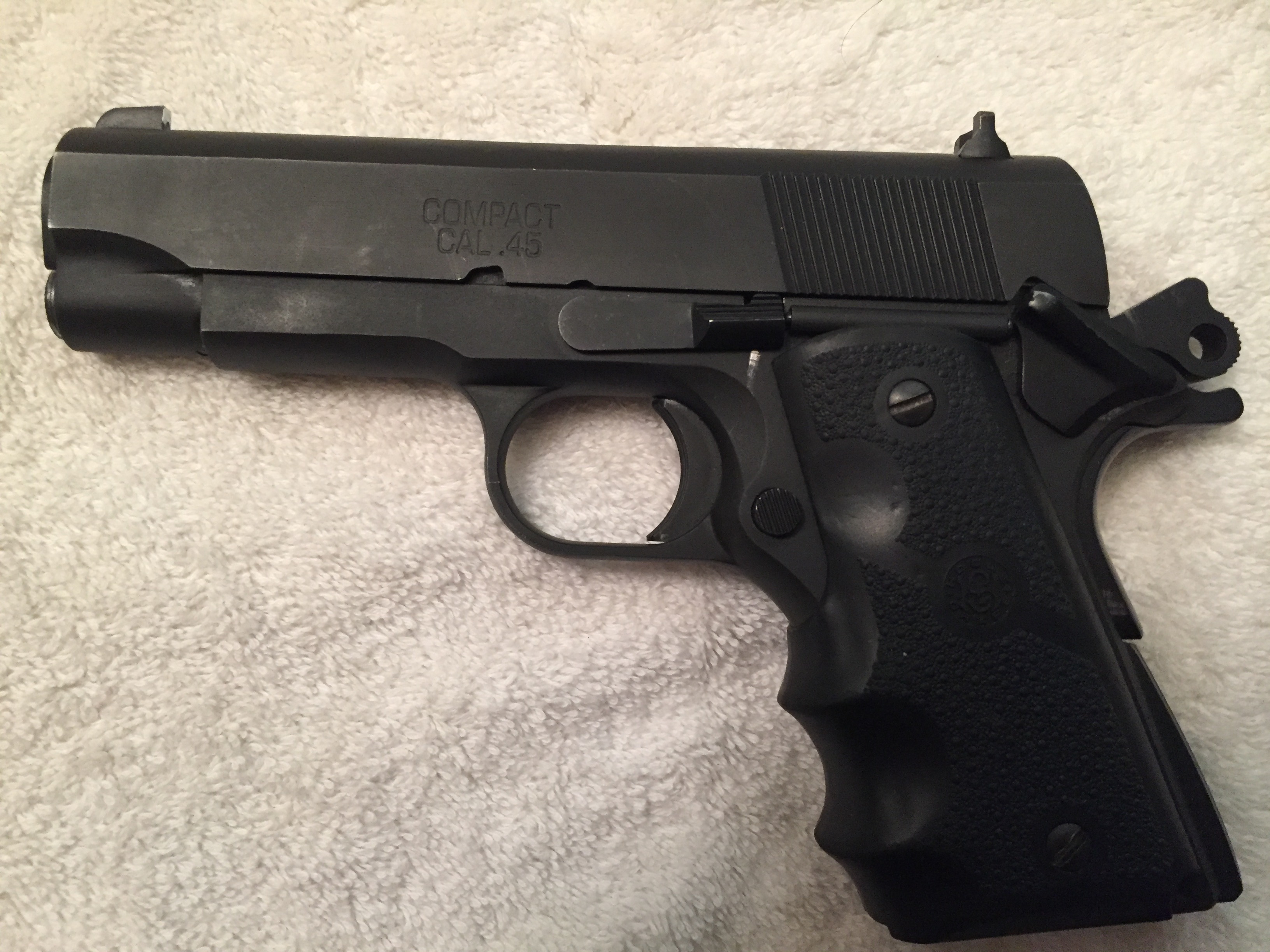

i have 1, 1911 with a long guide rod, i cannot recall which one right now.
i find it easy to remove the spring from the front, then the guide rod comes out like an ordinary one would.
i think my Sig STX has a guide rod that comes in 2 pieces, and yeah, it'll start to come apart, but not fully..
i don't know why they did that.
yup, it does, and it's not a long rod either..
