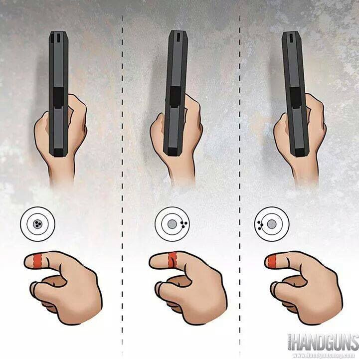

Finger placement on trigger is a variable that will necessarily change depending on the strength, physical size and other anatomic variables of the individual shooter's hand, and how those factors interact with both the physical dimensions of the gun and the specifics of its trigger path.
"How much finger" Steve Fisher gives a 1911 will be very different than how much finger Earnest Langdon places on DA/SA Beretta versus Tatiana Whitlock on a Glock.
The idea is to "finish flat," and how any one of our fingers achieves this with any one specific gun is something that is individually determined and unique.
This can even be affected by personal preference:

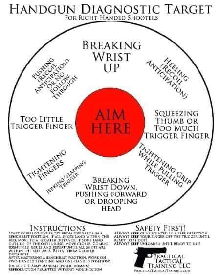

^ "Correction targets" such as this needs to be used with caution.
One big thing to note is that these were originally spawned from single-handed Bullseye shooting at the 25+ yard line.
Using both hands as well as using the targets at closer distances can both introduce significant confounding factors into the target's interpretation.
Factually, relying too heavily on this target is often one of the biggest reasons why shooters making certain errors get stuck in a rut - they try to correct what "the chart/target says," when their actual fault lies elsewhere. ( Here's an article by the late ToddG on P-T.com about the use of this target, with a few other very important considerations to keep in-mind: http://pistol-training.com/archives/292 , and yet another - https://aegisacademy.com/blogs/test-blog-post/pistol-correction-chart . )
If you're using the chart/target for corrections and you notice that you're not making any improvements, I would urge you to stop - and instead seek out live help from a good instructor or otherwise capable shooter instead, as you'll quickly find that the money you're spending in range-fees and ammo will rapidly approach the cost of a simple session with an instructor or class tuition.

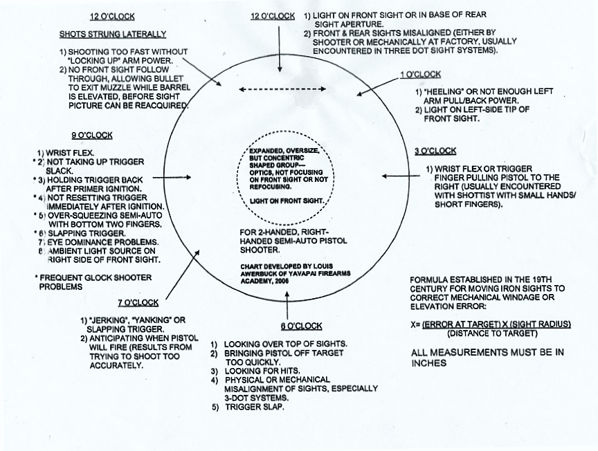

There's also a more detailed target/chart that addresses potential vision/lighting induced issues, below:

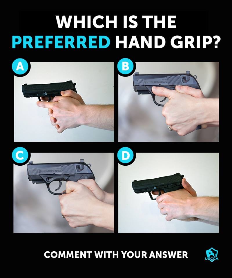

Ideas on grip:
In my opinion, the primary purpose of grip is to control recoil for a faster follow-up shot. We want to maximize skin to weapon contact so we can mitigate the recoil. While the grip is valuable, I don't think it is as important as trigger manipulation for accuracy, unless you are competing, which still doesn't place it as important as trigger manipulation. IMO.
My other issue with perfect grip and stance is that it mainly only applies on a flat range world. This is great if you are learning to shoot, learning a new weapon, or just testing accuracy. If you are in a life and death situation, you better be getting to cover, and learning to shoot in ways that aren't vertical. When practicing these you suddenly have a slightly modified grip that doesn't allow you to square your shoulders. It feels awkward but is something you can get used to and should. Practice shooting around barriers whenever you can.
Finger placement is another thing that seems to cause some issues. I index my finger differently on different pistols. On my Glocks I place the trigger almost to the crook of my finger, on my xdms I place the trigger in the middle of my finger. I learned to notice what my finger placement was doing to the gun when I pulled the trigger. The best way to explain this is to watch the Pat McNamara video from above. You want the trigger to move straight back, otherwise you are pulling your shots one way or another.
