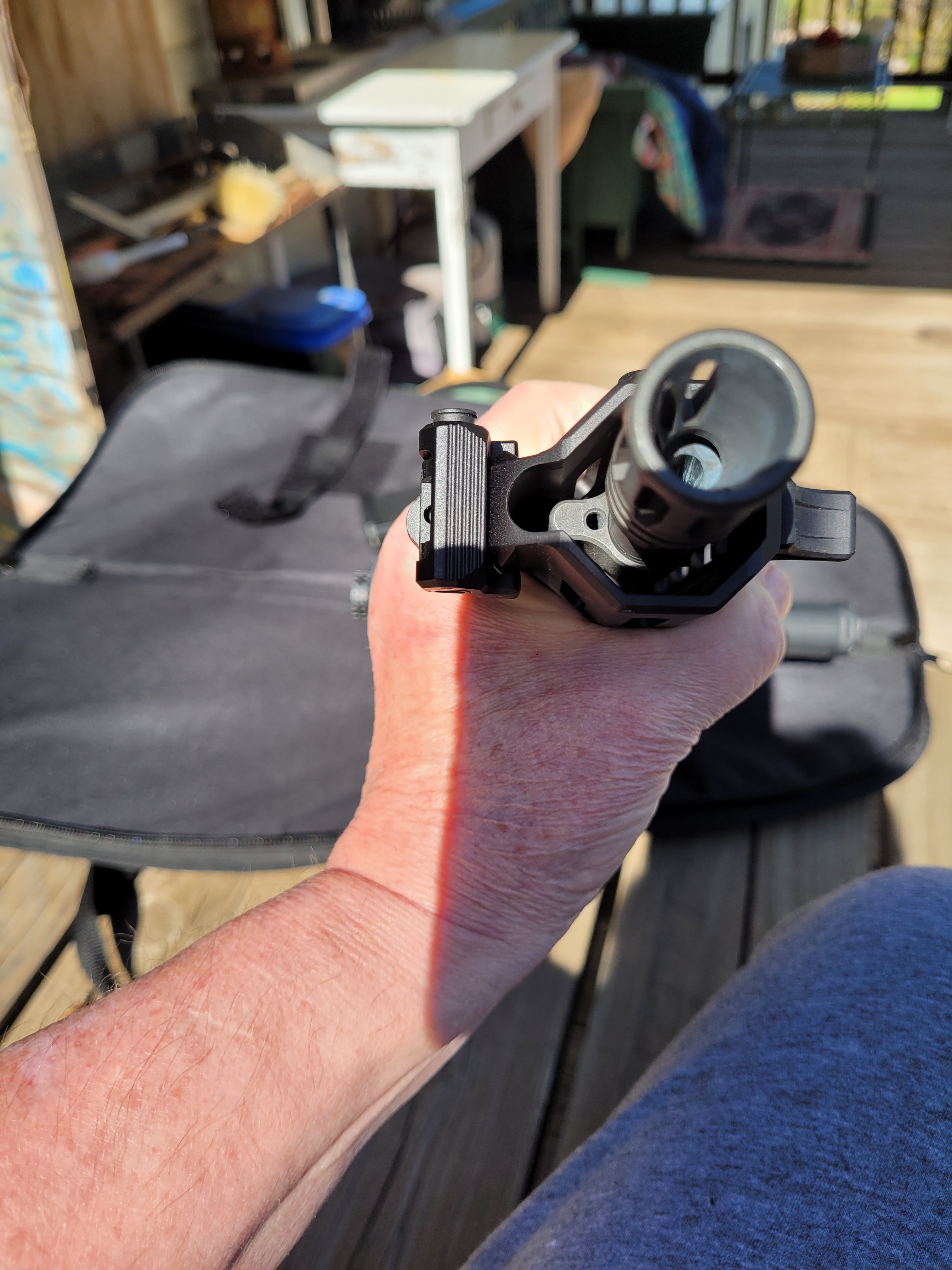

I have finally had time to try and adjust this. I was expecting a set screw. If I put the T wrench in the hole looking for a place to set it, there nothing there for it to fit into.
I would suggest you call Springfield Armory, give them your serial number and ask them if the gas block on your AR Pistol was built with an adjustable gas block. According to there website it should have been. If they say yes then you are missing the adjustment set screw. If they say no then this is another example of Springfield changing out there builds based on availability of parts. I owned a SA Victor Pistol in 300BO And it had an adjustable gas block. A friend has one in 5.56 and it also has an adjustable GB.
I called. Yes, it is supposed to have an adjustable gas block. So, I am going to have to pack this thing up and send it back. Like I said earlier, I am a complete novice when it comes to this AR business. This is the first one I have ever owned. Very frustrating for a newbie except for the help of people who have a clue :)

My take on this is it does not need to go back but that’s your decision. All you need are the set screws that thread into the gas block, they should send you those, you can install them easily. Here’s something to think about, if they sent you the T- Handle then it should have had set screws to adjust.

Sorry late to the party , I looked at your pic and it looks like your set screw is missing .
I got the Saint Victor .308 rifle And had the same issues as you , Fire wouldn't cycle the BCG and load next round , tried different grain ammo still same problem . Got home and checked the the gas block to change out the adjustment screw and it was missing , looked up the size , I think they are 3/32 , went to Home depot bought two screws for .60 cents . Put one in and worked perfect . Called Springfield and said their Quality missed this . i wasn't really happy at this time. But they sent me new set screws and such . No problems ever again . So your not alone with this issue ..Good luck .

They did send the T-handle and, I don't want to send it back. Thanks for the advice on this. I mean, I have a scope on it, zeroed in, I don't want to send it back.

Thanks for your input on this. I am not going to send it back. Ignorant as I am concerning this type of gun, even I thought something was missing here. I can put a screw in and I will do it myself.
