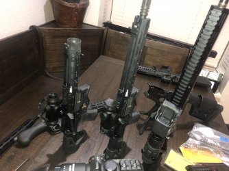

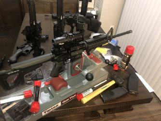

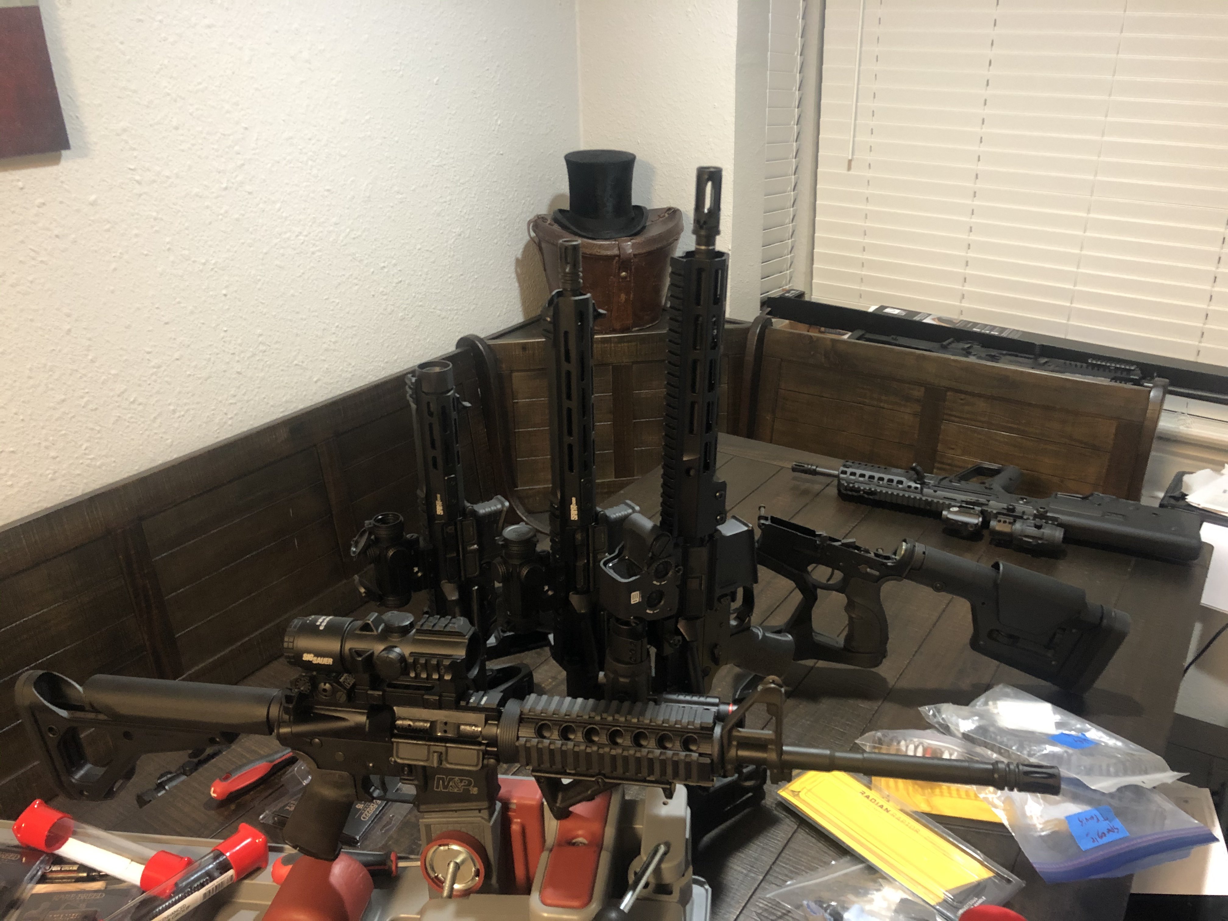

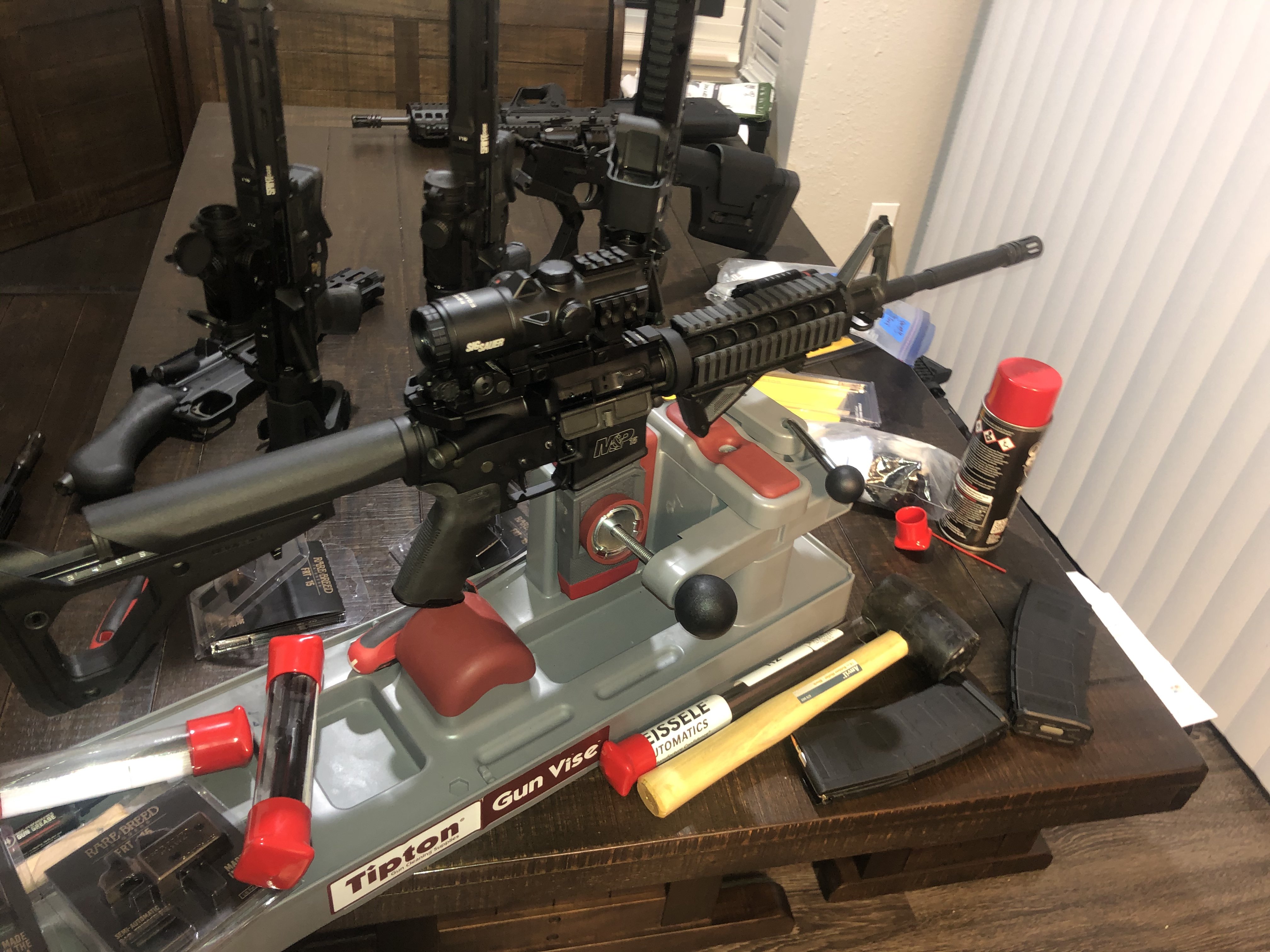

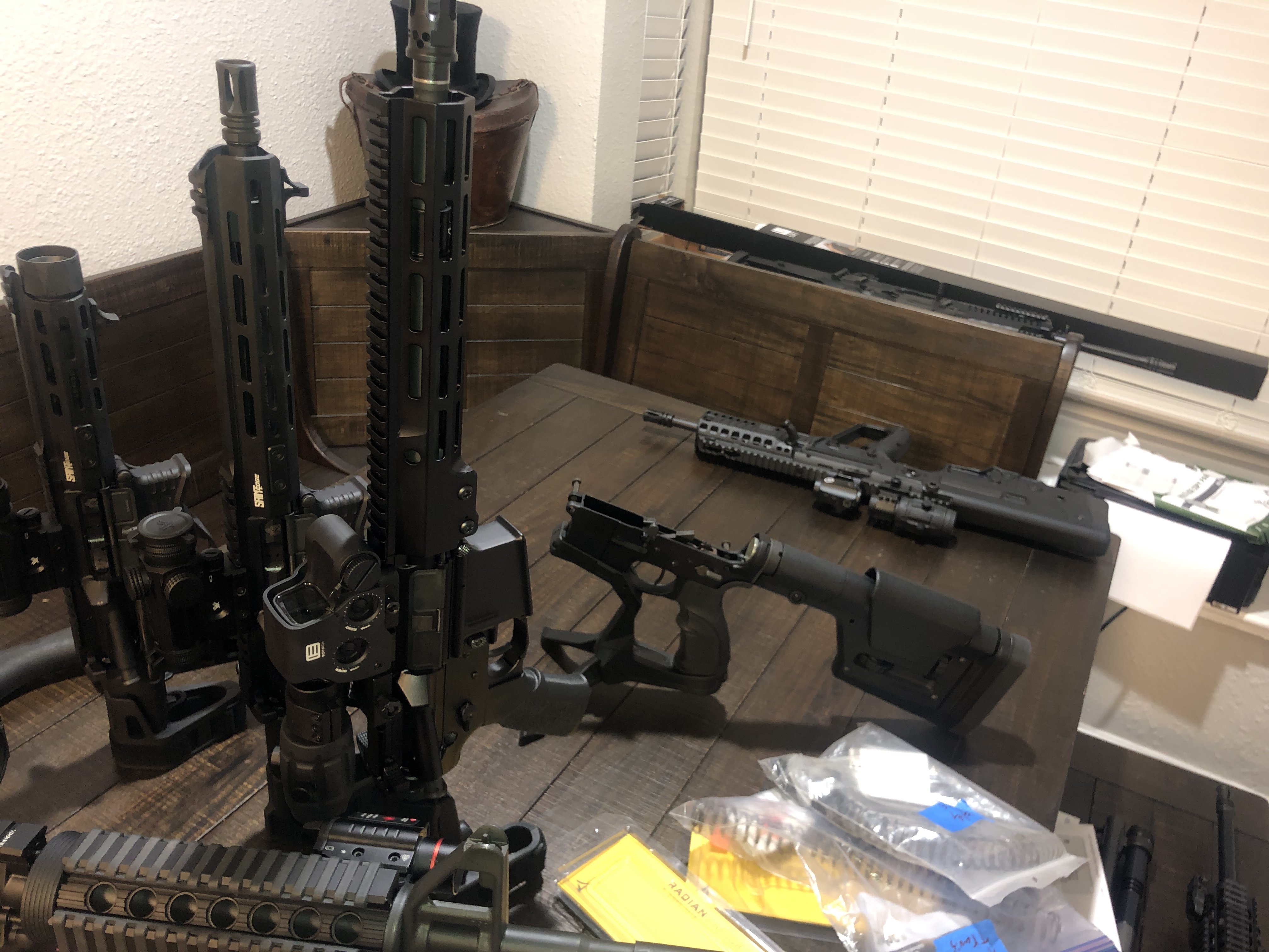

Gentlemen, for the sake of science I have taken one for the team and upgraded two rifles and an AR pistol with Rare Breed triggers, and have a fourth in reserve for a gun I’ve yet to build from scratch.
I also have added Franklin Armory Binary triggers to a Saint Edge pistol and Edge PDW.
Stay tuned for field and range reports.
The M&Ps in this experiment are not the basic Sport 2, but the law enforcement M&P 15X with a chrome lined 1/9 Thompson/ Center barrel and M&P 15T with a 1/8 5R rifled Thompson/Center barrel. Both are upgraded with Geissele bolt carriers and Geissele H2 buffers and braided wire springs to handle the demands of the Rare Breed installation.
The pistol with a Rare Breed installation is a Geissele Super Duty 11.5, with a Daniel Defense 1/7 barrel, and Geissele everything, including H3 buffer and braided wire springs.
