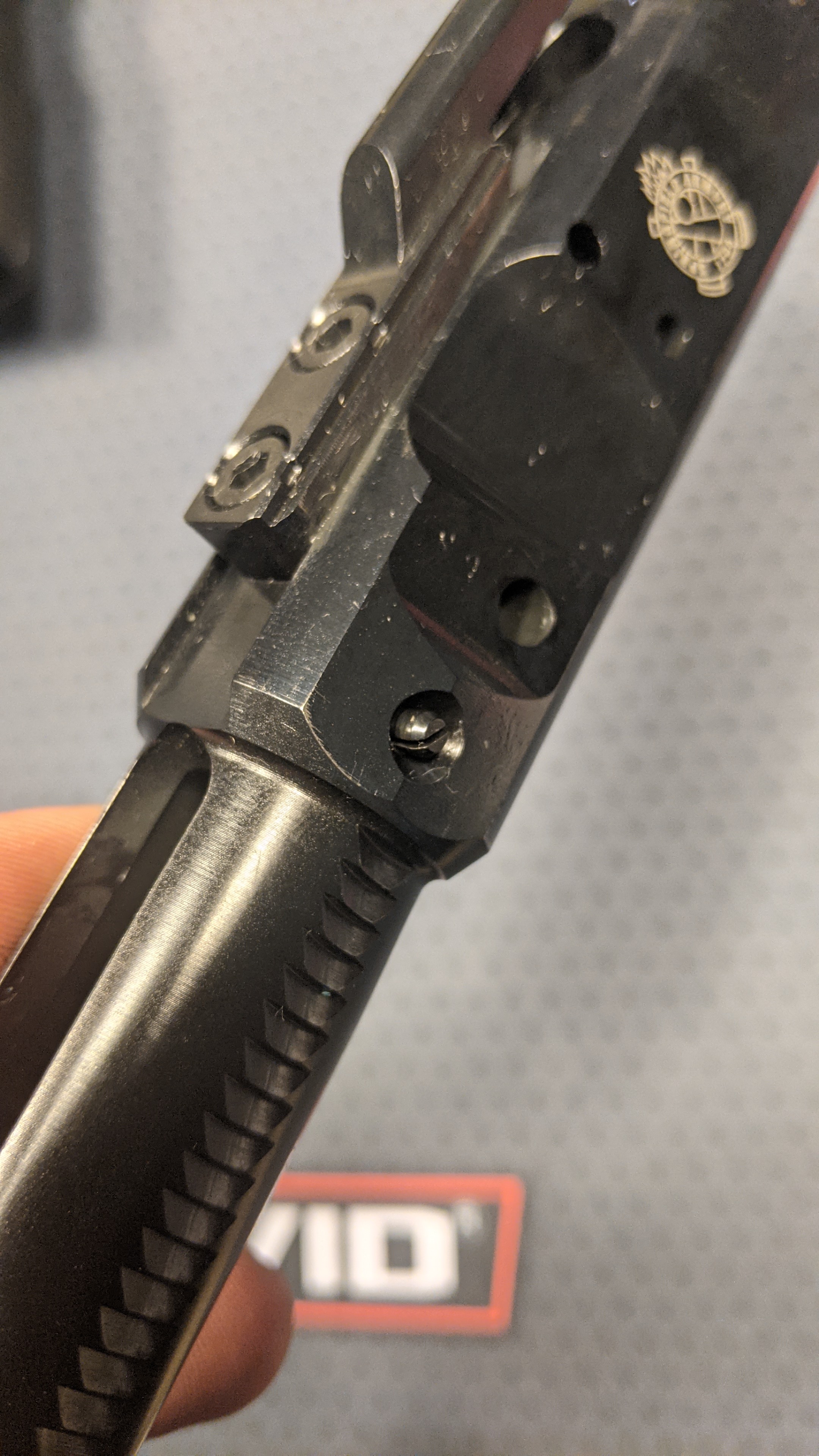

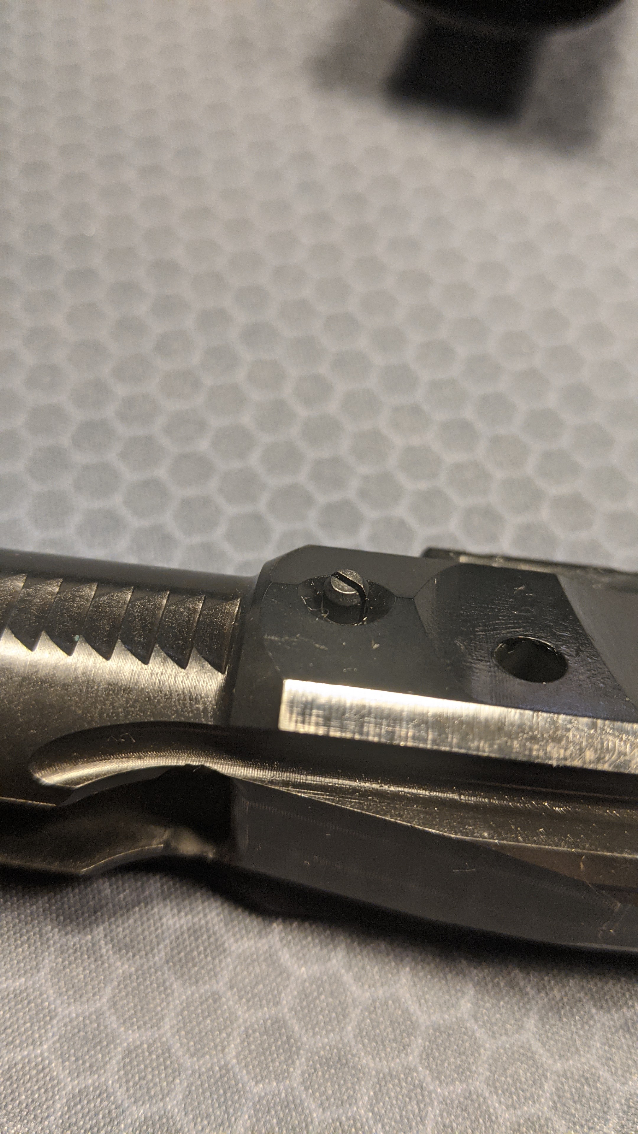

Here is where i'm a bit confused or unsure if this is normal. This is the first time im taking it apart and the firing pin retaining pin looks like it was inserted the wrong way compared to any other AR i've taken apart or seen taken apart in a video. There is no loop to grab it from or to take it out. It's like they inserted the loop end into the carrier and left the split pin end exposed, to which I cannot for the life of me grab it or pull it out. Here's some pictures, Is it just me, or is this something I need to warranty? I can't clean this thing because of this and its just absolutely not functioning because it looks like it needs to be cleaned and lubed.

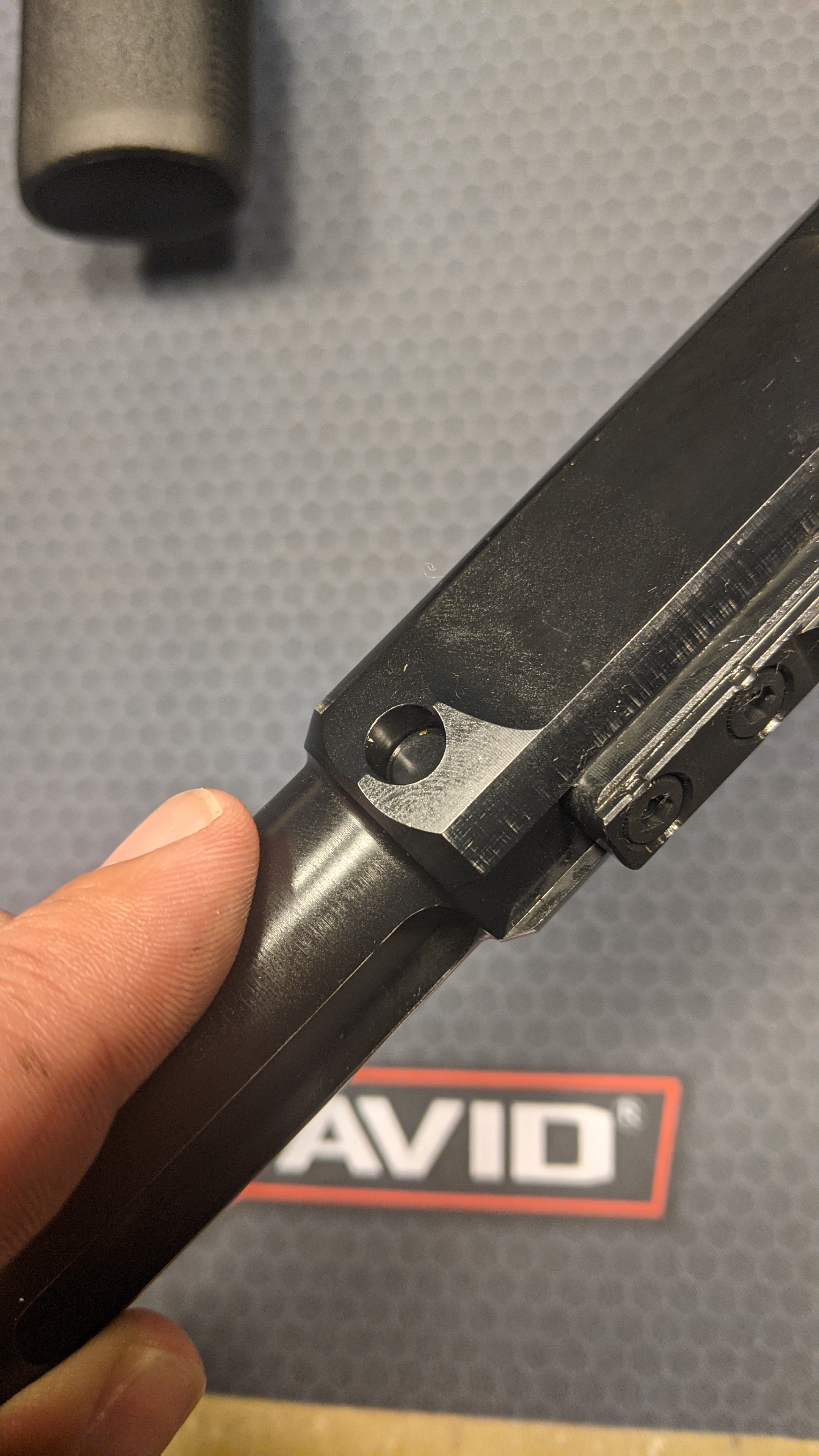

It's only normal if it's a " Perma pin" and even then it's sticking way too far out of the carrier. Look at the other side of that hole on the carrier. If you see a flat, round head tucked into the hole it's a " Perma pin. You should be able to use a punch to lightly tap the retainer out. Go from the side you show in your picture and push the pin out the other side.
Before you start, if you would, take a picture of what that hole looks like right now on the other side of the carrier.

That's the otherside of the carrier. If it seems a bit too far out its because i pushed that block in a bit trying to making it stick out enough so i could pull it out.

You're pushing it out the wrong way. Like I said, throw that thing in the garbage can and get a regular cotter pin retainer. Then clean and lube your rifle and go back to the range. Keep us posted.

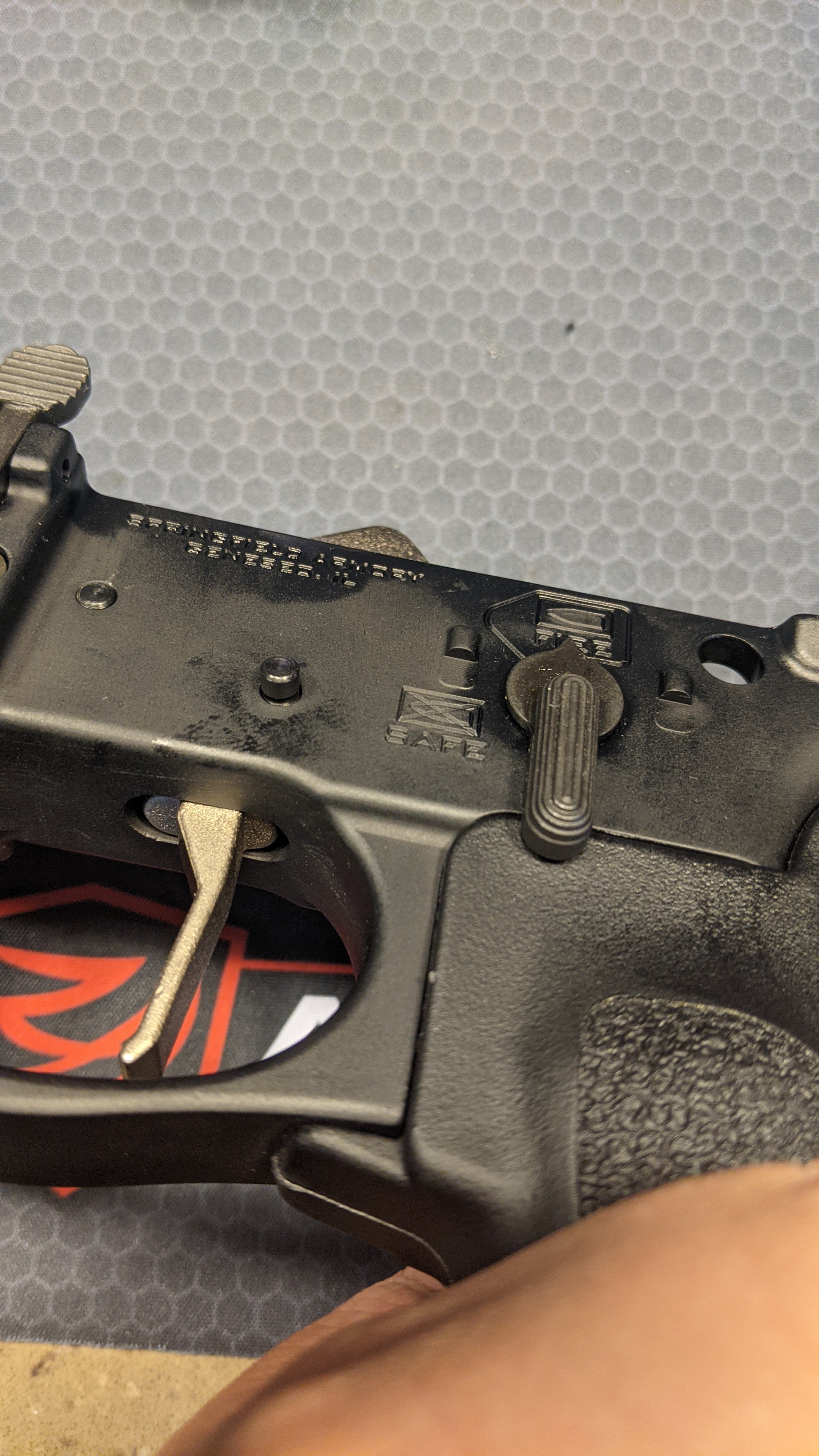

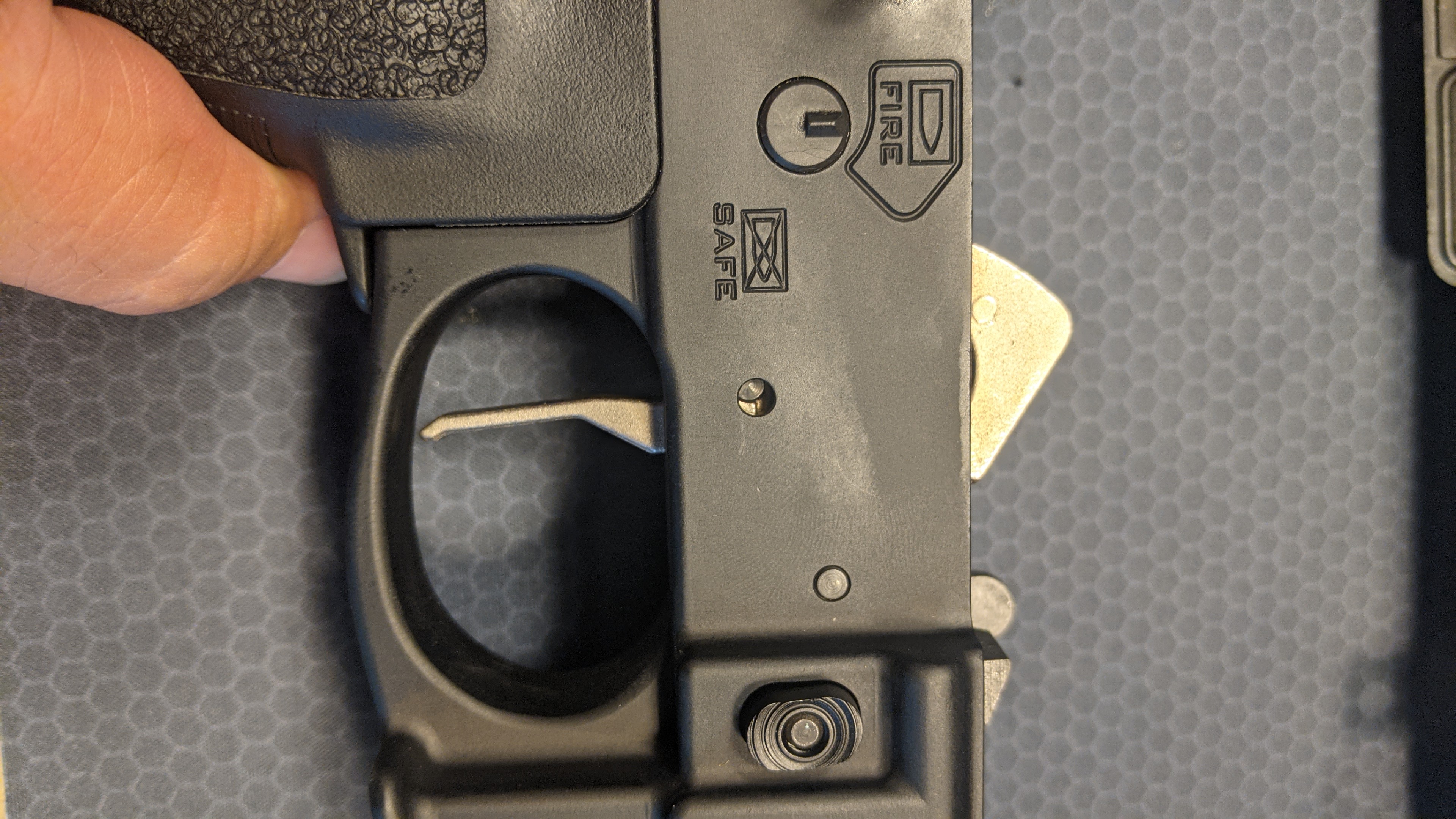

It's reassembled now and the trigger seems to be seized. BCG seems to be fine, charging handle fine, I can lock the bolt back and slide it forward with the bolt lock/release. Trigger does not pull, this happened at the range yesterday and I just assumed it was from the jams/needing to be cleaned. I think I have a major issue on my hands.

I assume the safety is not engaged ?

Have you opened the lower to see if the trigger works without the upper attached? You can push the hammer back into the firing position, though I do advise you do not dry fire the hammer into the receiver as you can damage the receiver. You can depress the trigger and ride the hammer with your other hand to check function.
