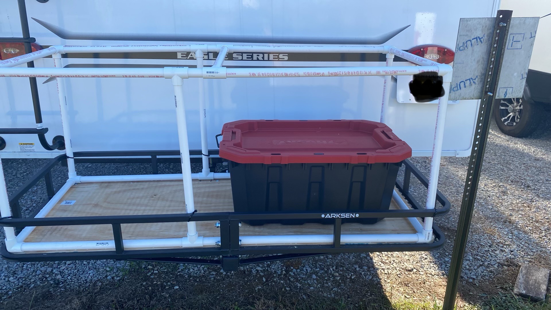

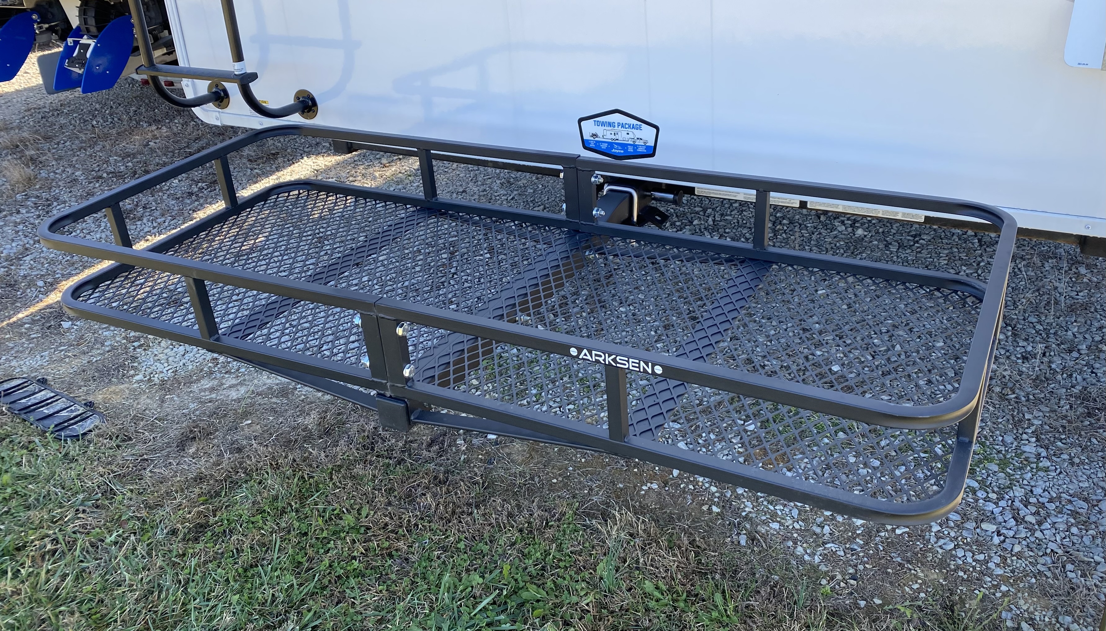

The RV has a frame mounted hitch with a 3000 pound towable rating and a 300 pound hitch weight. Although I won’t be towing anything behind the camper I’m using the hitch for a hitch mounted cargo carrier. “Basket”

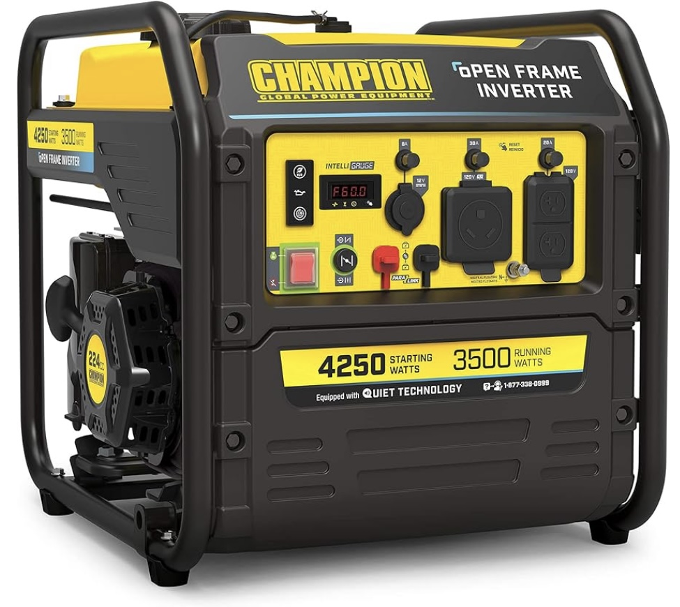

The basket will hold the Champion Inverter/Generator which is rated at 4250/3500watts and pushes 30amps to run the lights, entertainment CTR and the AC unit. Most everything else runs on 12volts including the refrigerator.
The RV is set up to run on 50amp shore power but the Generator will be perfect when no shore power is available when boondocking.
This is an open frame Generator and with the Inverter built in it is susceptible to damage from water so I installed a 3/4 inch sheet of plywood on the base of the basket to prevent water from splashing up into the generator during travel.

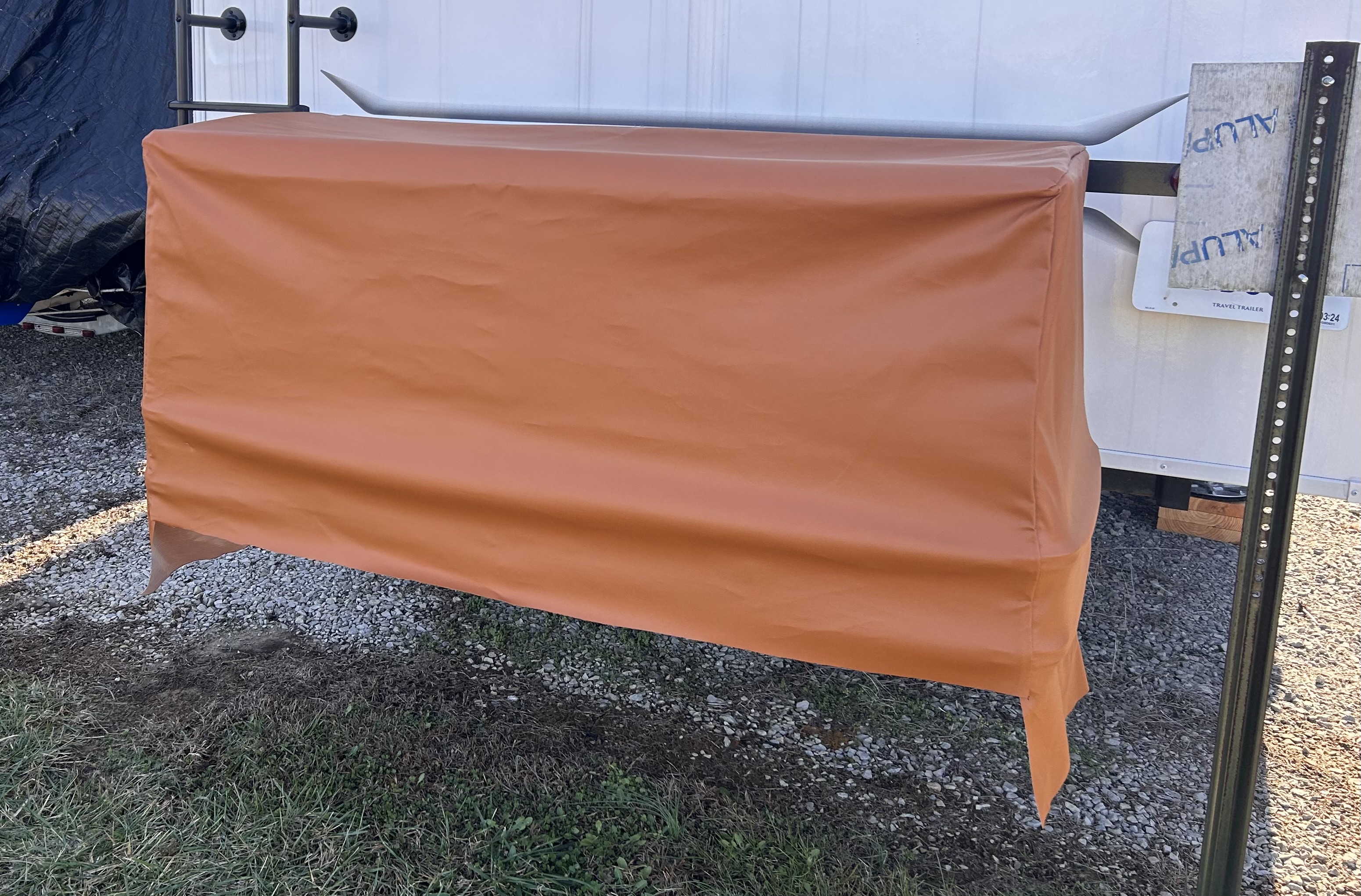

I then picked up 1 inch PVC pipe and fittings and made a “cage” to support a vinyl cover I’m in the process of sewing together to fit over the cage.
The tote is screwed down to the wood and will be used to hold my power tools.
The RV is set up to run on 50amp shore power but the Generator will be perfect when no shore power is available when boondocking. View attachment 48435
