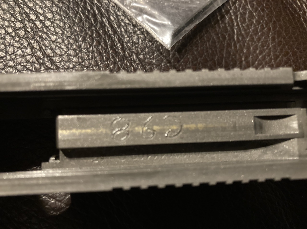

The new Loaded was tight, like, super tight. I expect after breakin, it should be a solid shooter. We only got to shoot one mag each due to the rain. Not really aiming at anything special just function testing. The Kimber, despite only having just half a box of ammo through it, ram fine. The Springfield had 3 FTF and didn’t lock the slide on the last round. That prompted me to disassemble it and look deeper.
Turns out, there are numbers hand engraved on the bottom of the slide. Those numbers have raised edges, which have to pass right over the disconnector. It’s causing enough drag that the slide doesn’t have enough umph to strip a round about half the time. That’s got to be fixed before it ruins the top of the disconnector. It’s got constant upward pressure on it and those engravings a chewing away at it. I think it may be going back to Springfield as well but the jury is still deliberating on that. I’d like to at least do a quick accuracy test before I call them.
Picture of the stupidness…
That area should be pretty smooth given what it does.
It actually pains me a bit to have to write this stuff as I am a big fan of Springfield Armory but these are some pretty big blunders in my book.

Hmmmm I never thought to look to see if there is numbers engraved into that area of my Emissary 45, I’m going to the range this morning with my M1A but when I get home I’m going to look.
I will say the fit between the slide and frame are incredible and not rough at all.

Yeah, that’s a build number, and it’s a pretty common spot to put it. A lot of manufacturers do it.
It’s really not going to cause a problem…that’s a whole lotta noise about very little signal, there.

i have several guns with numbers engraved on that part of the slide. many of my guns were bought just before the pandemic sales frenzy, and during and after. if any maker was concerned about the connector wearing out, i'd imagine they wouldn't engrave anything there.
in regards to the "roughness" of the action, it is usually a good idea to take the gun(s) home from the store, strip them, clean and lube.

That area has little to nothing to do with what your thinking it does, that’s just where the disconnector rides, smooth, rough makes little difference there since the disconnector is spring loaded, also the bottom of the rails also means little or nothing, lots of 1911’s are like this, normal

Just to be clear, when I reference grit and roughness, they are different things in my mind. Manufacturing debris I consider grit. Lack of smooth surfaces after cleaning is roughness in the action. Field strip and clean is pretty normal procedure. Having to remove the trigger and sear isn’t normal. Those areas can usually be flushed with a spray in cleaner and oiled. Of the 80 or so handguns I’ve purchased in the last few years, the first Kimber Stainless II I bought is the only gun I had to go to that level.
As for the engraving on the bottom of the slide. I’m not going to pretend I’ve encountered every brand/model out there but I’ve had a few RIA, Citadels, couple Springfields, Kimber, S&W and MetroArms. None of them have engravings there. Not even the other Loaded. I can tell you that the end of the disconnector is pretty chewed already from the little action it’s seen.
You just stated it does exactly what I think it does.
I don’t know what you mean by the bottom of the rails. If you are referring to the bead blasted Kimber rails I referred to, I am not talking about the bottom of the rails, the entire slide rail, including the channel the rail rides in are bead blasted. It does make a difference when breaking it in because those two surfaces have to essentially sand each other down during breakin. Makes a lot more metal byproduct during the breakin, enough that it causes the gun to start having failures to feed after about 50 or so rounds. Extra oil and working the slide a few times will free it back up and function normally.

I am not going to get into a he said issues here, all mass produced guns will have some roughness and maybe, just maybe some small shavings, that’s quite normal in a mass produced gun, any manufacturer, I don’t dwell on small things like that, after break in, this goes away, I never tear down any of my 1911’s looking for this, I clean them, lube them and try to get them broken in, so in ending, I will comment no more, enjoy your guns, 1911’s can be addictive
Also understand guys, it seems like I’m nitpicking, because I am. With two manufacturers so very close in quality, nitpicking has to be done. I think both were high enough in quality to buy multiples of the same brand/model.
