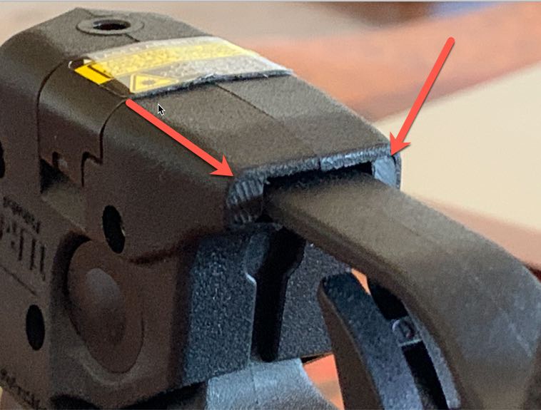

Wanted to chime in here since there is not a lot of info out there or exactly what works and what doesn't on the Hellcat. I have a Hellcat OSP and just fit a TLR-6 onto it. While the TLR-6 will mount on the rail and wrap around the trigger guard, the trigger guard of the Hellcat is too narrow and you get side-to-side movement of the TLR-6. I ended up fabricating some small plastic inserts to take up the slack and now it's rock solid and seems to hold zero just fine.
I also have a Viridian CL-5 that I tried to fit and it did not grip the rail well so as much as I like the CL-5, the TLR-6 is a MUCH better fit for the Hellcat.
Before
After
