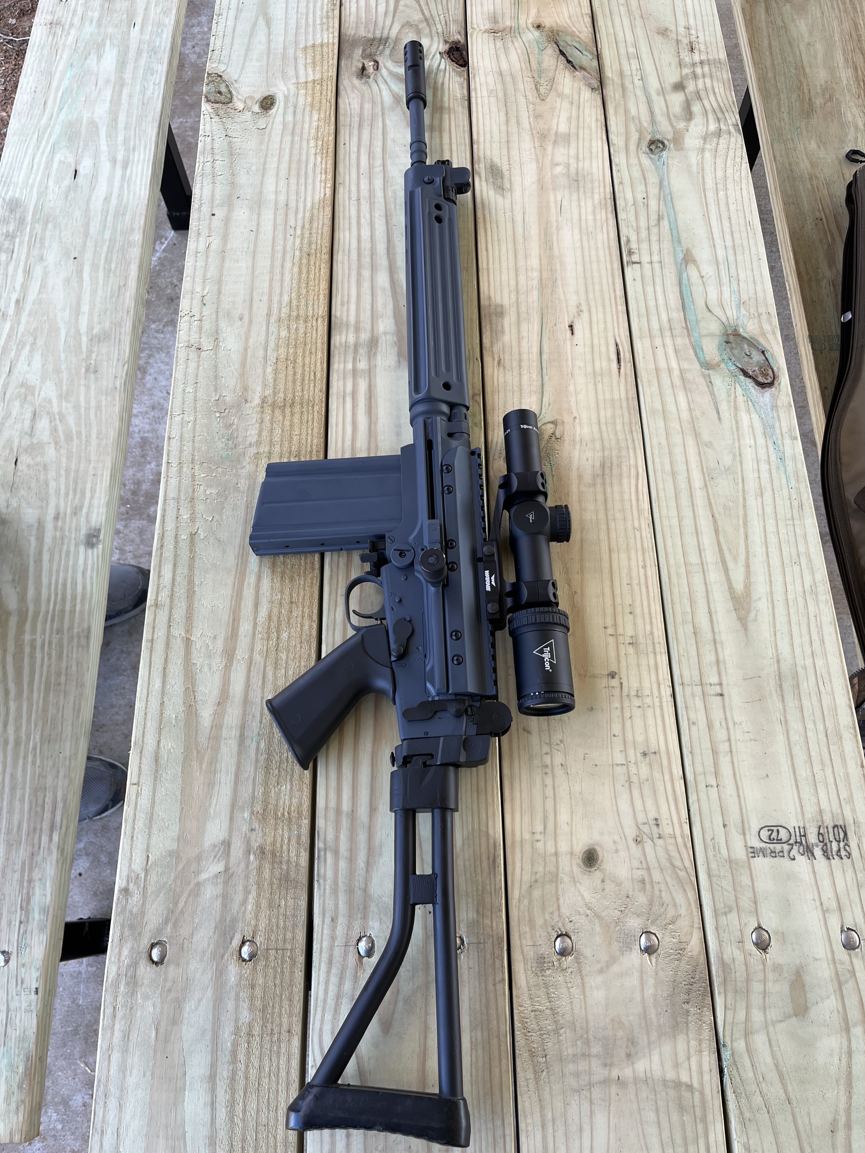

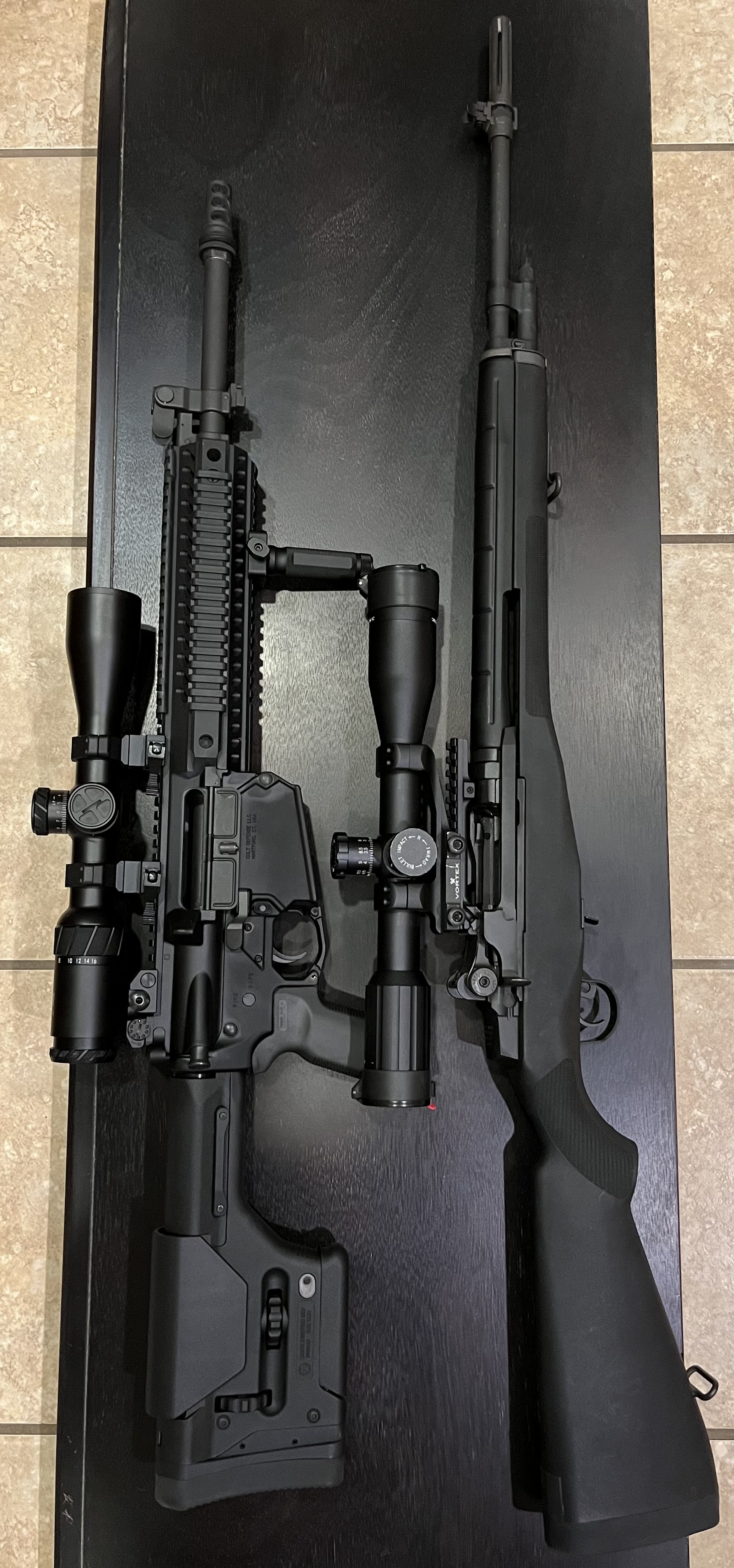

I run a 1x6 on a FN FAL and a 4x16 on my other .308. A 10x on my M1A.
I use the M1a for distance only.
Fal and AR10 for close to mid range out to 150-200

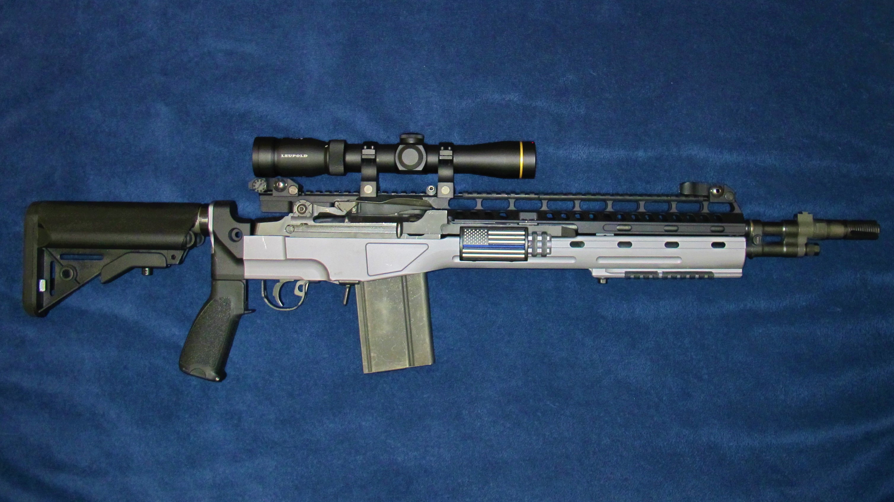

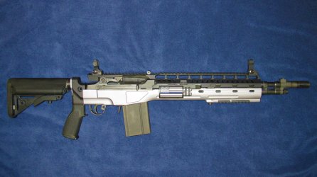

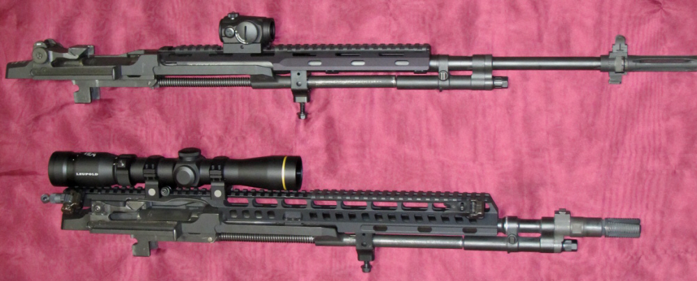

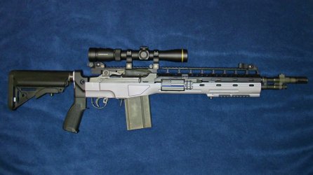

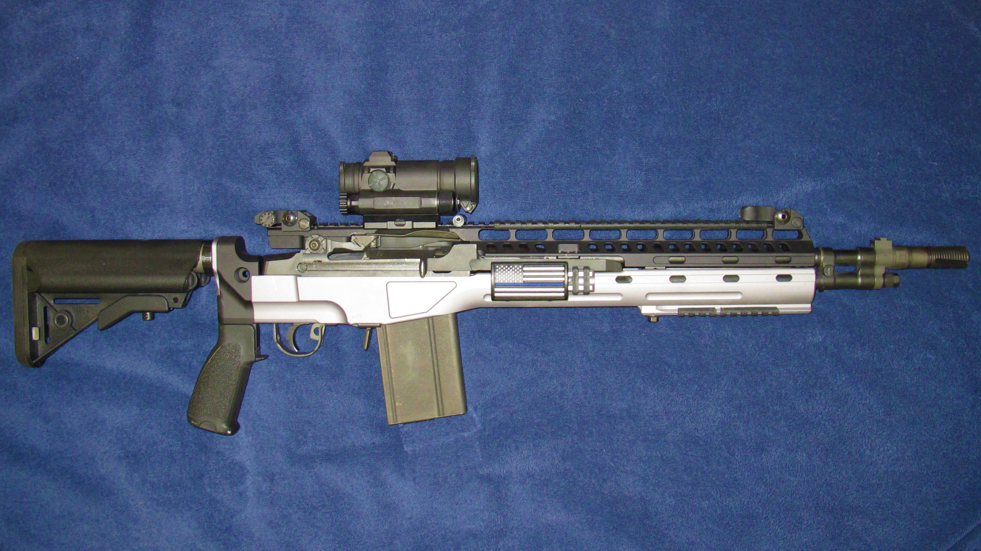

Blackfeather offers a few different CASM scope mounting solutions, the SHG has an Aimpoint Micro on it and the LSP has an assortment of aiming devices on it. Both styles work with standard stocks.
