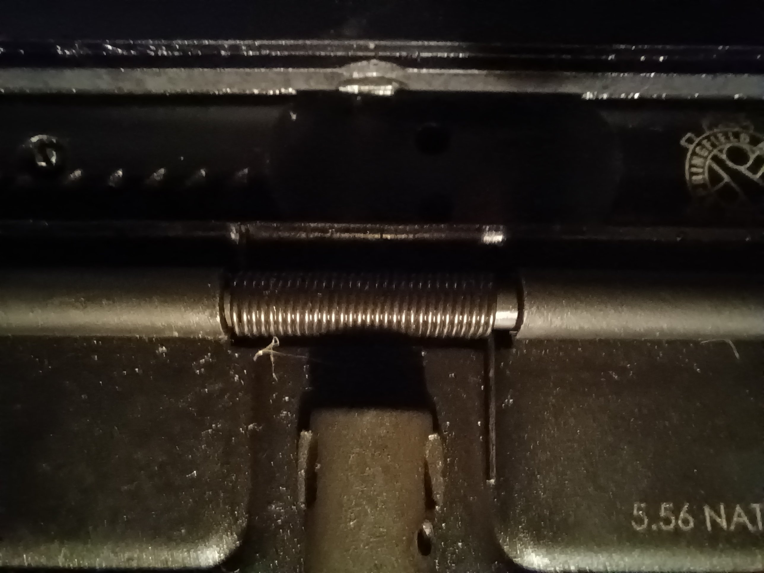

Ok,
I've put 104 rounds through my new Saint (2-54 round sessions one week apart). After getting home from the 2nd session, I cleaned my rifle, but noticed the ejection port cover wouldn't close. I could only close it by inserting a narrow object (like a paper clip) to depress the detent, then closed the cover. Upon pulling back the charging handle and locking the bcg in the rear position, I found when I can only describe as a simple in the ejection port that aligned with the port cover detent. See attached photo. (Dimple is in top center of photo). Not sure how that happened, or how to repair it. Springfield said to send it in for inspection and warranty repair. Any thoughts on how that happened? I don't have the slightest idea. Thanks for your input.

Check the spring for any breakage? I had a spring that would hang between the cover and the receiver that kept it from closing. On another note does the cover spring open fast when closing as much as possible then letting go? If yes then like @Talyn stated it could be a bent cover or rod? If ir doesn't spring open fast the small end of the spring could've popped on the wrong side and will bind at the bottom and will make it hard too close. Can you push down on the tip that keeps it closed when cover is closed?

Thanks for the replies. Sound like a metal weakness. I'm not sure if I'll send it in, as turnaround time is quite lengthy given how quickly that simple can be Dremeled smooth. But doing so, may create the problem again if it's an aluminum alloy weakness issue.

I'll check the springiness of the cover and get back to you. Once I get the cover plate closed it looks and works like it's supposed to.
The ejection port rod is either slightly bent so the cover closes abit too far up for the detent to work properly, and/or the cover detent is not freely moving.

Thanks for the reply. Since this is my 1st AR, I'm not sure how stiff the detent spring should be. I can depress it with my thumbnail and it's not freely moving up and down within the assembly, just stiff.

While researching the Victor I saw someone ( a few people actually) mention the same problem. One of them filed down either the pin or the part where it snaps into and it was fine. Another said that he just worked it repeatedly and it eventually worked itself out. One other person mentioned applying pressure to the right or left of it when pushing it closed, like there was a sweet spot. That was one of the first things I checked when I got mine and it was a bit snug but not too bad.
