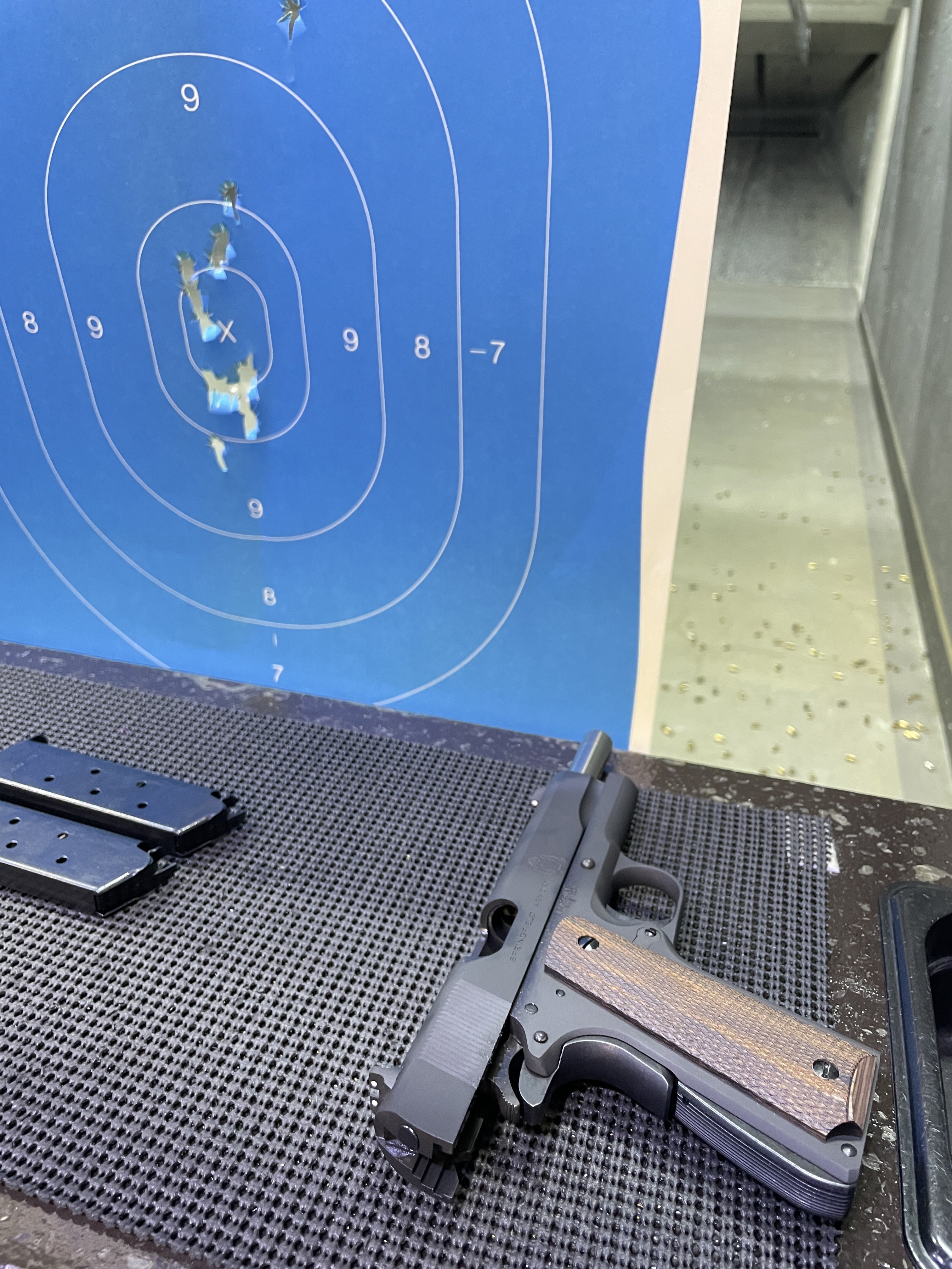

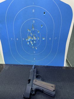

Bought my first 1911 (and first .45ACP firearm) a couple of weeks ago. It’s a new SA parkerized Milspec M1911A1-ish clone. Also got 3 additional SA 7 round GI blued mags, exactly the same as the one that came in the box with the pistol.
Today was the first chance I had to go put 200 rounds through it. Here are my initial thoughts and a question (related to one issue).
First, getting the slide stop back on the pistol after cleaning/lube was a nightmare. YouTube videos and the manual weren’t much help. I finally called Springfield and they told me I have to use a pen or other tool to depress the plunger so the slide stop will click in place. That’s useful info that would have been nice to know beforehand. So much for the “idiot scratch”…I’m an idiot I guess.
The pistol was very accurate. I had never fired a 1911 before, and I was getting tight groups center mass at 10 and 15 yards. Amazing accuracy, and probably I was the weak link.
The one issue was a strange one. Not every time, but probably 1 out of 3 times, when I hit the mag release, the slide would drop too. No issues with the slide locking back when empty, and no failures to load or eject. Anyone ever see the slide drop after locking back when ejecting an empty mag?
Not terrible for the first time ever shooting a 1911 or .45ACP.

I'm willing to wager the slide dropping when you eject the mag is happening with one mag in particular. With that mag, the follower isn’t allowing the slide stop to fully lock, and is just barely holding it in place with mag spring tension; when you drop the mag, the slide is released. Another possibility is that the magazine is slightly dragging on the slide stop when it ejects…
Try numbering your mags and see if one mag is the culprit.

Definitely not touching or hitting the slide stop at all when dropping the mag. Paid close attention to that to be sure.
The slide drops fairly easily when unloaded and no mag. Of course the ghosts of 1,000 YouTube videos rose up to tell me I’ll shoot my eye out for doing it. 😁

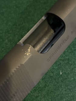

The other thing I noticed is the brass seems to be hitting the slide and has already rubbed away the parkerizing.
The ejecting brass was flying, but I don’t have anything to compare it to. Was using 230 grain FMJ WWB ammo.
Is it typical to see this kind of mark behind the ejection port on these?

Yea, it can happen, that’s why on higher end 1911’s they have this section scalloped out liked in pic I’m showing here, no worries
Also, you also may notice on some 1911’s, the ejector may be slightly loose, especially in the rear of ejector, this to is normal, they are pinned in and won’t come off or get looser just an FYI
