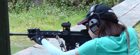

As you may have seen in other threads, my daughter loves her 15-22:
And this was a few years back:
She's grown from having to bench the gun to really tackle those head-shots (that's a Tac-Strike quarter-scale: https://i.pinimg.com/originals/72/e5/94/72e594afb8674815056075b350ebb797.jpg) to being able to hot-dog head-shots cold and on-demand).
The distance limitation on that range is ~60 yards. In the picture of her in her winter coat, she was mag-dumping on the head at the 25. It's easy when the gun has no recoil. :D
If he's not going to really need magnification, you can save him quite a bit of hefting of the gun, particularly if he's young, by going with a smaller/lighter unmagnified RDS paired with a flyweight mount. I wish I had saved some of her paper/cardboard targets for show-and-tell, but particularly with young eyes uncorrupted by disease (my daughter is nearsighted, those are actually prescription shooting glasses: I'm more talking about astigmatism, which may cause non-itched reticles to bloom as a visual aberration, and make for harder precision shooting until the shooter has mastered proper target-focus and other sighting fundamentals specific to the RDS) and with proper execution of the fundamentals, from contact distance to the 100 yard line, an unmagnified RDS really doesn't give up too much to a LPVO in terms of precision/accuracy, unless the target is really demanding.
