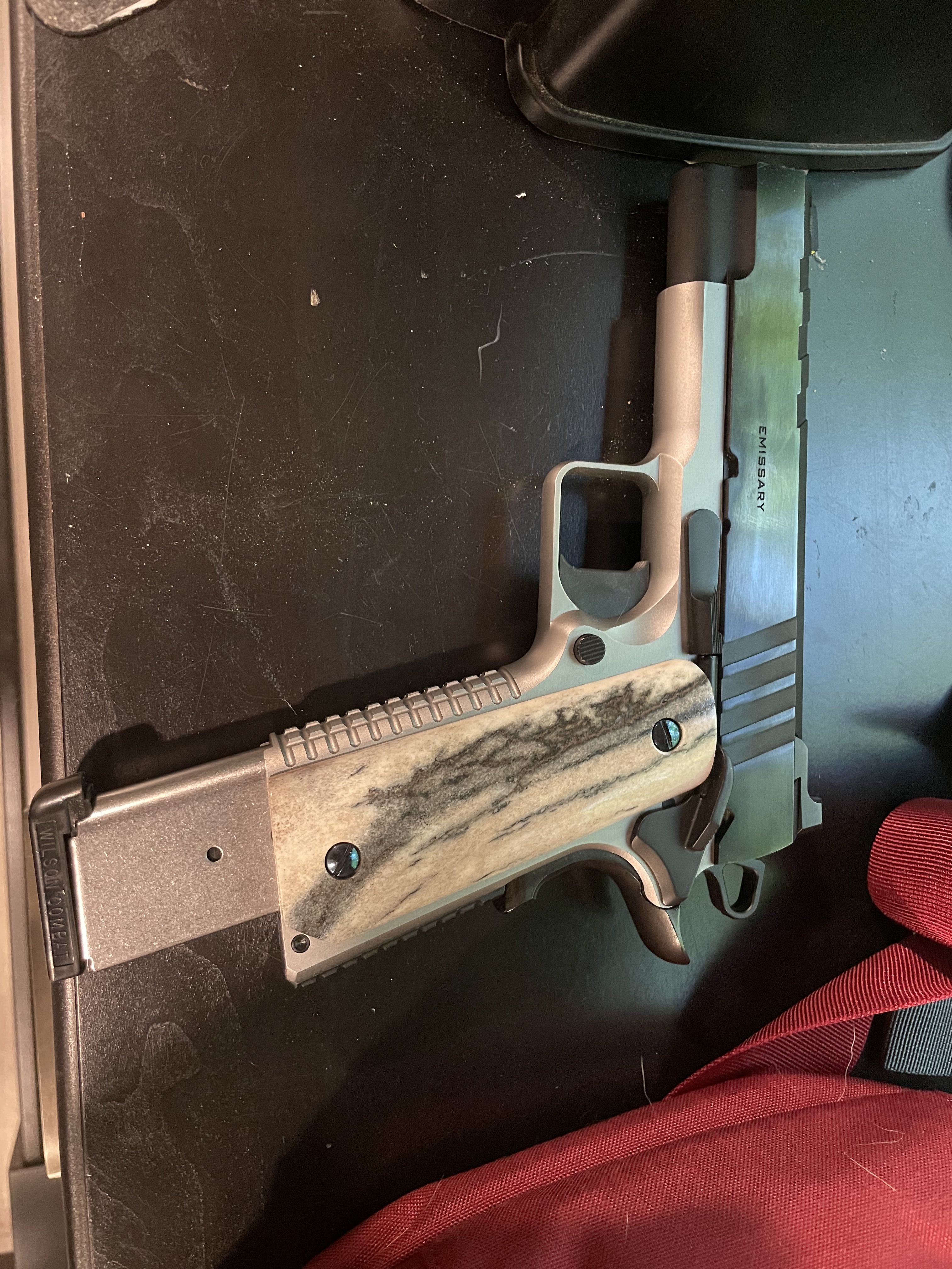

Thanks everyone, sounds like a break issue. The mag slides in halfway then stops at the release, tight enough I can’t push it but does go in with a firm bump. I’m hoping this will improve when I get some rounds through it

My RO Operator was similar to this and it’s a 9mm, I don’t dwell on small things like this, this is totally normal for a new 1911, plus it’s the mags not the gun, the spring in mag is stiff, after it’s used for awhile it will loosen up or just keep it loaded to loosen up the spring,
Plus its the mag release, mine was extremely tight when inserting a mag, it loosened up after use, sorry for my previous post, got mixed up reading this thread and another......:oops:
I agree with what your saying when there are issues with full mags seating against a slide closed in battery because of the round at the top is contacting the slide however with my Emissary that round at the top of a full mag is nowhere near the slide when it hits that resistance when inserting, there is something there that is restricting the mag to get a clean smooth insert, is there something wrong? My opinion no, am I concerned? Not at all.
