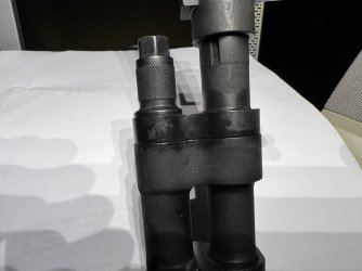

Hello M1A Community,
I took out my brand-new M1A for the first time, putting 200 rounds through it. Everything worked as expected, including nice groups.
Back home, I inspected rifle and noted oil seepage, see attached, around the gas plug. My sense is that it's nothing to worry about, unless it gets worse. Maybe it's residual oil from the manufacturing process?
Any thoughts on what could be causing it?
Better clean all that off including inside and the plug before the carbon from firing combined with the oil hardens.
You shouldn't run it with oil in it. No lube is required or desired for both the M1 Garand & M14/M1A. The hot gases will turn oil or grease to a sticky varnish. You will not like the results.

I run, and store mine with two or three drops of Nitro Solvent applied to the piston through the gas cylinder vent hole. And haven't had a single issue in 23 years of doing it.
There's a BIG difference between putting oil/grease in the gas system, and a couple drops of solvent.
Both USMC and US Army said it was OK to put a couple drops of solvent (Hoppe, etc.) in the gas port for rifles that may see the armorer for awhile.

According to Springfield Armory R & D SA-NM11-2612 report, page 20, the gas cylinder plug should be tightened to approximately 15 foot pounds. I tighten mine @ 12 foot pounds and it has never shot loose.
You really MUST use a Foot Pound Torque Wrench to tighten the Gas Plug when you change the pistons. This is the only way to ensure uniformity for test purposes. The Army used 15 ft lbs. as their torque setting, but we Marines used 23 ft. lbs. as we found in a very few rifles 15 ft. lbs would not keep the gas plugs tight. 23 ft. lbs of torque ALWAYS kept all the gas plugs tight between cleanings. It is kind of funny how we came up with 23 ft. lbs. as the standard. We averaged what four Armorers on THE Marine Corps Rifle Team used individually “by feel” when they tightened up the gas plugs and found it was enough to keep the plugs tight. So it wasn’t from rare mechanical engineering or even scientific analysis, but rather what WORKED.

Being new to the M1A and Garand platform, I didn't turn the rifle upside down during cleaning. Accordingly. bore solvent flowed into the gas system. Durrr!
Learned my lesson! Thanks for all the informative comments.
