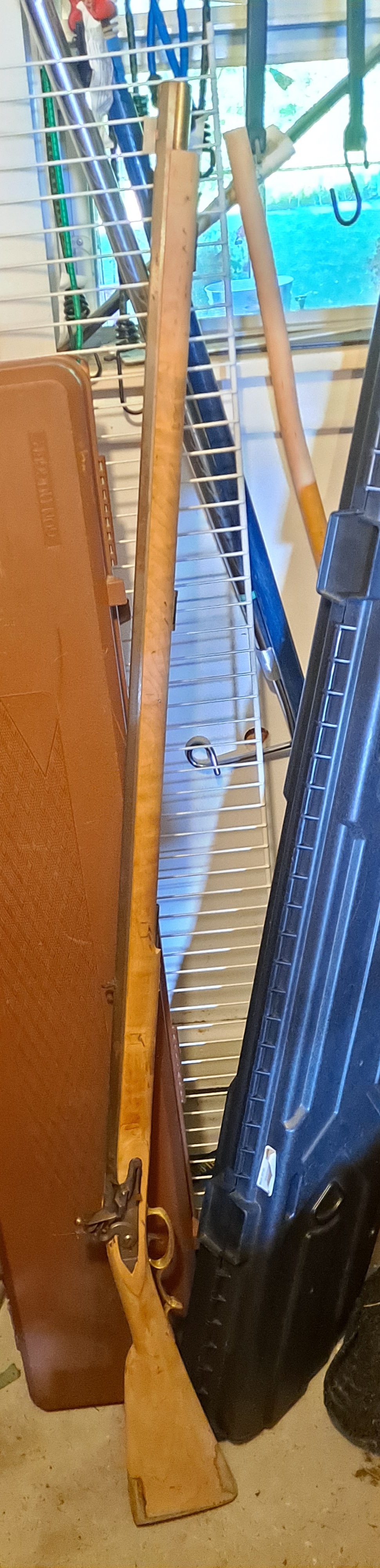

Got ya... you thought AR. I bet lol. It's about 3/4 done. Got everything inlaid and the stock rough shaped. patterned after prerevolutuonary long rifles in .54.

Lol not to worry. The walnut will be stained and oiled and the steel browned.
The brass will be polished, kinda.. this is meant to be a working longhunters rifle.

It was a stock blank and parts. The stock was rough formed but no inletting. And it is the last time I would do it this way, it is so much harder and time consuming than I thought it would be. It's roughly been 4 years to this point.
By using just pieces bought here and there from different sources I made a few mistakes. The barrel is, I think, a touch too long, which I did not notice until I saw how the nosecap I picked looks in place. And I believe the trigger guard is not quite period correct.
I would recommend Track of the Wolf rifle kits for an easier, still a ton for you to do, and better fitted parts experience. They are inletted, but not to 100 percent in some areas so it takes fitting work.
