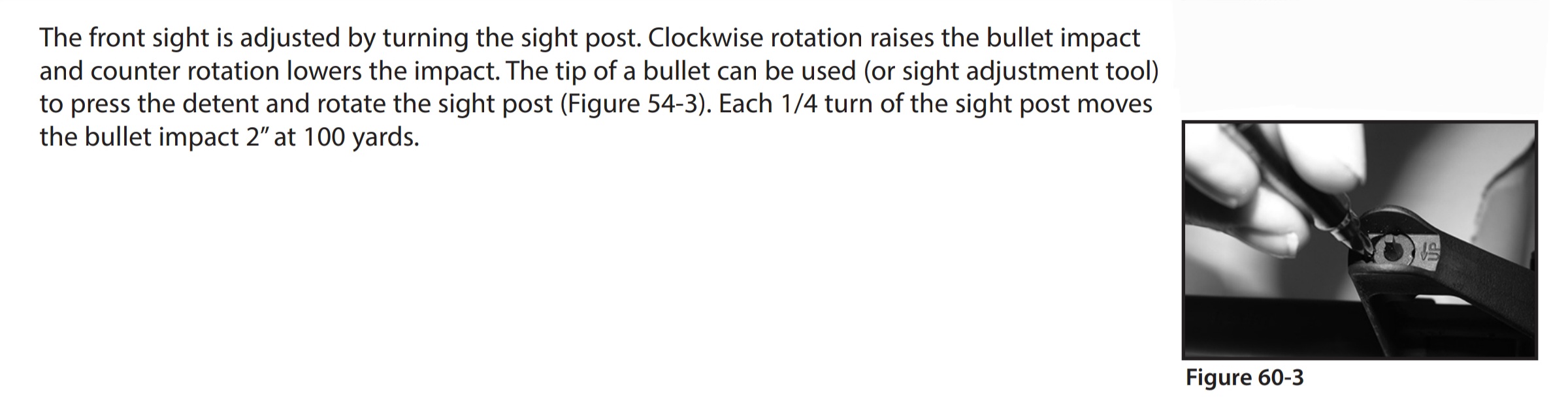

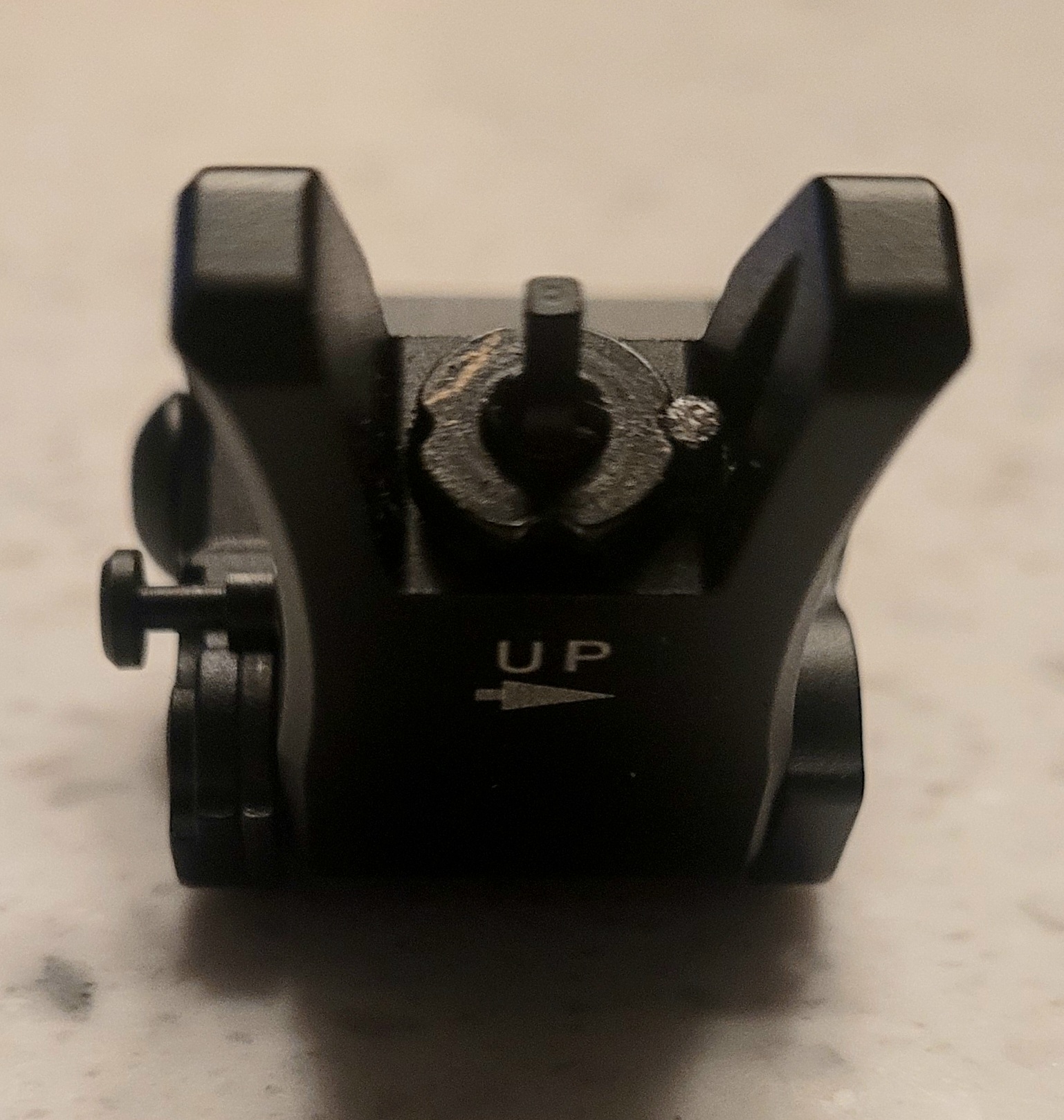

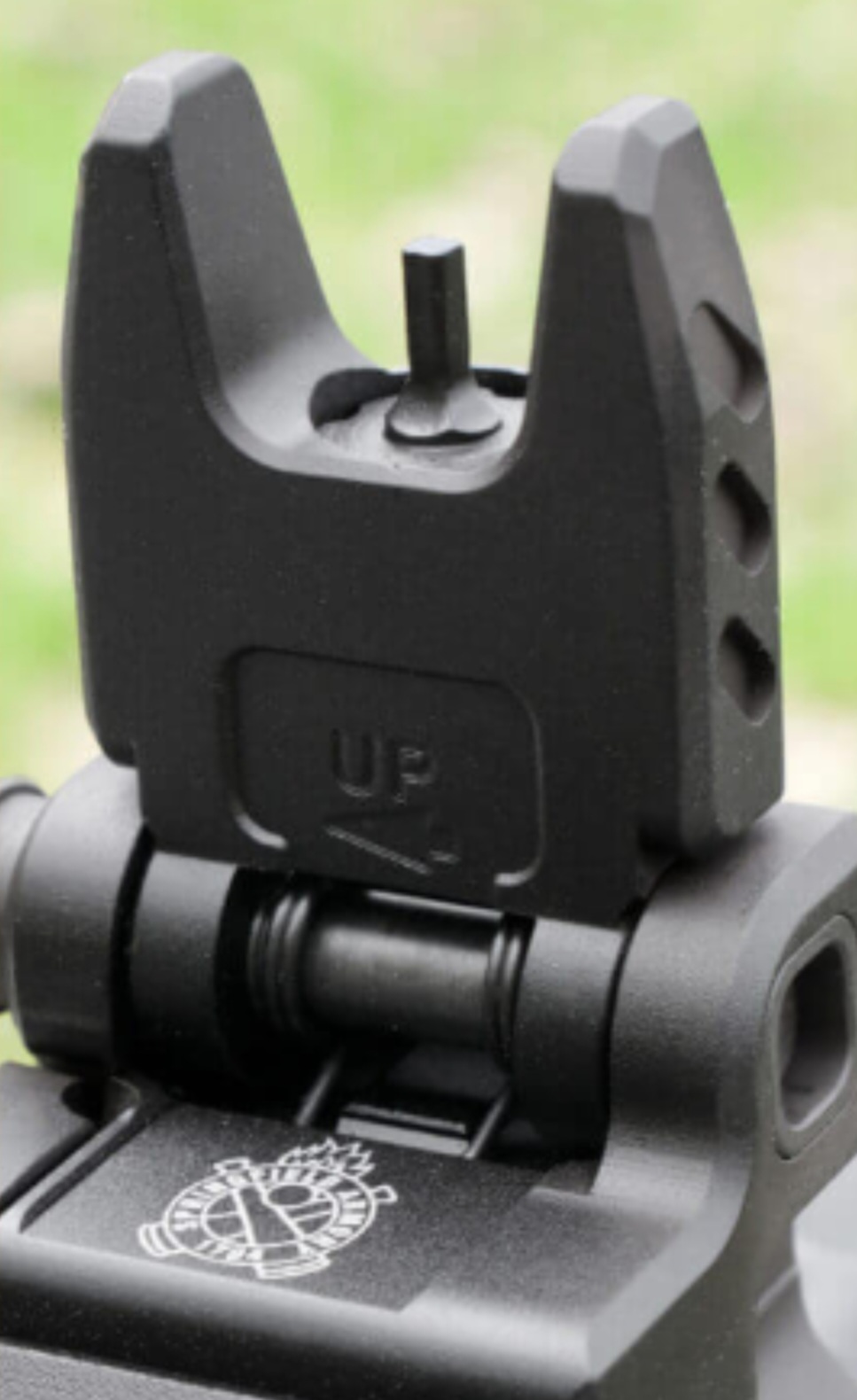

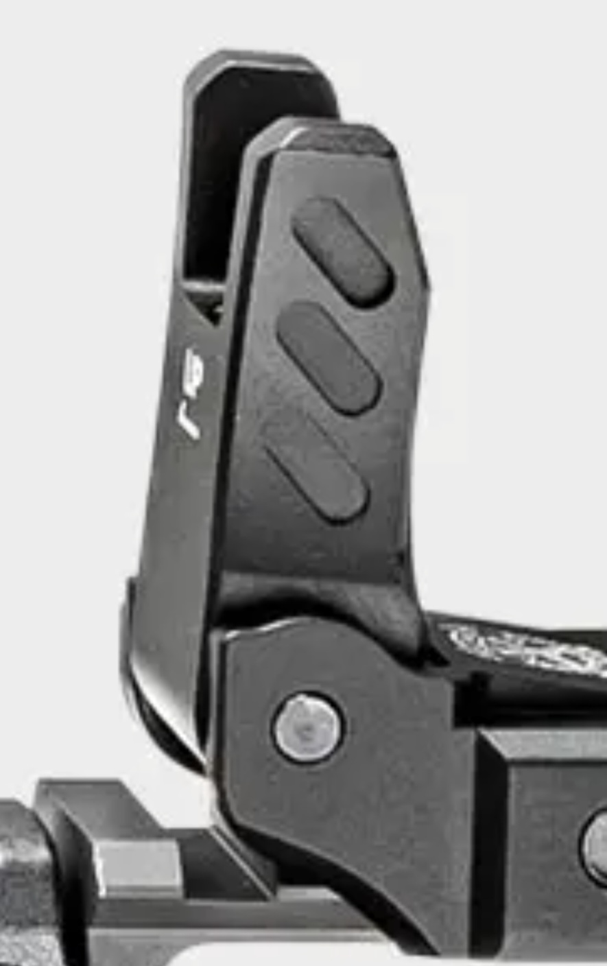

Manual directions and online photos all show these sights marked left/up (see pics 1-3), yet mine (see pic 4) is marked right/up, which when rotated right (counter clockwise) then rounds (hits/impacts) go lower?
Am I loosing it? Really thinking they farmed these out to a sub mfg and they blew it...

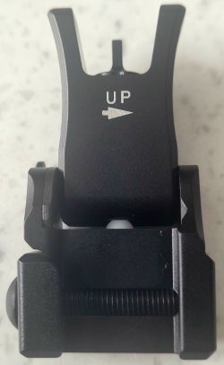

My arrow points to the right, 4th (last) pic, viewed from the rear. SA or their OEM apprears to have marked these wrong or non-standard...

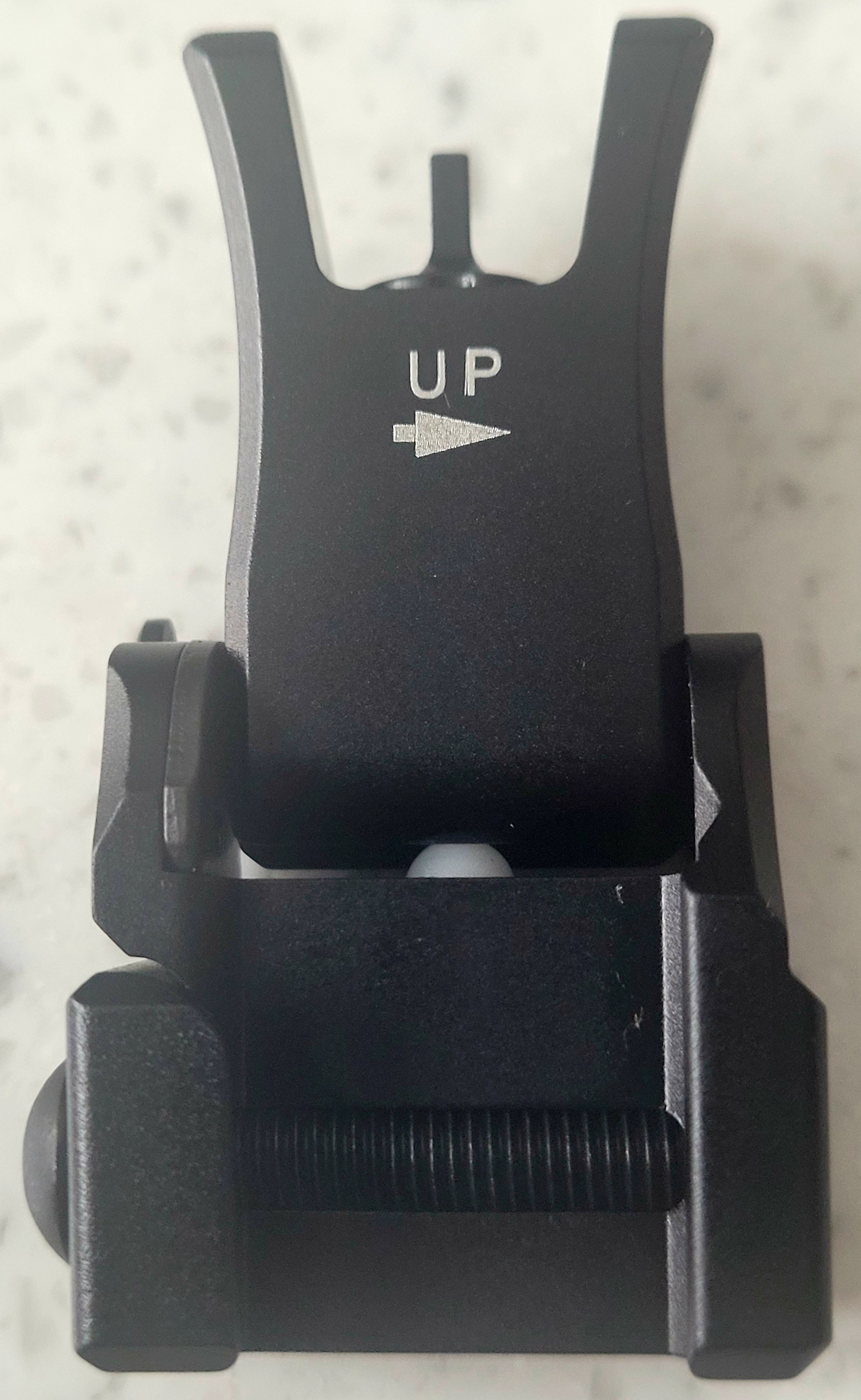

Wow, was so happy Springfield had no problem sending me a new front sight, appeared they understood my problem. Unfortunately, sent me a sight with the same backwards arrow. It was flush upon receipt, as you can see in the pics, 1 full rotation applied, you can note the post definitely moved up, unfortunately this will moves the round down...
DUH! Sometimes ya just gotta stand back and shake your head in disbelief.
