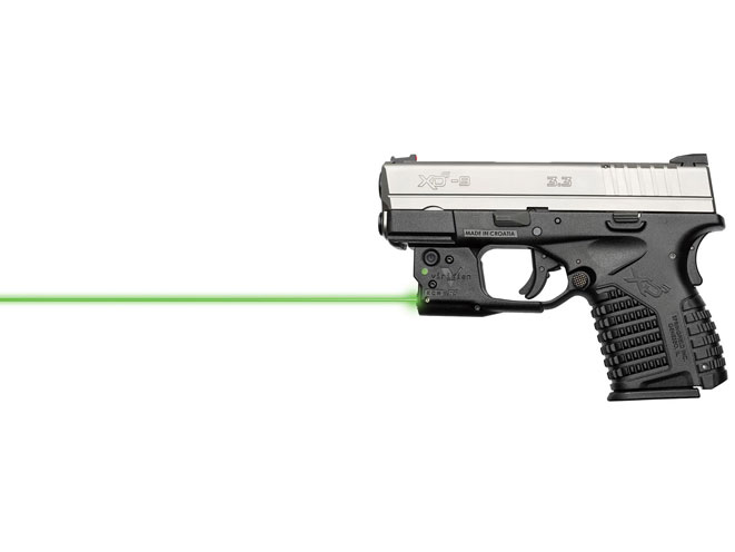

Or just get a laser, then in the heat of the moment you don't even need sight picture. Place dot on target, pull trigger.
Reactor5 series - magnetic holster, no button-push required, it lights automatically when you draw. By the time the muzzle clears the kydex, it's lit.
