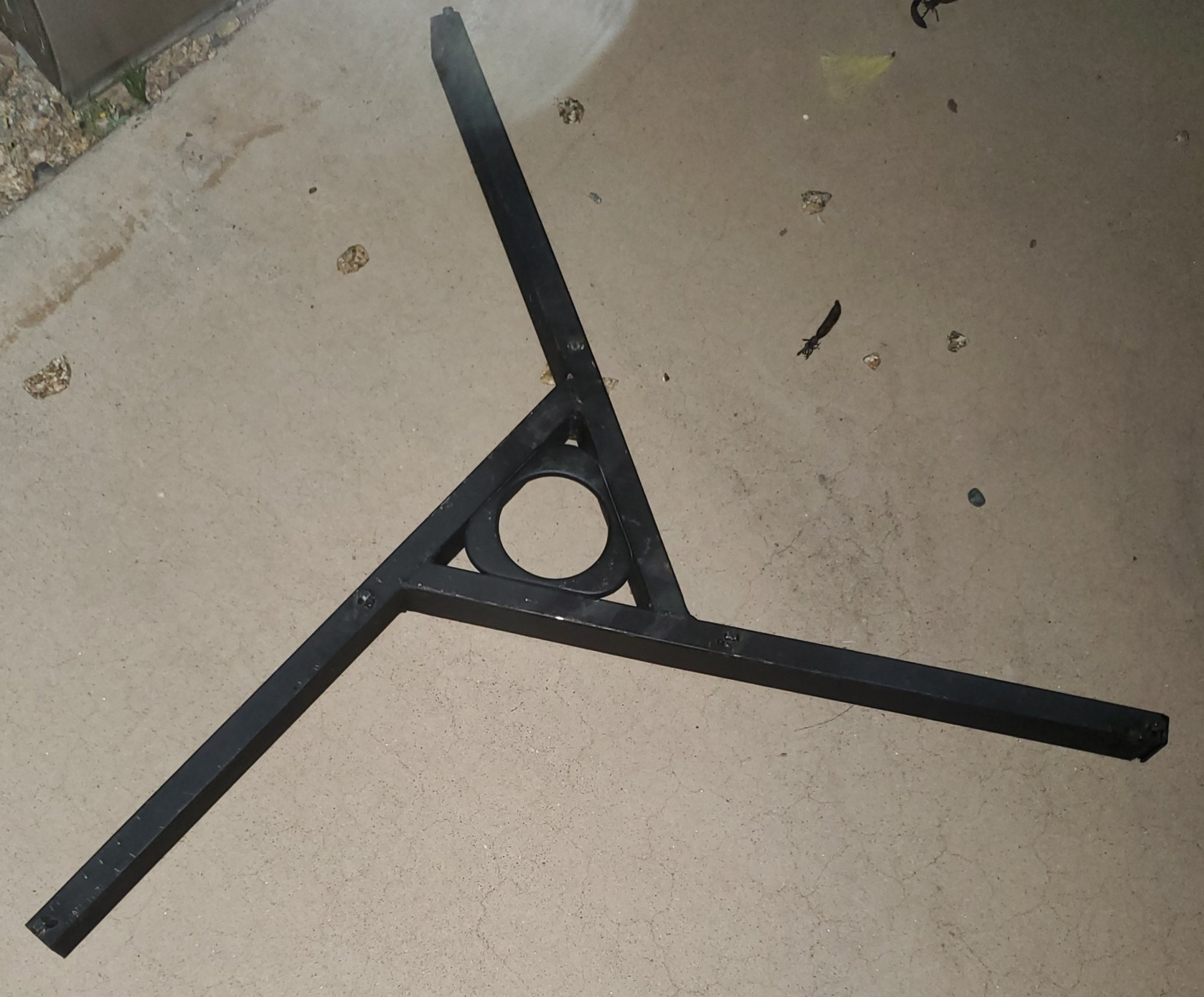

I have made something some what along the same lines. Three 26x1x2 tube steel welded to a garbage disposal flange, using the angle set the flange weld iron to the flange like a pin wheel. Then some nuts at the far out side ends and half way in. Now that the base is done spray it with bedliner and use a section of chicken wire in a loop as the upright portion. Attach the wire with zipties. This works for paper, cardboard, balloons or just tape targets. The wire itself is very resilient and easily replaceable.
The set up does great against wind as it can weighed down in the center or anchored with a ground auger.
It breaks down fast and is easily stowed.

I have made something some what along the same lines. Three 18x1x2 tube steel welded to a garbage disposal flange, using the angle set the flange weld iron to the flange like a pin wheel. Then some nuts at the far out side ends and half way in. Now that the base is done spray it with bedliner and use a section of chicken wire in a loop as the upright portion. Attach the wire with zipties. This works for paper, cardboard, balloons or just tape targets. The wire itself is very resilient and easily replaceable.

Here's a pic
