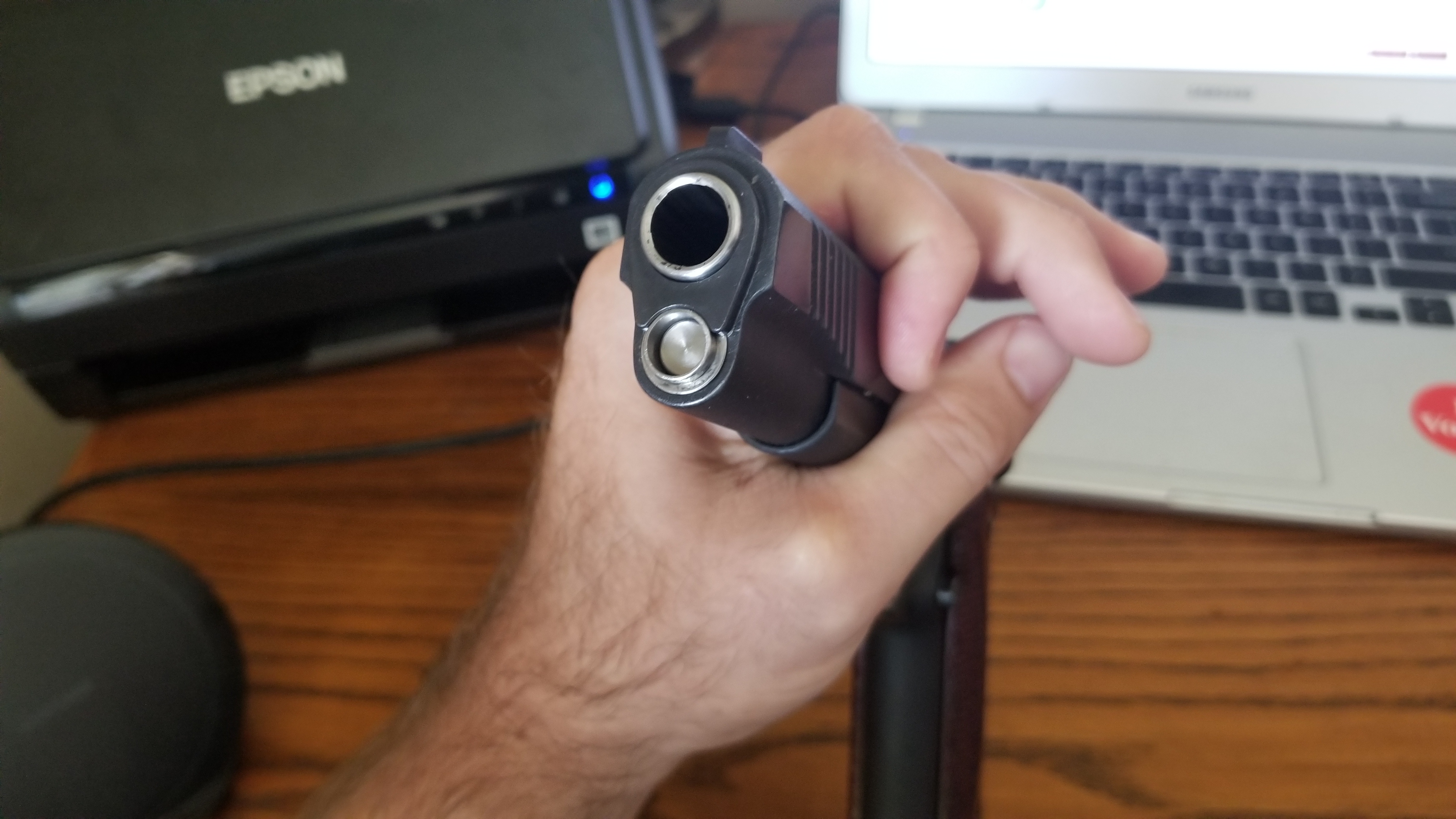

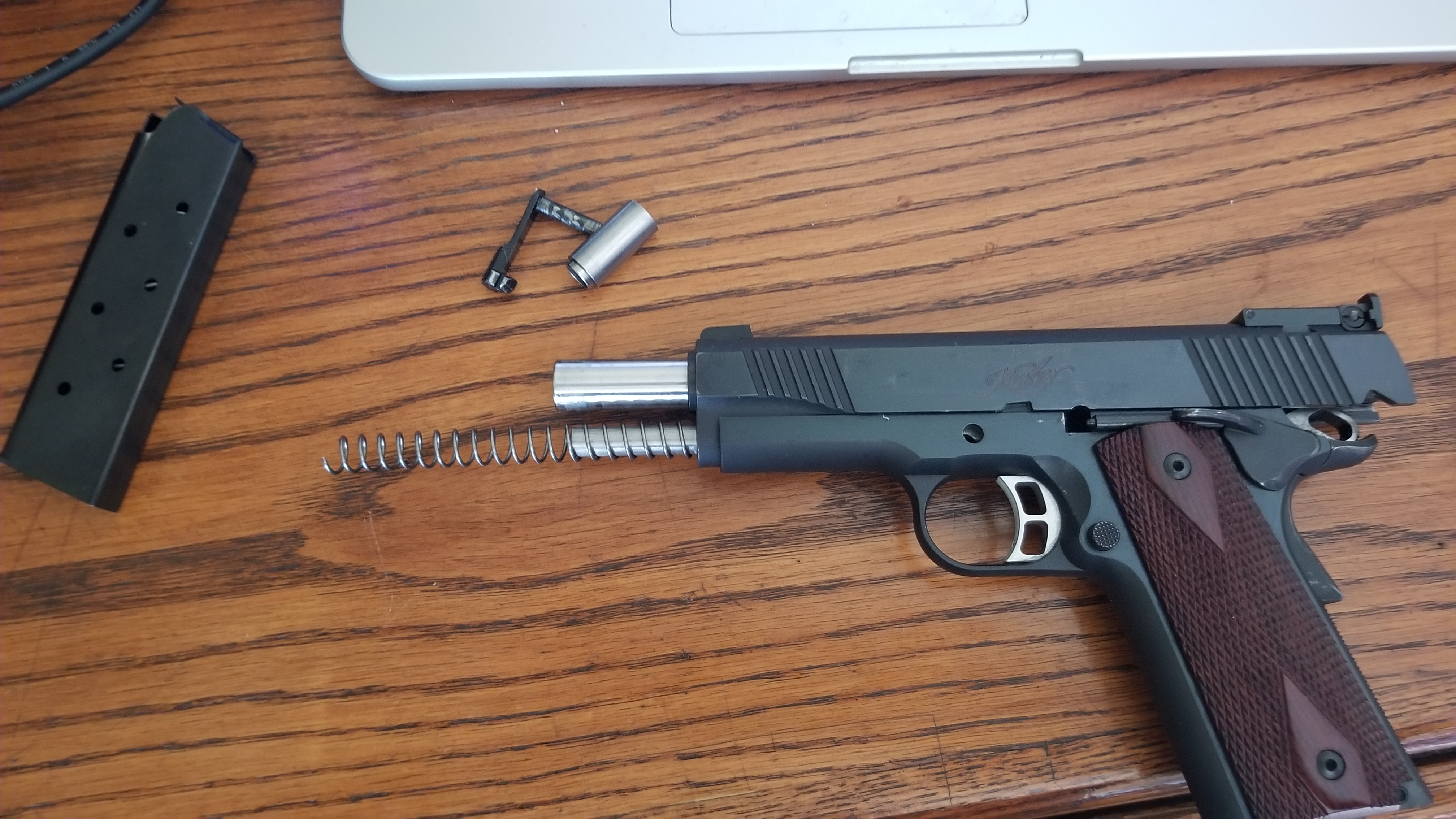

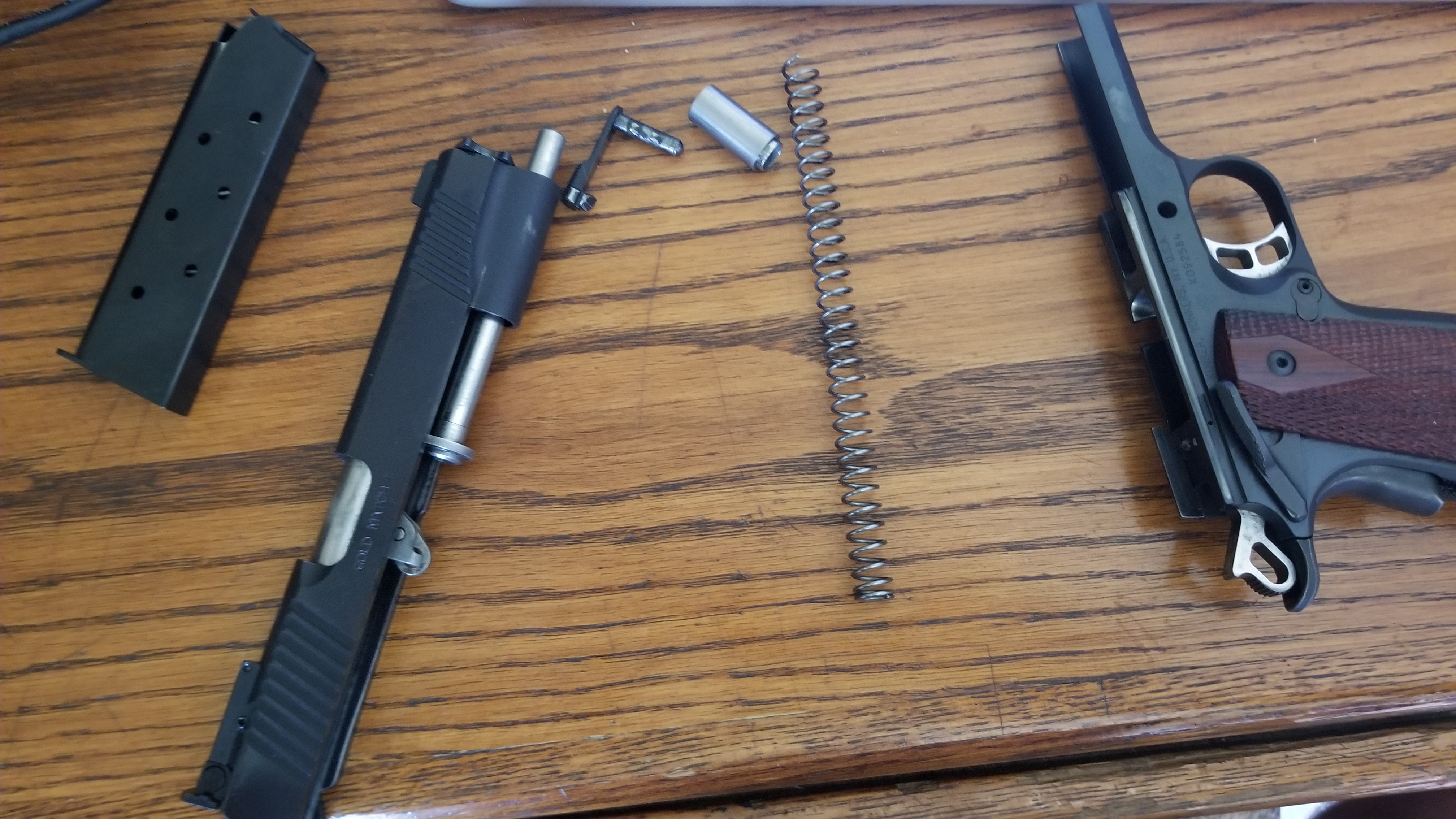

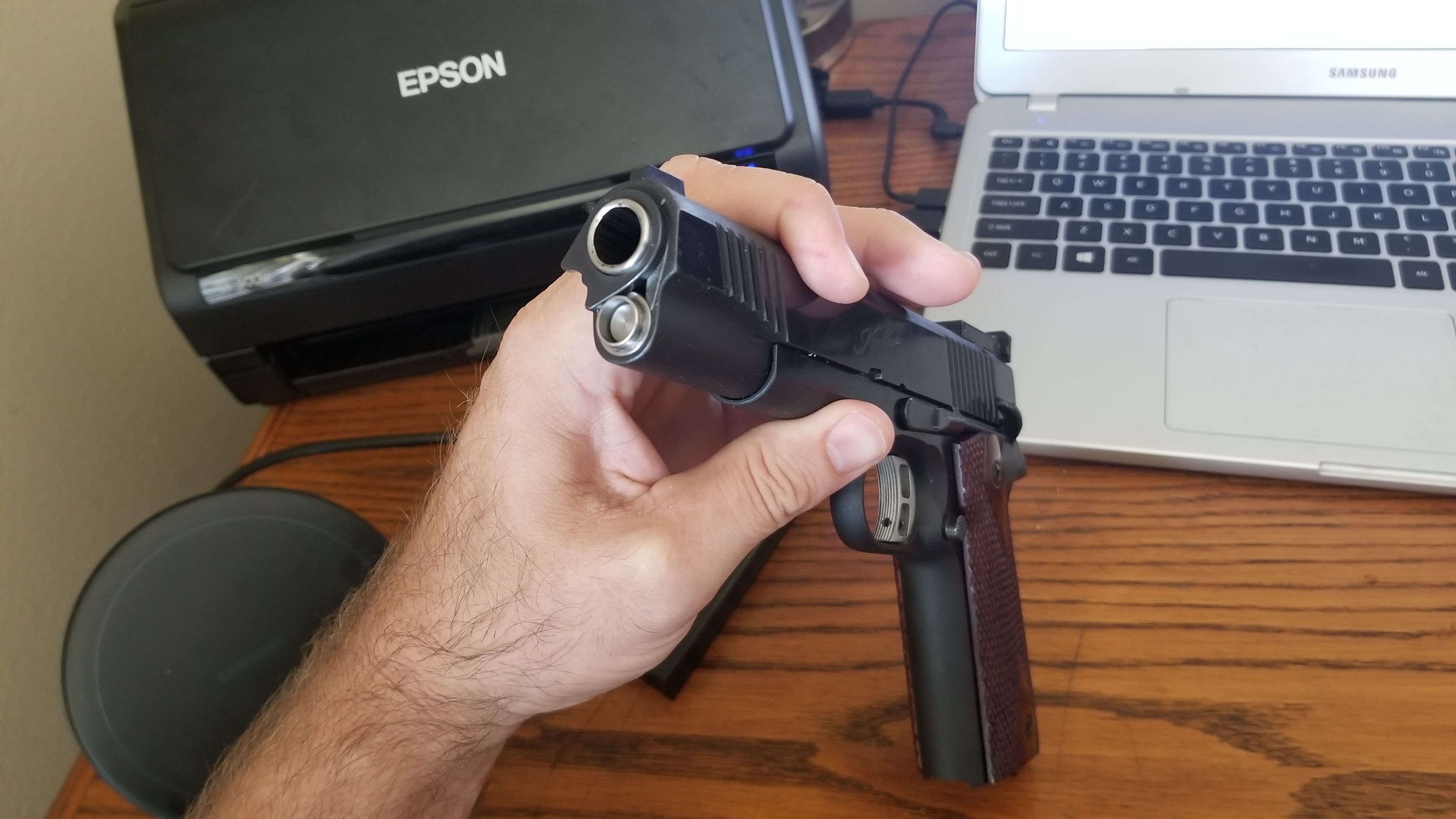

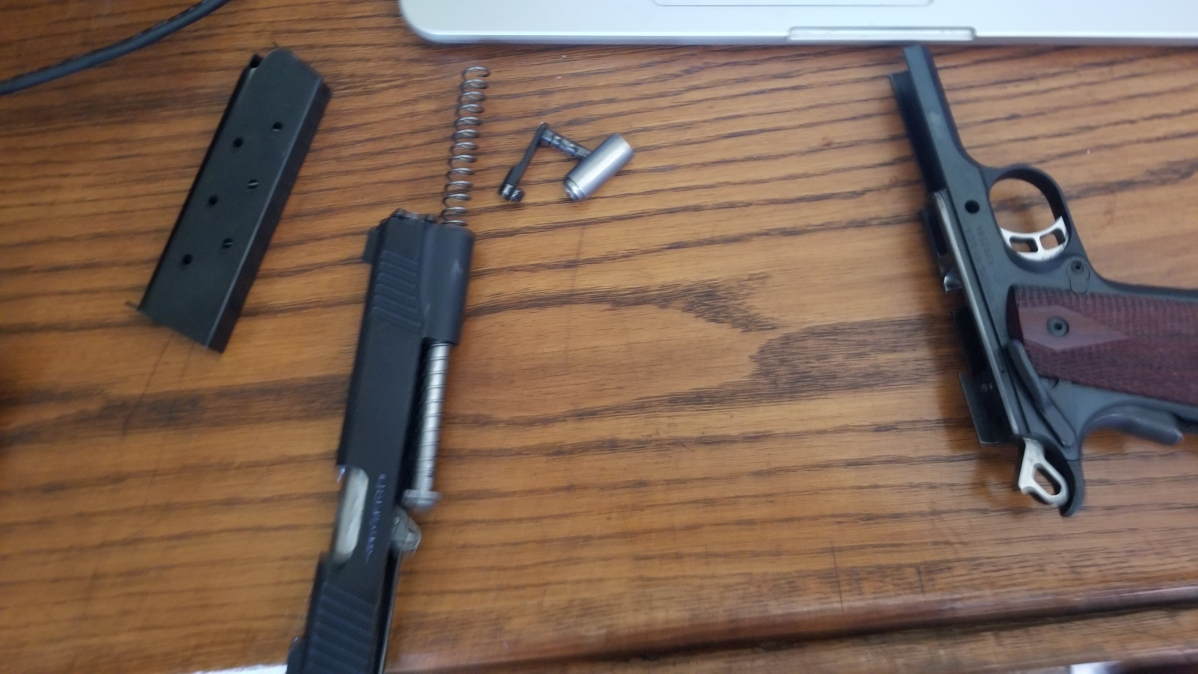

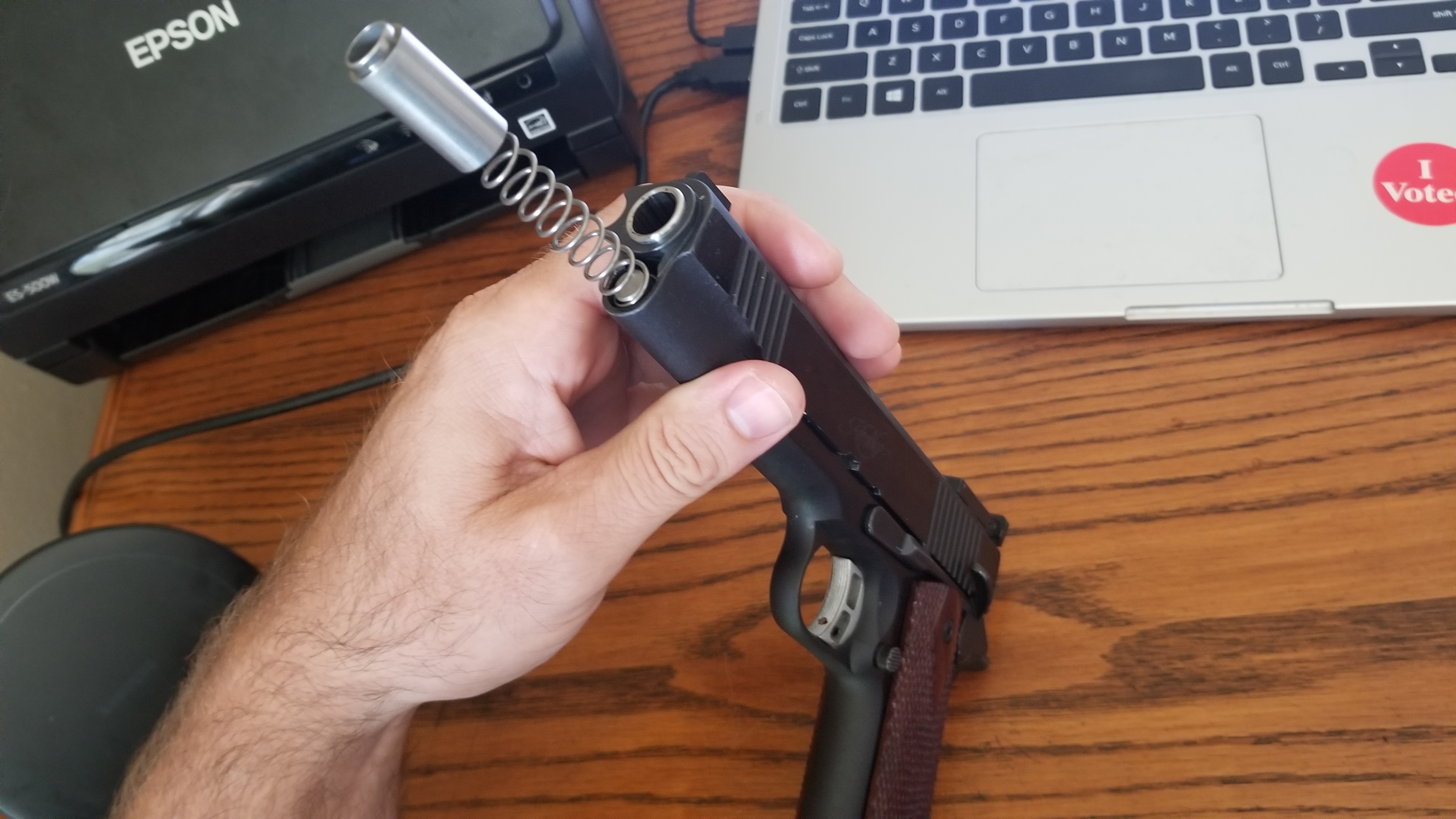

I don't know if it helps you any but I also have a 1911 with a full length guide rod. I snapped some pics of how I reassemble. Hopefully they are in order.
