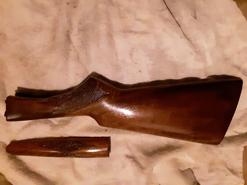

This pic found before final finish with 0000 steel wool of stock/forearm for refinished Ranger double barrel 12 Ga. shotgun with needle file and pick. Lot better than was. Checkering tools would've been much better/easier.

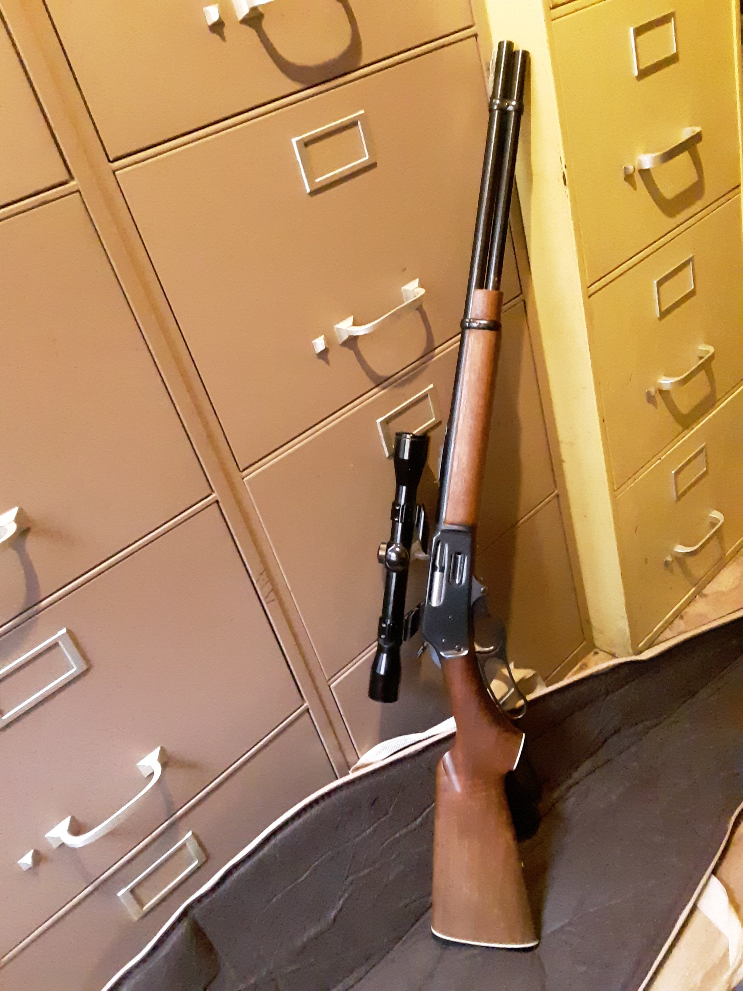

Looks good !!! (y) (y) (y) "Ya done good son, ya' done real good".!!!
Thanks JJ,
It's been awhile since doing those.
Just used available off the shelf products at the time for bluing and woodworking. Refinishing products change from time to time around here. Just read all directions is about it. Usually use marine spar varnish or urethane as top coats on wood, there are sometimes many coats. Sanding, then steel wool in between on almost all. Nice when done, nasty until then. Cold bluing's nasty smelly stinky stuff. Do outdoors when can....Do not want to say what spouse said about stench. "Whew, what died out here?" was some of many of calmer spoken words the 1st time. :)
