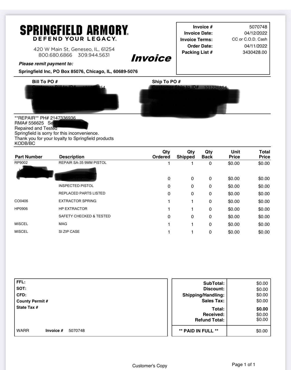

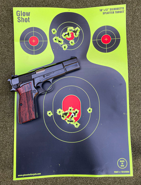

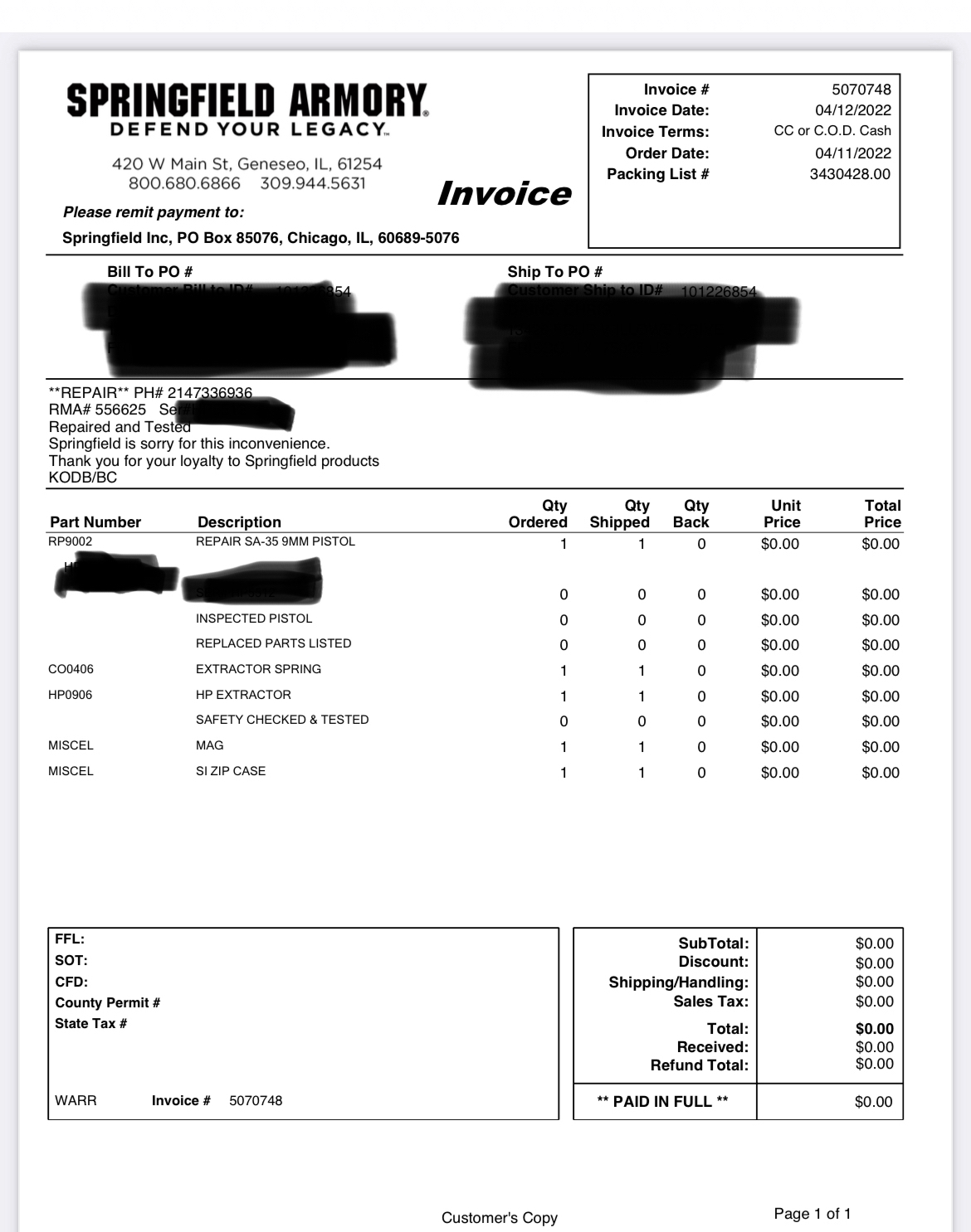

My SA-35 went back to the factory because it was experiencing 3-5 failures to extract per magazine. The repair notes indicated that the extractor spring had been replaced. I took it to the range today, and the results were disappointing.
The SA-35 is no longer experiencing 3-5 FTE's per magazine. Unfortunately, in 7 magazines (105 total rounds fired) the SA-35 had 5 FTE's. The individual breakdown was: Mag 1 = 0 FTE; Mag 2: = 1 FTE, Mag 3 = 2 FTE; Mag 4 = 1 FTE; Mag 5 = 0 FTE; Mag 6 = 1 FTE; and Mag 7 = 0 FTE. While this is a considerable improvement in performance, 1 failure per every 21 rounds fired is not an acceptable ratio for a new gun from a respected manufacturer.
All of my magazines are new 15-round SA-35 magazines purchased directly from Springfield's website. I have rotated the magazines throughout my ownership of the pistol, and I have no reason to believe that the FTE's are due to any faulty mags.
I am open to advice about how to proceed. The gun has approximately 350 total rounds through it, but only 105 with the new extractor. Could today's FTE's be normal break-in issues? I am a dedicated Springfield fan, but I am concerned that multiple other companies have produced Browning Hi-Power designs for over 70 years without significant extractor issues before Springfield introduced the SA-35. Considering the current price of ammo I'm hesitant to go through 500 rounds in the hopes of the issue correcting itself. Should I send the pistol back to Springfield again, or give it a few more sessions?

The BHSS evaluations found that the extractor channel in the slide was incorrectly machined resulting in the slide serrations machined across that area producing burrs in the channel which interferred with the extractor function.
If SA didn't double-check that area then that was an over-sight.
Plus the BHSS evaluations found that the SA extractor had a smaller sized claw (that grabs on to the case rim) than the standard/original BHP extractor.
When BHSS replaced the extractor & cleaned up the channel area FTE's went away.

I got my SA-35 back from BHSS and am thoroughly satisfied with the results. I took mine to the range last week and and put 12 mags through it. The mags, SA and Browning, were fully loaded and no issues were encountered.
