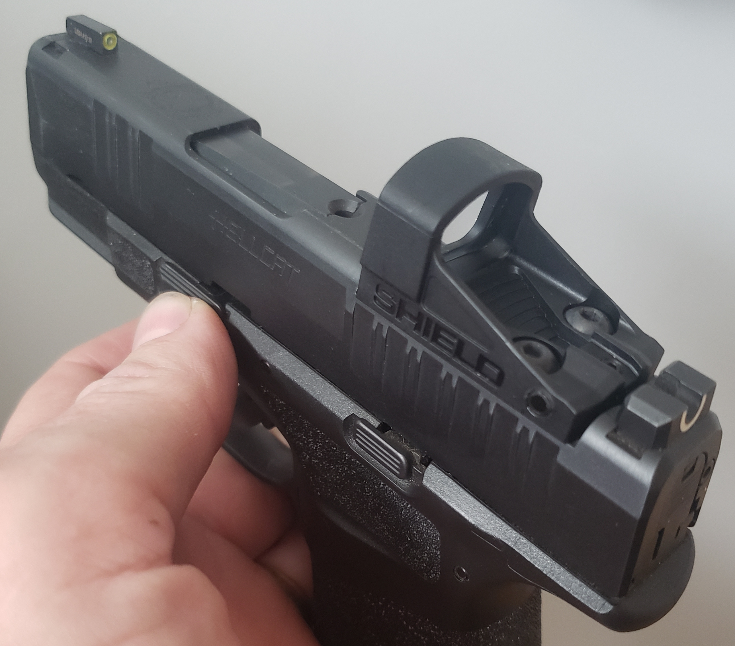

I mounted the Shield on the gun and it fit nearly perfectly aligned without touching it, and the best part, you can see the full sight picture with the SMSc sight just like they said it should be identical when the replied to the original email.
Here are a few pictures of the Shield SMSc.
Right away, I noticed a few things that were much better in my engineering opinion.
  1. The screws are nice large button head type screw to apply the pressure over a much larger area than the SIG flat head screw that is countersunk into the plastic body. (Don't over tighten, or you may break the plastic on the SIG)
  2. Wider sight picture with the Shield
  3. Cleaner from a construction perspective. (The original Romeo Zero has some haziness around the permimiter due to adhesive) To be fair, the replacement looks much cleaner, but I didn't want to open the new package and put it straight onto eBay to recoupe my money on that one.
Hands down, I would go onto the Shield website and buy the this one over the RZ today and get it for much less than you can buy the RZ on eBay. My total for the two came to about $275 each direct from Shield. Worked out great with the exchange rate and less than the advertised prices the dealers have them listed for with back orders.
Hope this helps a few others with the Hellcat.
