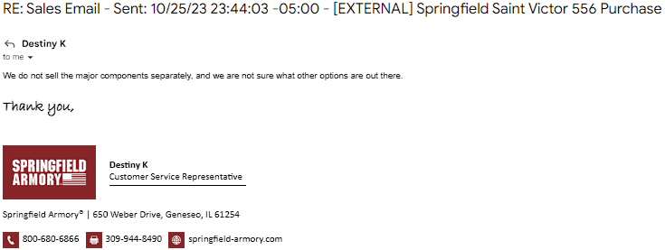

This seems to be a brainfart. Can someone tell me where I can find a verified handguard replacement w/ picatinny on the 12 'o' clock for the SA Saint Victor.
It changes between what SA can install? It could have a bcm barrel nut of 2 varieties or something else? Just going off past post about SA products. Maybe a pic of the handguard's attachment could help and/or a pic without the handguard for best answer.

Probably the service reps at Springfield would the place to find your answers.
I should have suggested him first because he knows his stuff and has come to the rescue of many!

Thanks for the insight. I saw/read the info on the Aero website. I would think that there was someone out there who may have done exactly the same thing.
