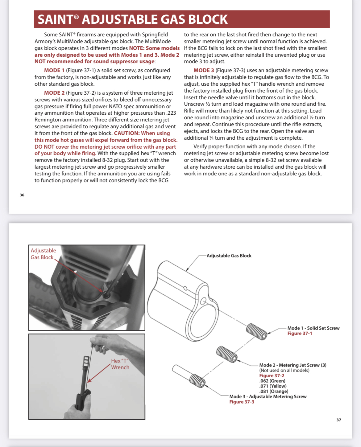

I have the springfield Saint Edge, calibered in 5.56. I have tried to change out the gas plugs, and differnt ammo, and It is still over gassy compared to my friends Gissele super duty, whenever im range shooting I cant rapid fire more than 3 or 4 rounds before I get a face full. How can I correct this? Ive heard about replacung the charging handle with a unit with an O-ring but Ive heard mixed reviews and dont want to spend over $150 for it not to work.
Any suggestion?

So your saying you adjusted the gas plugs and or tweaked the gas settings per the manual and had no change at all ?

Its has the original muzzle brake that came with the rifle, no upgrades or modofications outside of the red dot, magnifier, and light. There is a signifigant difference in the gas blow back and the recoil, the Gissele is just a smoother shooting rifle, I can tell the difference in build quality, in my opinion, not saying that I dont love my saint.....I just dont love the gas.
