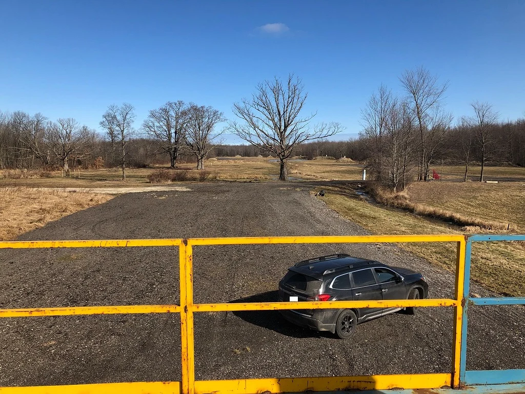

^ It really was. It was a nice afternoon with my bestest shooting buddy, at the new private range where I'm a member. :)
Contact to 1,300. I don't have the hardware to reach out that far, though! 😅
This is off the 12 ft. tower. My dirty Subaru below.
