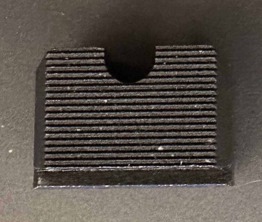

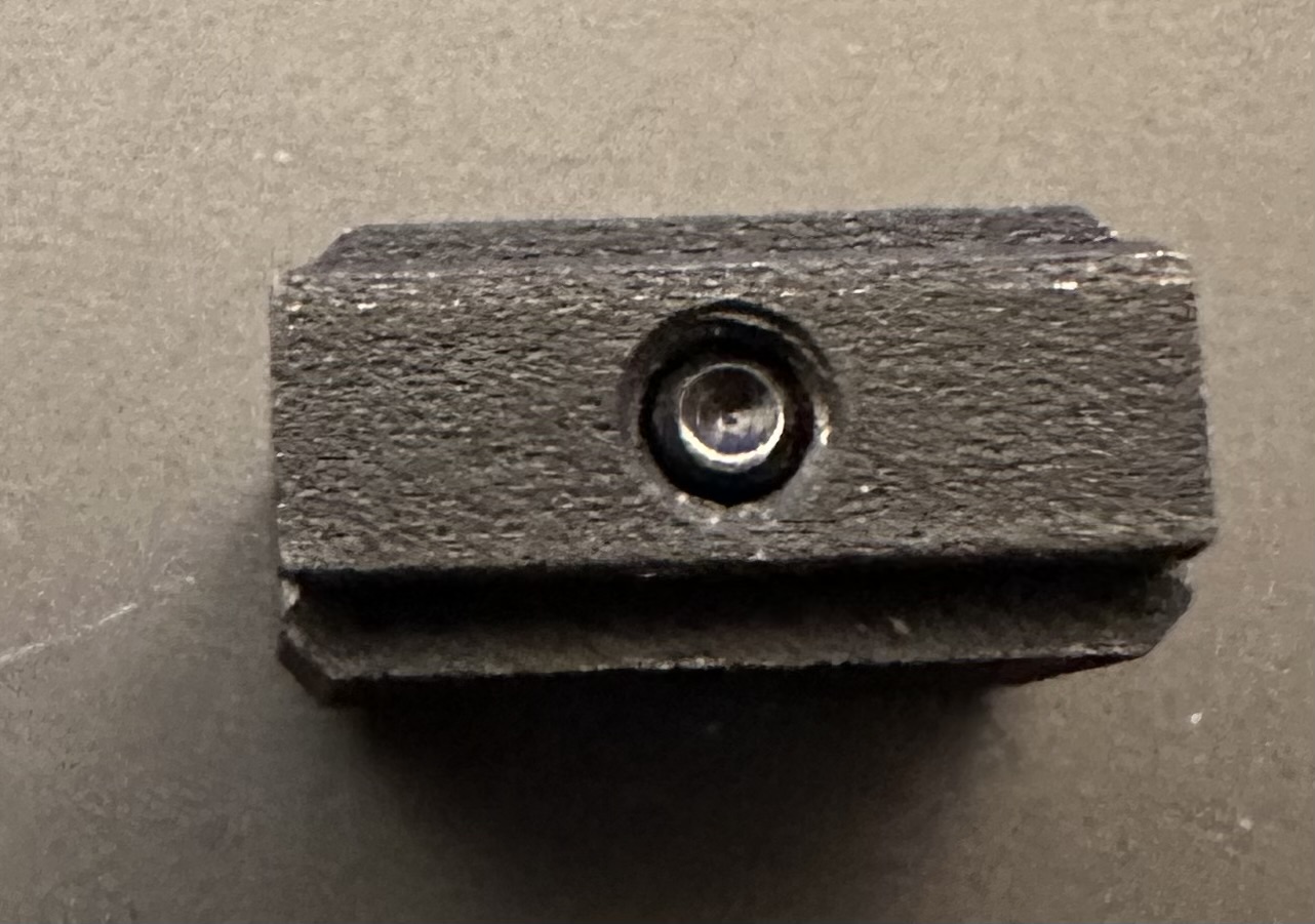

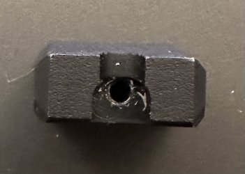

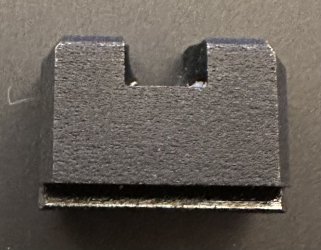

Upon further examination it seems that the screw had broken off the sight and some of the screw remains in the bottom of the sight, flush with the bottom making it impossible to grab with a pair of pliers. (see pics). Also, there isn't a screw hole on the A14B plate for the sight screw to screw into. Whats up with that? Anyone have a picture of the bottom of their A14B plate?
if there isn't any screw hole in the plate, that that broken screw was only a "lock screw', that just tightens to the plate.
i have several sights that have screws like that, that just lock the sight into place.
loosen it a bit, slide the sight, to zero it, lock it down.

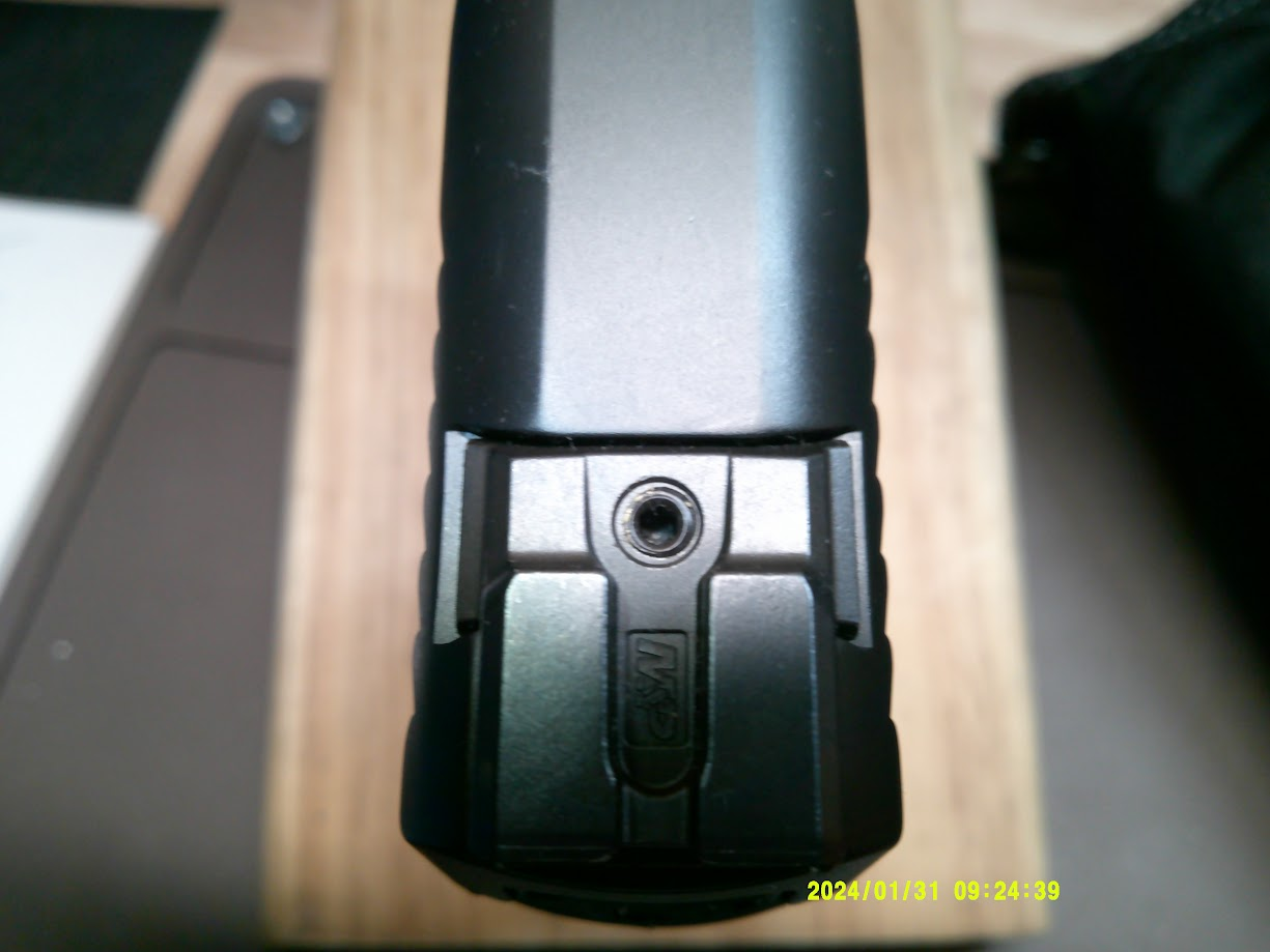

the very first gun i pull from my cabinet, my S&W MP 45.
lock screw..
lock screw..
lock screw..
I wish I could loosen that screw. There isn't anything to grab to screw on the bottom.
the sight is already off the gun..??
if so, toss it, and get another.
too much time to drill out, retap, or to get an extractor, the drill thru the broken screw...
