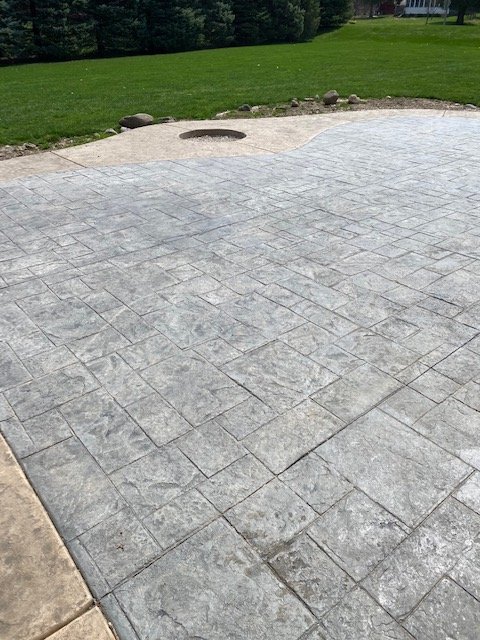

Any input welcome. 2 years ago I hired a guy (based on a couple recommendations) to install a 900 square foot, shaped, colored, antiqued, stamped concrete back-yard patio to replace an old rotted deck. Looks great, enjoy it a lot, but I know I'll need to seal it again soon. I know you can't apply solvent-based sealers over water-based. I have no idea what the guy installed, and he may be out of business...he does not return calls or e-mails. I just want to know if he used solvent or water-based sealer. I tested a small amount of solvent sealer and it did NOT absorb at all...which leads me to believe he may have used water-based. Does anyone know how to test for what was applied? Is it as simple as getting a small amount of water-based sealer, try it on a test spot, and go from there? Is it maybe the antiquing coloring that prevents a sealer from absorbing?

Thanks for the reply, lots of info...my patio is a slab of stamped concrete. Attached is a pic. After significant time spent online researching...I came up with bupkis on determining what kind of sealer may be on it, I'll have to talk to someone. Can't turn over a paver...don't have any.
Solvent sealers can NOT be applied on top of water-based. The water-based sealer must be chemically stripped before a solvent sealer can be applied...that's one thing I can verify by the manufacturer of a sealer I am looking at (Foundation Armor AR350), as well as a number of sources on the inter webs.

If in doubt, strip it! It will cost you a bit more, and take a little longer but you are then starting from scratch and you have the choice of whatever product best suits your needs without having to worry about unintended consequences if you're wrong.

Depends on your sealer. I applied the first coat of sealer to my stamped patio this fall, couldn't get the 2nd coat on due to work and/or rain (and eventually cold temps). Whether the gray color goes away depends on the type of sealer you chose I think. I used Foundation Armor AR350 Solvent-Based Acrylic....it looks wet whether it's wet or dry, which is what we wanted. It turned out fantastic, btw. I do not know if water-based sealers can look wet when dry. I also don't know about "gloss" for a sealer description....plenty of sealers have a "dry" look or a "wet" look...I would assume "gloss" means a "wet" look.
In short, I think a wet-look sealer will eliminate the haze. No idea about a dry-look sealant. Either way, holy crap is this stuff expensive ($250/5gal...needed 10gal). At least it only needs recovering every 4-5 years.
