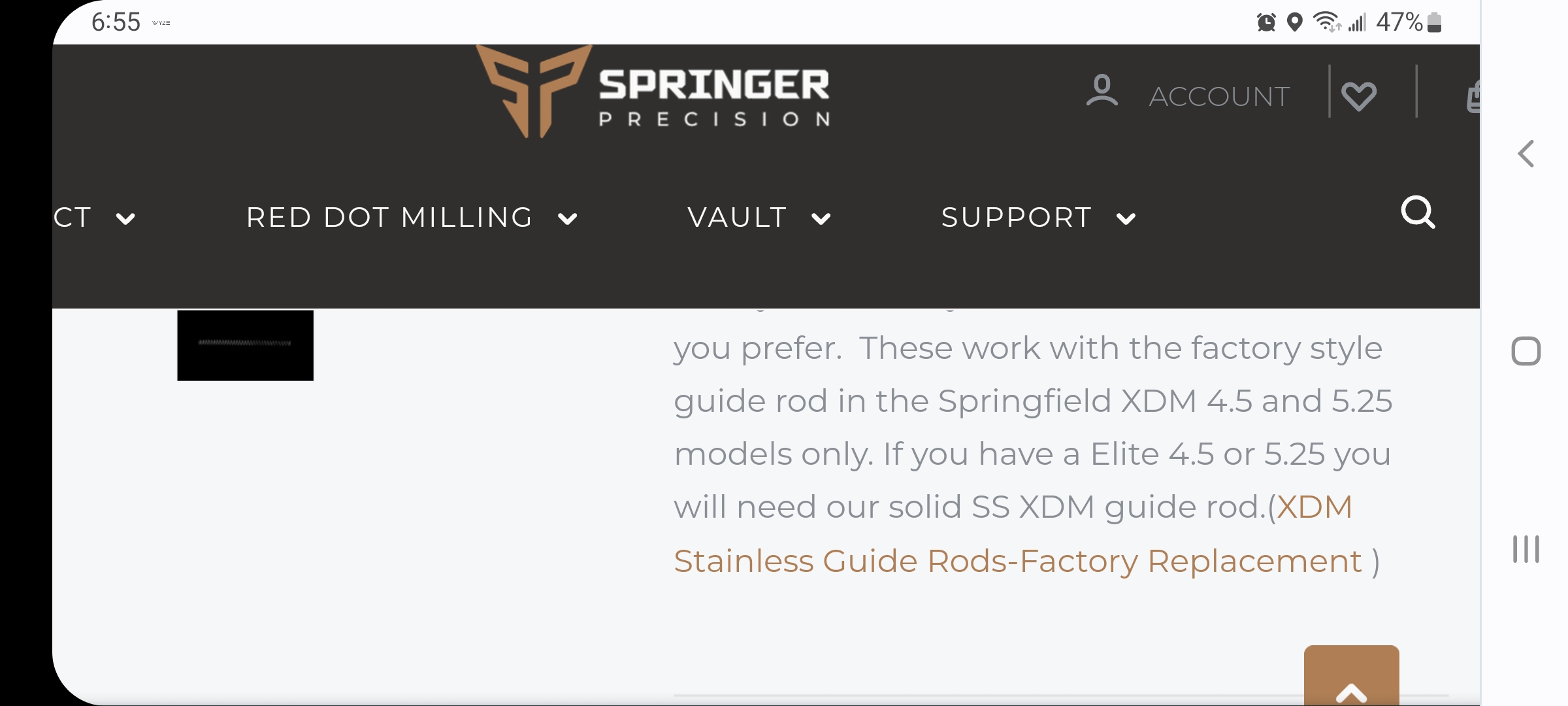

Found the answer. Springer says their springs work with the factory XDM rod, but not the XDME rod. Wolff doesn't mention the XDME at all, and they must not plan on replying to my email from August 2nd.
I don't know why Springer is saying that since there's no difference between a pre-Elite XDm and an XDm-Elite recoil spring assembly.
The XDm-Elite is a slightly upgraded XDm. The only differences between the two are a couple extra features.
My XDm 5.25 10mm has a OEM captive unit, and the newer XDm-Elite 4.5 has the same frame except for the new Elite features.
Since you have the spring pack, just order a aftermarket guide rod to use them & use the OEM for a back-up.
