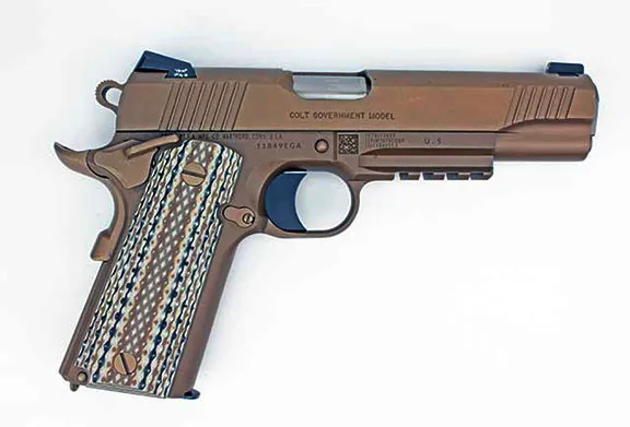

It’s not unusual for a new 1911 owner to struggle with the disassembly and reassembly required to clean the firearm correctly.
How to Easily Clean Your 1911 Pistol
The 1911 was designed for military use and can be easily maintained if you know the proper procedure for cleaning the gun.
