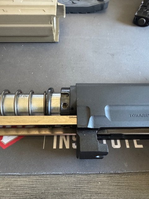

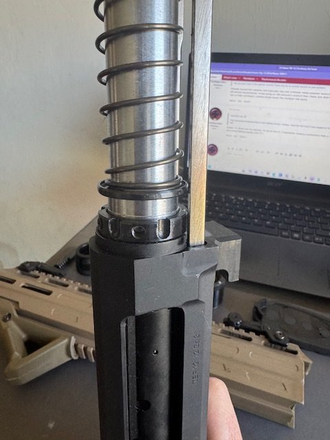

Note: I did remove the setting screws, just not for this picture. Tokarev's YouTube page had a disassembly video and claimed there was one setting screw, but there's actually two. Not sure if just a mistake on this purchase or a mistake on their part in their video.
Anyways, here's the barrel locking nut to separate the barrel from firing control group. I also thought about picking up some Mouse Milk, but posted this thread first.
Hurm.
Have you tried taking a punch (delrin if possible, or wrap some tape around a steel punch to prevent peening the nut) and giving it a firm tap?
