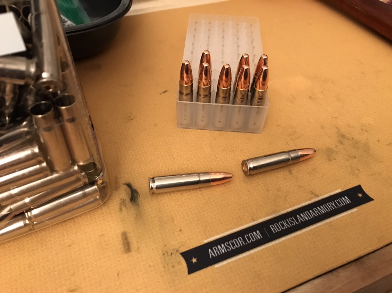

I recently completed the conversion of a decent quantity of Speer nickel plated .223 Rem from a LEO range, and thought they’d look sweet with my little bitty projectiles. I also opted to try IMR 4198 12.4gr and 12.0gr powder, as Sierra lists a number of good loads for light projectiles with this powder. In the end, these bullets sure look pretty...but that doesn’t count in a shooting range. They failed to cycle from either my PSA 8.5” barrel or my BCA 10.5” barrel. Also had some feeding issues, which I need to try again to determine whether it was a magazine or a profile issue.
While I didn’t take any pics, I also loaded 10 rounds of this same case and primer mix (Speer nickel and Sellior & Bellot Small Rifle) with the Hornady 110gr RN over 13.8gr VV N110 @1.845” (another Sierra load), and these fed, fired, cycled, and locked back both rifles. I couldn’t have been happier...so I immediately cleaned those magical cases and reloaded them, this time with 13.8gr N110, and the same primers. I finally have some Small Rifle Magnum primers, but I doubt that I’ll even try them with these light bullets.

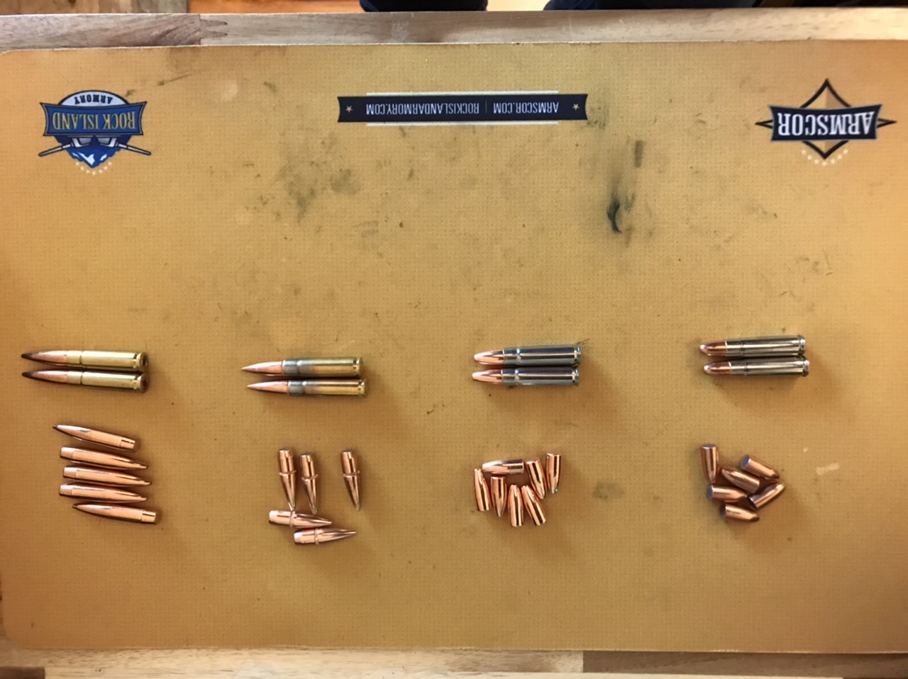

For comparison, here are a number of samples of ammo I’m planning to test at my next outing. The range of load lengths is pretty extreme, so it will truly show the versatility of the .300 AAC Blackout if all of these run my guns.
